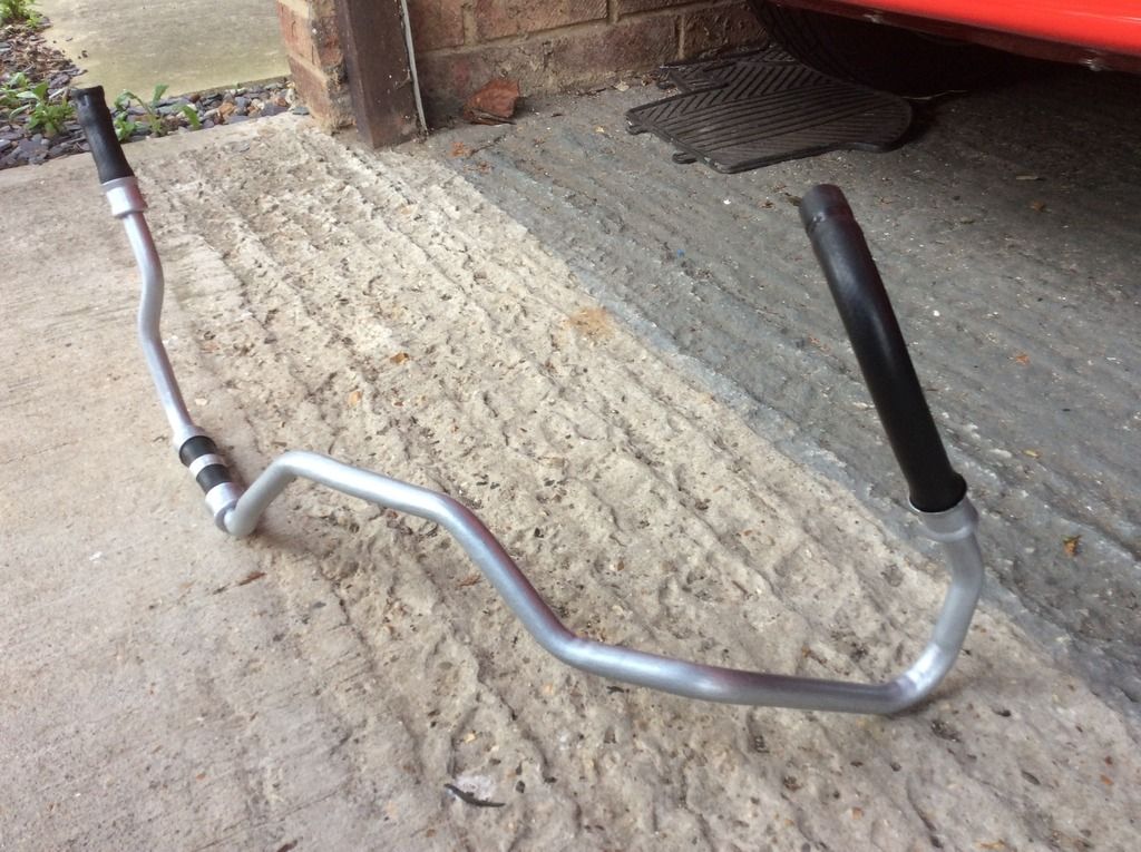

Postby Steve A » Tue 16.05.2017, 18:28
:-D Could it be the same pipework ?
It's amazing what you can achieve , half an hour getting the rust off and three coats to prevent it coming back
Posts: 1961

Postby dapinky » Tue 16.05.2017, 18:42
Good effort, Steve :bowdown:
and I bet that if you got a 'new' one which has been in storage for the last 25 years it probably wouldn't be in the same condition.
Posts: 7726

Postby alan e » Tue 16.05.2017, 18:48
No that is a new one
