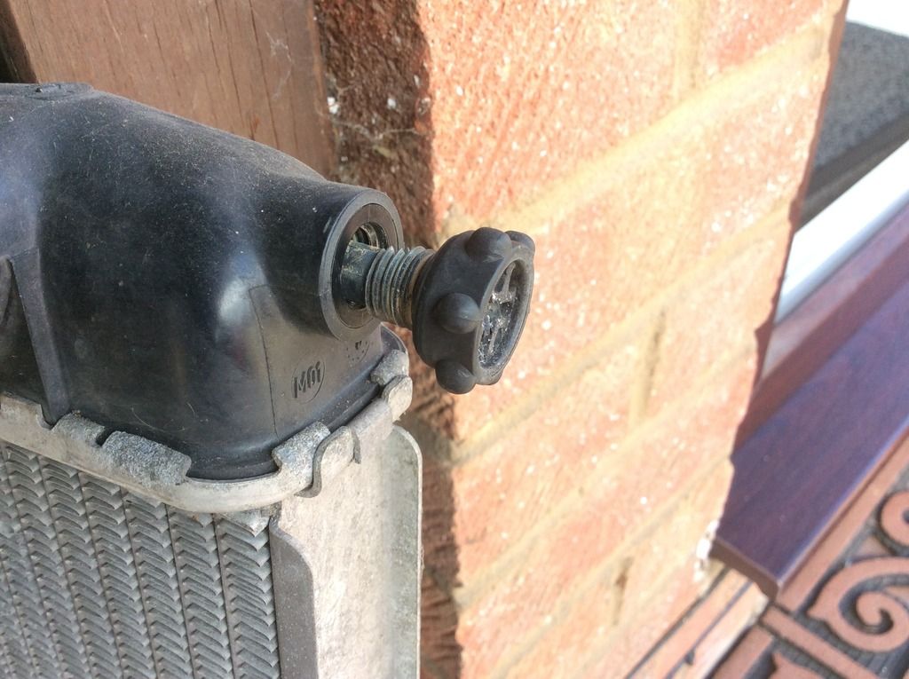

Can any one tell me what the thing is under the NS head light pod please. See photo. I recently noted it hissing after a run out and then the next day there was a small pool of coolant on the floor.

Its the rad air bleed valve you may need a new seal

It's where you bleed the coolant system, has something just become loose hence the leak :?

Thank you, that was far simpler than I expected. I'll order a new seal. is It an Allan key. Thanks for your help

This one?

Intersterstingly mine looked nothing like the photo above. Mine was a small insert about the width of a pencil. It was a struggle to remove because the head was smooth but once removed I replaced it with a bolt as a temp fix.

gmg31 wrote:Intersterstingly mine looked nothing like the photo above. Mine was a small insert about the width of a pencil. It was a struggle to remove because the head was smooth but once removed I replaced it with a bolt as a temp fix.
Sounds as though the head had snapped off.
