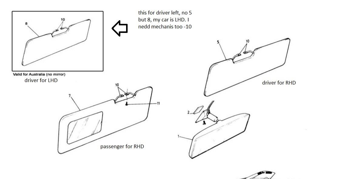

I am looking for a driver's sun visor for a left-hand drive car with the spring to mount it.

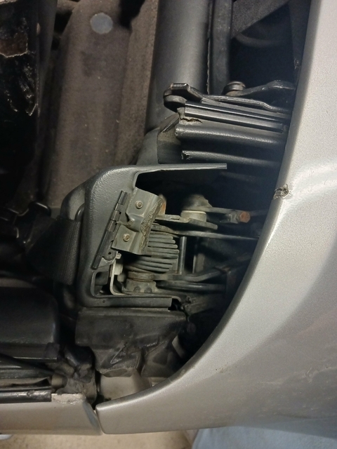

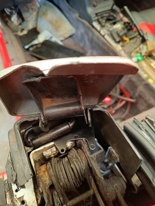

I am also looking for the 2 small parts on each side of the convertible top trunk. I also need the mechanisms to install them.
Image this is one in another car
Image this is the hole instead in my car :(

couple of months ago i was designing a 3d model for these parts.
i posted on the facebook groups and the response was... "go buy the "improved" version from SWL" so i stopped putting effort into it.
the majority of owners thinks the 92+ revision of these is an upgrade, i dont share that opinion, but needless to say. i have stopped putting my time into making parts cheaper when everyone wants to throw their money at SWL
this is as far as i got. there is still the need to make the other part where the springs lock on. im sure with a coating of rubber like grey spray it will look pretty close to original. but i was not aiming to make it original. as i believe the attachment at the back needs revision to make it work properly with springs
