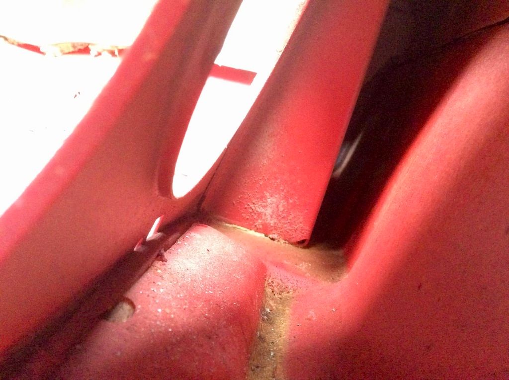

:D Well as yesterday was actually dry for once I took full advantage to check my outriggers, and as you can see I wasn't disappointed :bananasex:
All the brown stuff is just old wax thats dried out.
Very little corrosion found, when I removed the old sound deadening foam it was still damp from two weeks ago :shock: !
Front drivers jacking point
No corrosion here :D
This was the closest I found to real corrosion, still all very solid.
These were taken with my new £20 endoscope
Rear jacking point.
Taken behind the one of the rear jacking points, you can see where the car been treated in the past.
The old heavy sound deadening foam will be replaced with light closed cell foam, what little corrosion I did find will get the POR 15 treatment
and the outriggers will get a fresh waxoyling .
If you haven't checked yours yet get out there and do it and put your mind at rest :poke:

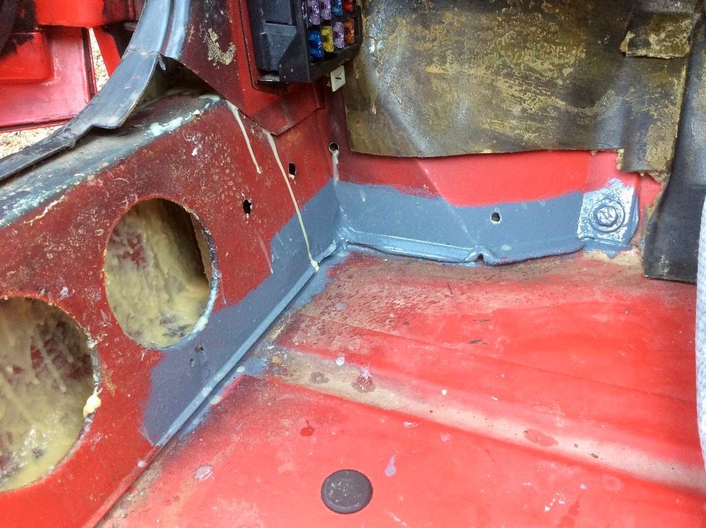

Postby Tuga2112 » Wed 23.05.2018, 23:21
I have now addressed the situation in both my cars based on the suggestions above.
for those interested. pictures in the project threads.
yellow car
blue car
I also put new soundproofing just like Neal's post. so, its another issue resolved x2 in here :-D

Re: What to do about heavy rust around the outriggers
Postby Tuga2112 » Sat 02.06.2018, 15:29
vincereynard wrote:Seal the whole area so you could carry a spare goldfish in the passenger side should you feel inclined but none would get into the inner structure.
in a extreme "goldfish scenario" you have the fusebox in that area... :lol:
what ive done and from my discussions with other owners is to drill holes in the floor and swap the sound insulation so that the water can get out without stauying long enough in an area to cause more rust.
obviously this is after a good treatment of the affected areas (in my case the hammerite and welding)
Posts: 3089
