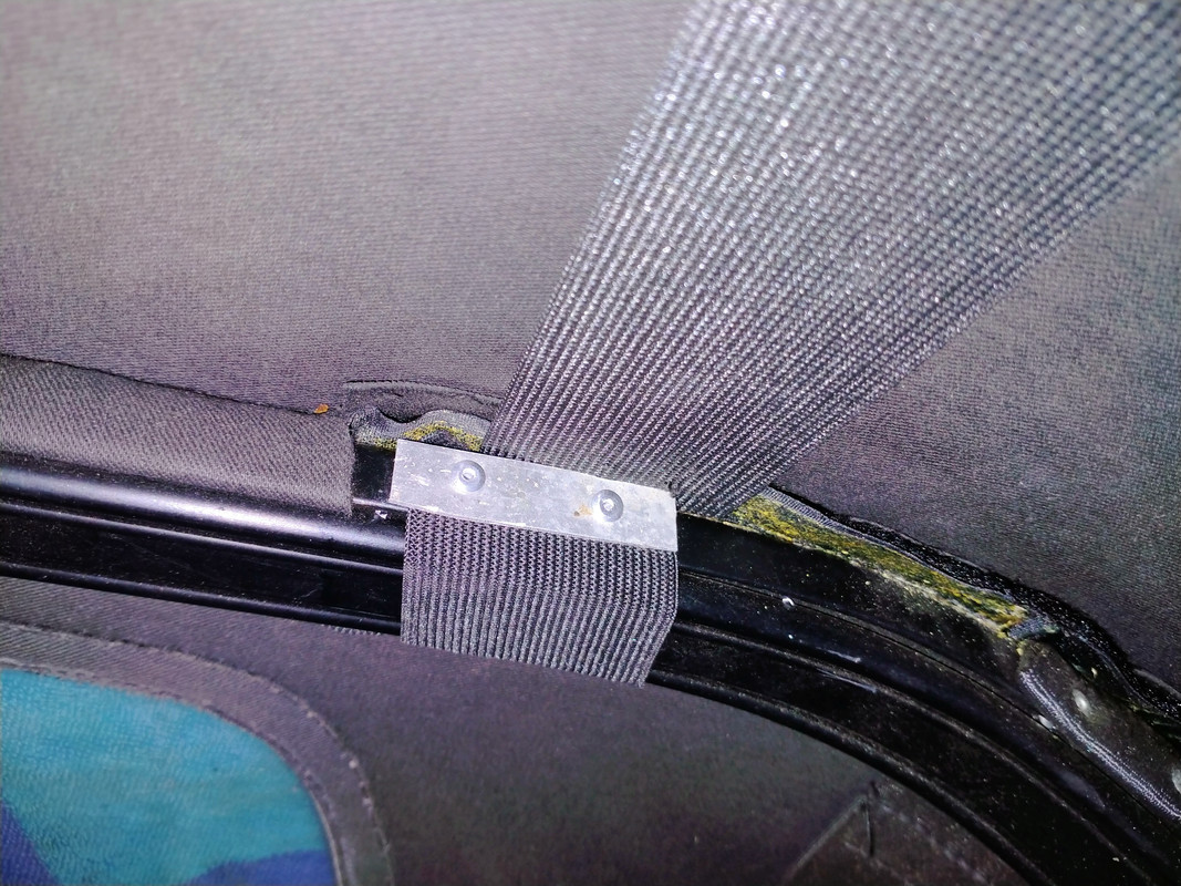

Inspired by HJ2's post, I replaced the hood webbing recently.
viewtopic.php?f=79&t=28322&p=366264&hilit=Webbing#p366264
I did it slightly differently. A couple of tips as well
- protect the hood when you remove the rivets from the header rail. You will be removing the back of the rivet, this butchered the rail a bit (I was too lazy to get out the Dremel) No matter, just drill a couple of fresh holes
- I couldn't for the life of me get my rivet gun in place to fix the webbing to the intermediate rails so I sewed the webbing either side of the rail
Fresh velcro-style trim with self adhesive backing was very cheap (and sticky) off Amazon
Will add pics later, when I'm remember how to do it

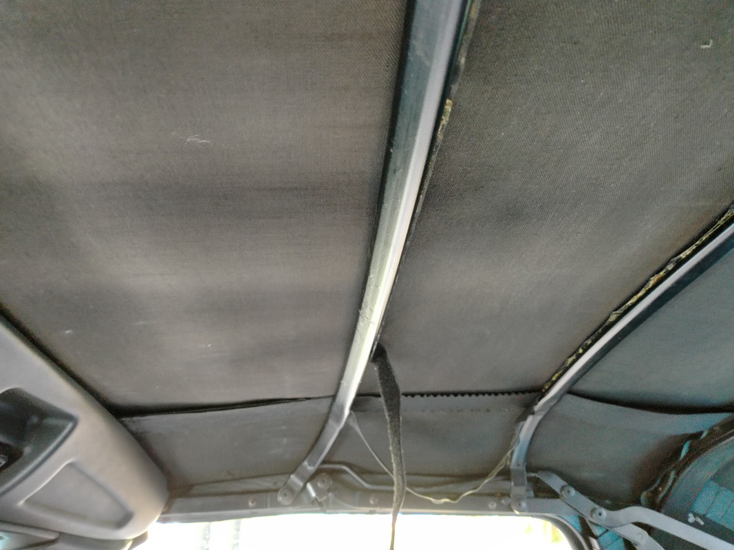

Before : complaints from passengers

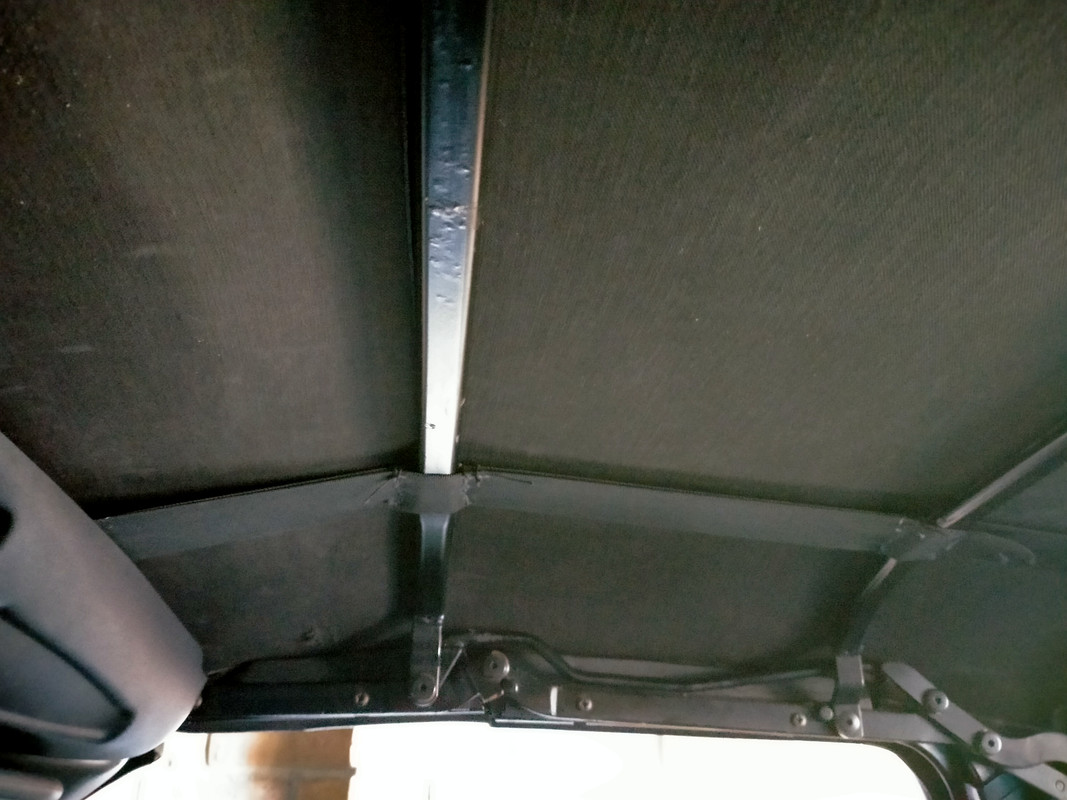

After...with crap sewing (1mm waxed thread)
Web fixing at rear
