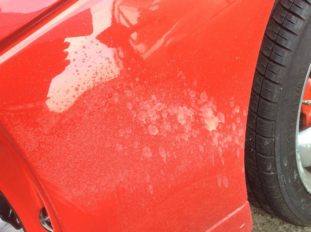

Postby Steve A » Fri 13.04.2018, 19:42
Having just done some "waxoyling" I would say if you can get a good job done for a good price go for it !
It's a very messy job and it goes everywhere :shock:
It just went off in my hand :roll:
Posts: 2152
Re: Waxoyl
Postby John_W » Fri 13.04.2018, 21:23
The last time I got rustproofing done “professionally” they managed to get it on the windscreen, hood, tyres, engine compartment, etc. Hopefully some of it got into the cavities.
