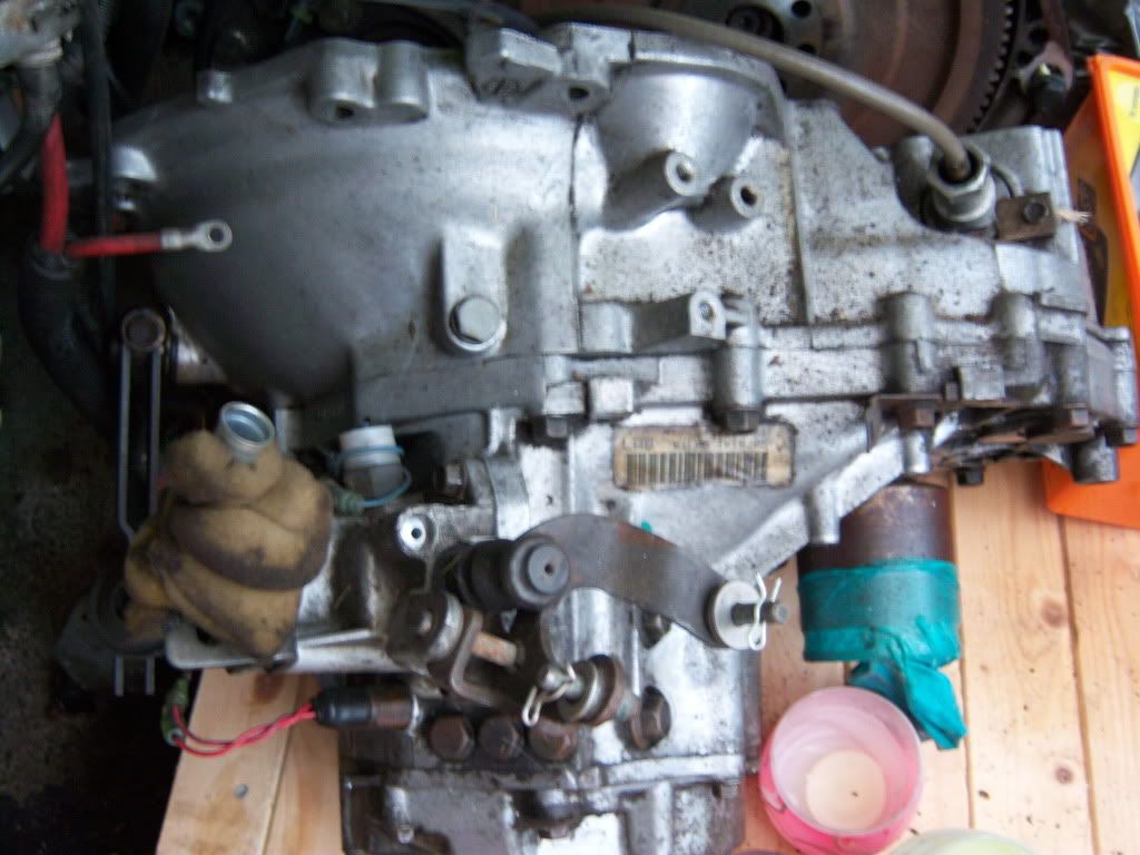

Here's a pic fella,
This is the end that wears, it normally causes low speed bouncing of the needle not total failure though.
Check the back of the speedo it may have poped out.

Are you sure you've posted the right pic there, Dave? I can't see the speedo cable at all. I can see the selector box but that is around the other side of the gearbox.
To find the speedo cable, remove the pipe which channels air from the wing to the plenum, then release the coolant header tank so it is free to move (no need to disconnect it), then push this forward to give yourself some room.
With those out of the way, you can get to the back of the gearbox. You should see a large, stiff vertical cable which attaches quite low right around the back. Once you reach in to touch it, your hand will obstruct your view. This is the speedo cable. It should be held in place by a small plate which itself is held in place by a small screw.

Postby Specky » Wed 25.08.2010, 11:28
Correct picture, you're using a naff browser.... :wink:
Basically you're seeing only half the picture, most people are seeing the full gearbox, saying that I can only see half a gearbox with an iPhone.
Monty highlighted this issue a while back. IE8 and firefox work fine on my home PC.
You should reconise the foam and metal connector that's jammed next to the selector, that's the speedo end of the cable.

Postby rip » Wed 25.08.2010, 12:16

Hmmm, I'm using Firefox & it is not giving me the option to scroll to the RHS of the pic. I've tried zooming out & that works fine though. :-?
Specky wrote:You should recognise the foam and metal connector that's jammed next to the selector, that's the speedo end of the cable.

Postby Specky » Wed 25.08.2010, 12:40
Sadly what you see is what you've got,
in your case there is no need to scroll right because that's the picture your browser thinks is embeded.

Thanks Specky! Just to clarify, we're talking about the red circled area, correct?

Postby Specky » Wed 25.08.2010, 14:58
Yep
