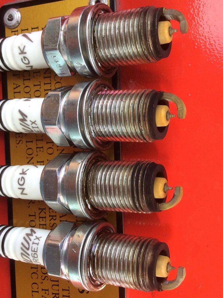

As suggested I have reset the ECU.
I was going to set the base timing but discovered my strobe light leads are to short :roll: so I need to make up some extensions
I then went for a spirited drive :burnout: and then rechecked the plugs (the gap is 0.8 ).
The pronounced popping has now gone and the car seems to be running smoother.
I could check the mixture at my local garage.
Time will tell whether the hot starting problem has gone or if it would be beneficial to go closed loop?

Postby lotustonybassplayer » Thu 13.07.2017, 19:39
I have recently gone closed loop with a mountain chip, and i am getting at least 5 more mpg, and no longer do i get the smell of fumes as i drive along in the car nor do i smell of them either after a journey :D and only .5% co at mot time :wink:
