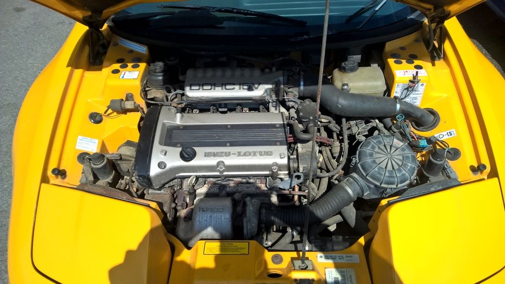

found a picture on my work PC........ handy that :)
As you can see here, it doesn't have a lambda sensor!!!!! i'll be cancelling that order then.

Check CTS - When it goes the temperature reported to the ecu is low and the ecu richens the mixture.
Check it with elanscan

Also, CHECK the parts source for the O2 (lamda) Sensor. The one in your eBay link has a picture of a single wire version and the M100 uses a 3 wire (pre-heated) version.
Look at Bosch 15701 for the correct one. I also found Bosch 13277 is a suggested substitution
In the US, 13277 are on eBay for $13.00 and Rock Auto lists them (use the 1991 Isuzu Impulse Turbo as the look-up) starting at $31.00 (From Denso).
Rock Auto also lists one there as a single wire version, so their information is not always correct.
The lower priced eBay item $13.00 is a MTE Thompson part and the Bosch listed is the 13277 ($29.65). I have used Herko for other parts over the years.
If it helps anyone, the Lotus Part Number is A100E6024S, The Isuzu Part Number is 8970185870 and The GM Part Number is 97018587

John: as usual extremely detailed useful information from you and can be logged for future reference. Unfortunately steble's car does not have an O2 sensor as it is open loop: see picture above.

I'm with Simon above - the rapid (2800 miles) change and the black plugs seem to point to a WAY too rich mixture. This could be caused by the ECU thinking the coolant is still cold. You can check the CTS with a multimeter for gross errors: It should be 185 Ohms @ 100C and high resistance when cold (the manual states 7500 Ohms at 4C). If the circuit is open it should have set a Code 14 - did you do the Paperclip Test?

I can't really help with your emissions problem but when I looked at your engine bay I couldn't help thinking the coolant header tank looked empty ?? Are you using glycol coolant ? Hope its not just water :shock:
Worth a check anyway while you're having a poke about under the bonnet.

Rambo wrote:I can't really help with your emissions problem but when I looked at your engine bay I couldn't help thinking the coolant header tank looked empty ?? Are you using glycol coolant ? Hope its not just water :shock:
I'll be honest, i've not put anything in it since i've owned it so don't know what coolant is used. it is not empty however
I will give this a go! :)
Unfortunately I will not be able to touch the car to the weekend so have tried any of the above ideas yet :( I really want to get on with it! lol

Yeah now the bigger issue.
If it does turn out to the the cts, where the hell do I get a new one?
Can't find one anywhere!!

Postby epipete » Thu 18.02.2016, 10:29
steble wrote:Yeah now the bigger issue.
Try the wiki http://wikilec.9600.org/index.php/CTS
It's the place to start :burnout:

Edit: ...and it now looks as though we've nailed the cause of the cr@p fuel economy - exactly as SOMEONE previously advised! :roll:

steble wrote:If it does turn out to the the cts, where the hell do I get a new one?
SJS :wink:

Postby steble » Thu 18.02.2016, 11:22
Wow thank you now I have found loads!!
so any of these should work hopefully
http://www.ebay.co.uk/itm/NEW-INTERMOTO ... Sw3ydVwi6P
http://www.buycarparts.co.uk/metzger/1811144
and many more
