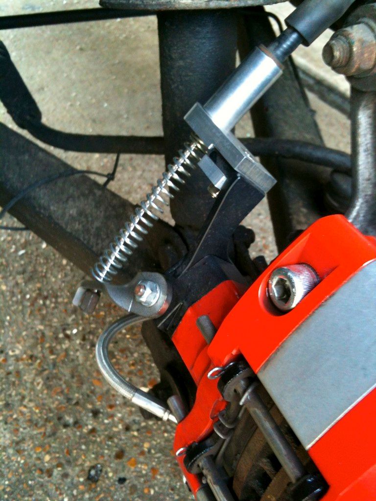

How much should I extend new levers by? Is an inch too much? Cheers

Dico wrote:How much should I extend new levers by? Is an inch too much? Cheers
Here we go Dico, this should give you a clue :D
I added the spring to assist the return of the arm to it's start position

Postby Dico » Mon 03.11.2014, 16:36
Brilliant Steve. I didn't even think about extending the other bracket. Cheers.

Dico wrote:Brilliant Steve. I didn't even think about extending the other bracket. Cheers.
I can't take the credit it was Bob :smt023

Unlikely, but has anyone got these extended levers and upper bracket hanging around? Or the capability of making them? Cash/numerous spare parts available in exchange :-)
