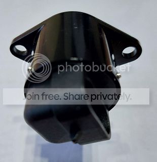

Re: IAC Valve
Postby Specky » Mon 01.03.2010, 18:16
I can confirm they have one on Ebay... :-D
I got this a while ago, couldn't tell you if it's serviceable or not thou.
Re: IAC Valve
Postby ashm » Mon 01.03.2010, 18:26
Looks very similar at least.

Re: IAC Valve
Postby ashm » Sat 13.03.2010, 19:42
Ok, so the part I ordered above is NOT the correct part... it's very close, but the connector points the wrong way.
It _can_ be made to fit, with a little gentle coaxing (if you've got a set of needle files...) but I wouldn't recommend it unless you've already bought one.
Unfortunately as I was removing the old IAC, one of the screw heads sheared off, leaving the screw in the manifold :evil:
I'll have to think about how I'm going to get that out, there's barely room for a screwdriver in there!

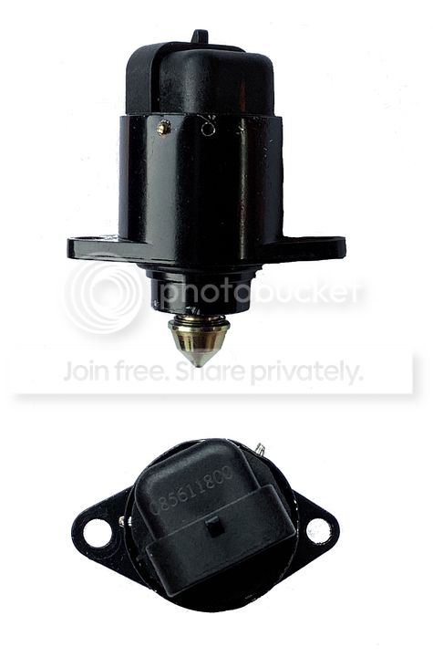

Re: IAC Valve
Postby GeoffSmith » Mon 07.06.2010, 13:55
bratboy_y2k wrote:if you go onto rock auto.....
Be careful though as Rockauto list {Type A} as Airtex / Wells Part # 2H1020 {#17111826, 8171118260, AC106} as this:
and {Type B} as Kemparts Part # 150107 as this
The connector on the first one appears to be in the same orientation as the one Adam got and is 90° different to the second one and to Specky's picture (Specky, are the purple pictures of the correct one out of your engine or the wrong one off FleaBay?):
And there's more.... I'm confused or someone appears to have it wrong because Topont show the Type A = AC15 & 17111826 for VW and Type B = A95214 & 17112023 for Astras!
And these buggers show Type C (connector in line with mounting holes) for 17111826!!! :evil:
Re: IAC Valve
Postby ashm » Mon 07.06.2010, 16:00
Yep, it is a pickle!
You can come a cropper just blindly chasing through xref lists, because in many engines there will be clearance for the connector to go either way, so half the parts listed will fit the Elan and the other half won't. Two hops and you could end up looking at a list of parts that ALL point the wrong way.
Probably best to stick to the ones listed for the Impulse unless you can get a good photo of the part you're buying.

Re: IAC Valve
Postby ashm » Sat 26.06.2010, 15:23
So out of interest I ordered one of the Kemparts 150107 IAC valves... (it was only $27, and I was interested)
...and it's also got the connector pointing the wrong way! :(
I've just drilled out the blind roll pins (grr! Stupid type of fastener...) that hold the connector part onto the rest of it, rotated the connector 120 degrees and put it back together. I messed up the holes a bit so I epoxied it rather than re-pin, which would be the better option.
Now the connector is fitted in a usable direction, and the modified IAC appears to work perfectly. So it seems all is not lost if you've bought a part with the wrong connector orientation.
By the way, if anyone else tries to take one of these apart - be careful! There are some fragile bits inside.
