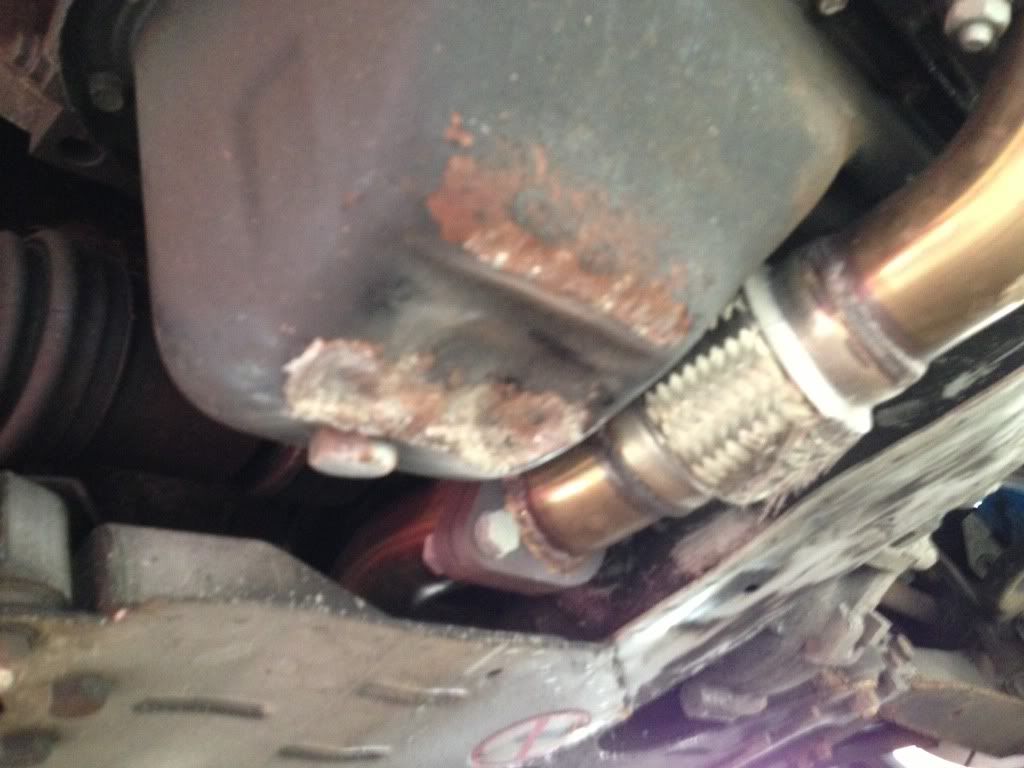

results from Ypres - looks like I best get mine changed also!

paulsmithmk wrote:results from Ypres - looks like I best get mine changed also!
Thats a exact copy of mine :( Any thought with the JC sump anyone :?

Postby Jeemy » Mon 20.05.2013, 11:27
Mine looks like yours Paul and always has done. How bad a thing is it?

Postby paulsmithmk » Mon 20.05.2013, 11:37
Jeemy wrote:Mine looks like yours Paul and always has done. How bad a thing is it?
well it's not leaking! I will have it checked when I take it in to have front suspension lifted as I couldn't manage to do the front.

Postby alan e » Mon 20.05.2013, 12:45
I had a leak in my sump after hitting a ramp did a temporary fix about 8 weeks ago using plastic padding leak fix which worked very well, i managed to find a used sump in the uk which i have taken the dents out and painted now waiting for me to fit it, there are lots of used sump in the states i found a brakers that would send a sump to the uk the price of the sump was $30 + $80 postage then you will have to pay some handing charge to the royal mail if you are disparate may be lec members in the states can help find them for you i did try isuzu in the uk but they were no help.

Postby Brit-Car-Nut » Mon 20.05.2013, 17:44
I looked up the Isuzu part number for the sump and there were actually two different part numbers but part number 8970310180 supercedes the earlier number.
The number is STILL ACTIVE at Isuzu but they do not have any in the US warehouse and there are none on order for the US warehouse. They will supply on a part order basis only, that means it is no longer considered a stocking item.
The lead time is 4 to 5 weeks. The price for the sump is currently $169.50 and several dealers show a small discount. The best price I found was $136.00 plus $25.00 shipping to my address.
Shipping from my address to the UK by Parcel2Go is around $100.00 That is 3 day service, but really could be a bit longer due to Customs, etc.
Shipping by USPS Priority Mail (6 to 10 days) is $75.00 and Express Mail (3 to 5 days) is $85.00.
A group buy might be a consideration, but with a lead time of at least a month, is it really feasable? The order would need to be paid for in advance and then they would be shipped to a central location for re-shipment.
I checked and Amazon doesn't list them as well as Rock Auto. I believe Dorman has discontinued their replacement sump as I couldn't find any at any Dorman sockist in the US.
The pan from a Geo Storm is supposed to be a direct match and there are a few used ones around the US.
If anyone wants to have the details and place an order directly, send me an email and I will give you the details of who I spoke with at Isuzu dealers in the US.
