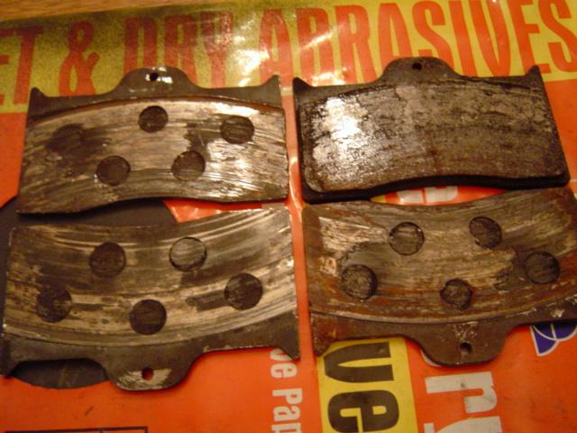

This was what was left of the Wilwood smart pad after one trackday and had to drive home on these :shock:
Worn Wilwood pads
Wilwood Smart pads after 1 trackday.jpg (56.52 KiB) Viewed 3525 times
Postby ailwyn » Wed 07.02.2007, 19:39
Nice, be grateful you don't have greenstuffs as my rear ones only last about 3k, they probably would have burned away before you finished on the track.
Have you scored the discs?

Postby F1 LOTUS » Wed 07.02.2007, 20:43
Keep an eye on your brake fluid level when you're burning through pads at that rate :wink:
Probably worth getting some dedicated trackday pads and a bunch of spare cotter pins :smt023

Postby Monty » Wed 07.02.2007, 21:04
ailwyn wrote:Nice, be grateful you don't have greenstuffs as my rear ones only last about 3k, they probably would have burned away before you finished on the track.
errmmm i`ve also bought green stuff pads for thw Wilwoods as an emergancey set. Not sure if i`ve got black stuff on the rear and there working fine. Supprised u`ve worn the pads so quick on the rear as there`s not braking effort on the rear. :?
The Disc aren`t perfect, i`ve cleaned them up to get a bit more life out of them as there only 18 months old. But i`ve got a spare set :-D
F1 LOTUS wrote:Keep an eye on your brake fluid level when you're burning through pads at that rate :wink:
The 1st set was the Poly Q, 18 months and 1 trackday.
Smartpad well 1 week and 1 trackday :roll:
Now i`ve got the Poly E set on + a set of greenstuff as spare set.
I`ll see how the E`so, but i might go for even a higher temp pad
ps forgot to get a spare set of cotton pins when i placed my order with RallyDesign :roll: I`ll see if i can get them local
Postby Nige » Fri 09.02.2007, 12:17
I use Red stuff with my Hi Spec brakes for trackdays, they're ok for road use as well. They are certainly more durable than that! Have'nt yet bought the discs and calipers to change to Willwoods but intend to do so in future

Monty wrote:This was what was left of the Wilwood smart pad after one trackday and had to drive home on these :shock:
Dudes, if you look at the Wilwood Technical Catalog http://catalogs.wilwood.com/2008_Tech_Catalog.pdf on pages 62 - 64, you are using pads with a MEDIUM wear rate, and in your best-case scenario (Q), a LOW wear rate. There is a high-friction (ie, lotsa stopping power but 'bitey') pad with an X-LOW wear rating that's good across the entire temperature range... the Wilwood 'A' pad compound.
