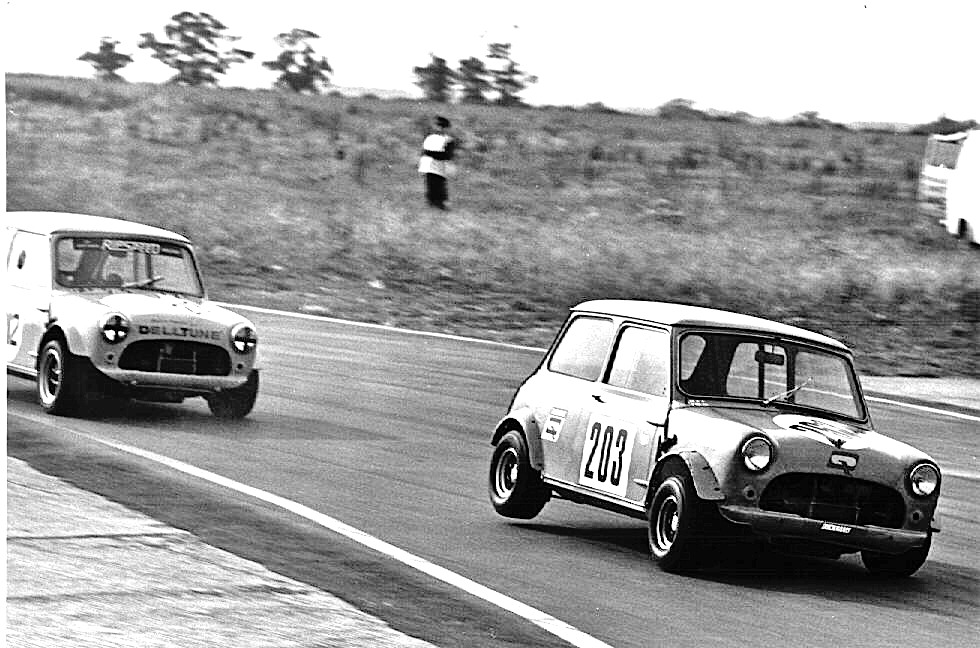

Not surprised about the tyres, that's the only left hand bend on the circuit, apart from the 2nd bits of chicanes which are a bit mickey-mouse. It's nearly all right turns so working the left tyres most of the time.
What suspension stiffness had you put on? Hope you hadn't wound them up to max' like a lot of people think they should do.
I raced Mini Miglia in the 70's and at a Snetterton test day there was a guy with a BDA engined Escort using the adjacent pit who came in and said 'It's great for the first few laps but then becomes 'king un-driveable'. I heard a creaking noise and happened to notice his Escort slowly coming up to it's normal ride height as it sat in the pit lane and pointed it out. He had his shockers rebound so stiff that after a few laps they were fully compressed and he had no suspension movement left. Backing them off a bit sorted it out.
First Mini we built had Konis and their Setup Instructions were to start on softest settings for Bump & Rebound and move upwards from there... bit of theory on setup here that may be useful - www.koniracing.com/rrtuningguide.cfm
Problem with Konis was we had to take them off to adjust by turning the piston rod but found they were already a bit firm for the rear of a lightened Mini. The guy who drove that car rarely changed the settings as it was such a p.i.t.a.
When we built my 'super lightweight' Mini I went to Spax, in Kentish Town near me, and got them to build me a set that started soft so I could use the range offered by the adjuster screw. Rears I kept quite soft but increased the front as most of the weight was the power unit up front, but would change the rears for the bumpiness of the track, or back them all off if it rained. Seemed to hang on well going flat out through what was the Snetterton Esses, now called Nelson, and we weren't allowed LSD's so setup was critical ...
My team mate tried a season in Special Saloons where LSD's were allowed and he didn't like the handling when a wheel lifted and the LSD kicked in - found it very unpredictable where it was going to go as understeer came and went and the back end would sometimes unstick.

(lotusflasherman > At first sight your photo of the racing Mini is rather funny to the LHD driver in me since the RH side is invisible and the LH side is clearly empty :-D )
