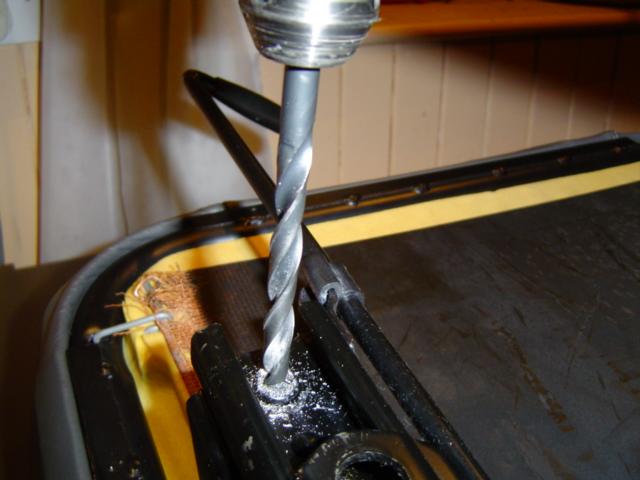

Postby Monty » Sun 18.02.2007, 18:46

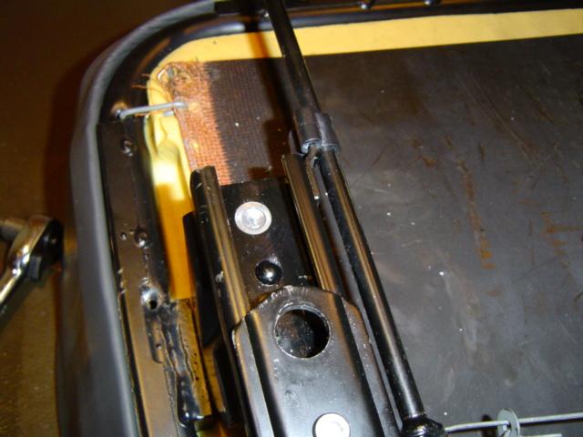

Removing off the stock runners
It`s possible to remove the runners by undoing the brackets but since the brackets were no use to me i had to do a bit of drilling to seperate the front brackets from the runners.
Pic 1 & 2
Front bracket. Drill the head of the rivet
Pic 3

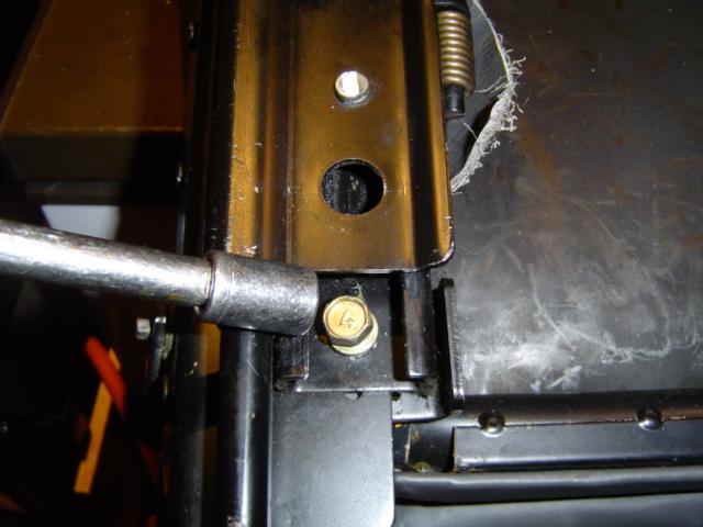

Undo the bolt to release the rear bracket
Pic 4 & 5

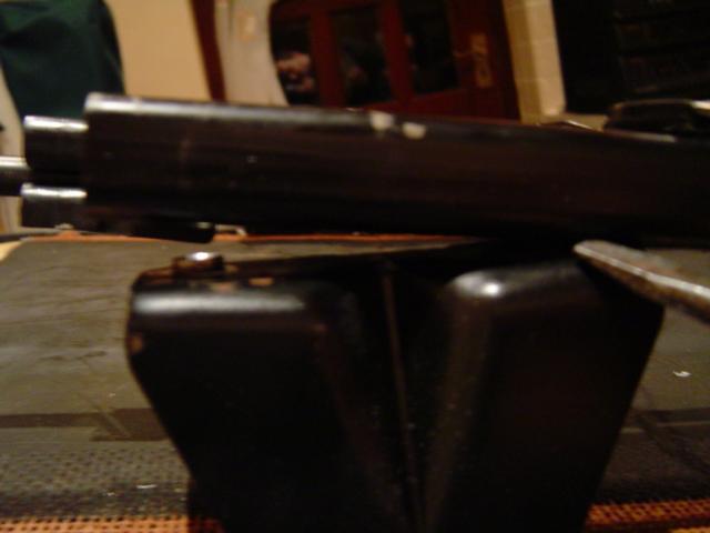

Front Bracket. There`s also a spot weld which needs prising/breaking
Drilling the head of the rivet
001 Front mount, drilling rivit head off.jpg (37.39 KiB) Viewed 19571 times

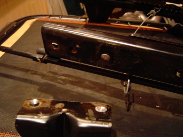

Rivet head removed
002 Front mount, Rivit head removed.jpg (43.31 KiB) Viewed 19568 times
undoing the rear bracket
003 Rear bolt.jpg (40.84 KiB) Viewed 19571 times
breaking the spot weld
004 Breaking the spot weld on front mount.jpg (25.6 KiB) Viewed 19570 times
Front bracket removed
005 Front mount removed.jpg (39.47 KiB) Viewed 19569 times
Runners removed
006 Runners removed from stock seats.jpg (46.14 KiB) Viewed 19568 times

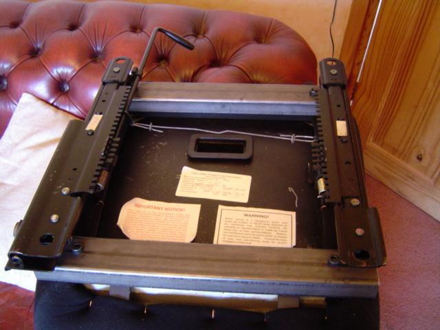

Adapting the stock runners to fit the Cobra seats
To get these to fit i used 4off 30 x 50mm rectangular steel section 390mm in length (£10 from local engineering shop)
Runners to rectangular section = 4off 30mm M8 bolts, nuts and washers.
Rectangular section to Seat = 4off 50mm M8 bolts
Spacers between runners and rectangluar section = 4off 10-15mm (i used large old nuts i found)
I used the exsiting holes in the runners ie the holes at the front were the rivet was removed and the rear were the bracket was removed.
then it was a case of the measuring for the stock runners and the mountiong holes on the seat base, then i realised that the bolts were close together so has to use spacers so they didn`t intefer with the runners.
Infact i had to put the bolts to the runners on the inside of the rectangular section as the were hitting the seat base. As u can imagine not straight forward and the amount of times i had to dismantle everything was doing my head in :evil:
Runners attached to the rectangular section
Picture 007.jpg (50.14 KiB) Viewed 19676 times

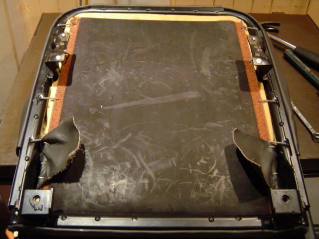

runners attached to seat
Picture 009.jpg (45.32 KiB) Viewed 19565 times

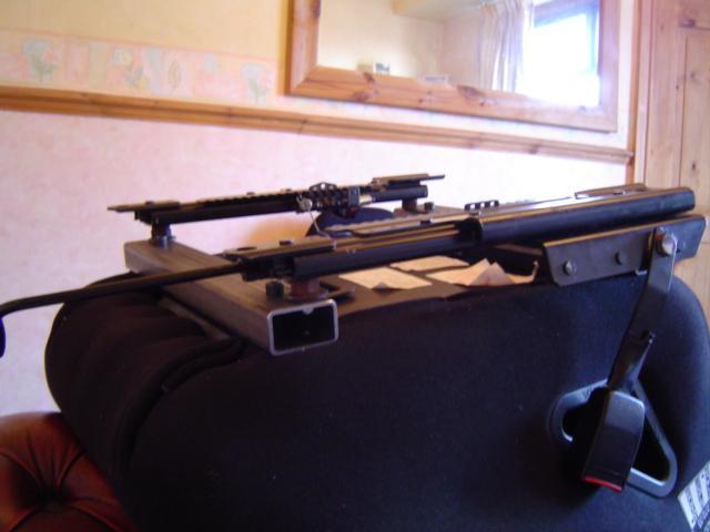

spacers
Picture 010.jpg (33.19 KiB) Viewed 19564 times
