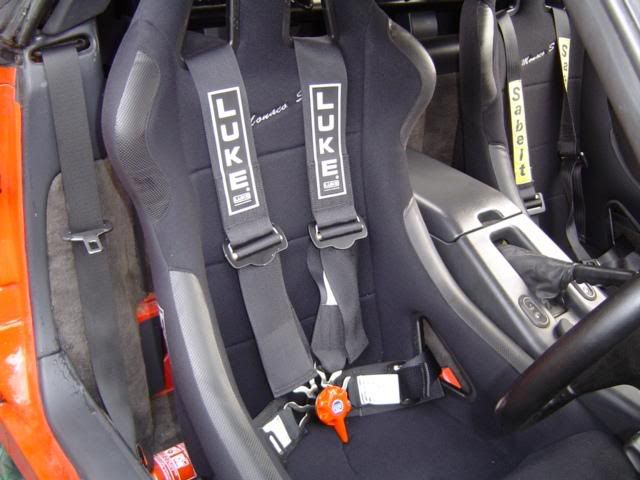

Yes all safety equipment in the motorsport have expire dates, but at least i know the seats are up to motorsport standards
Don.Hasi wrote:Monty: they look amazing!! Great Job! :smt023 Please show us at last pictures when you have mounted them.
Don,
I`ve had these fitted for a few years now, but now we`ve got Bob onboard he came up with a better solution to my bodged job lol. Here`s the photo`s of when they were 1st installed (note: i`ve changed to simons roll hoops)

abmunro wrote:They look a great!!
How difficult was it to find mounting points for harness's?
Tony
Thats a bit more imfo here viewtopic.php?f=72&t=8724
I went for the 4 point Luke Harness from Hanger 111 for the drivers side, this is the wrap around type for the shoulder straps which go round the Roll bar/hoops. The left side lap strap goes to the rear inboard seat mount, the right side goes to the original mounting point on the sill were the seat belt is conected.
