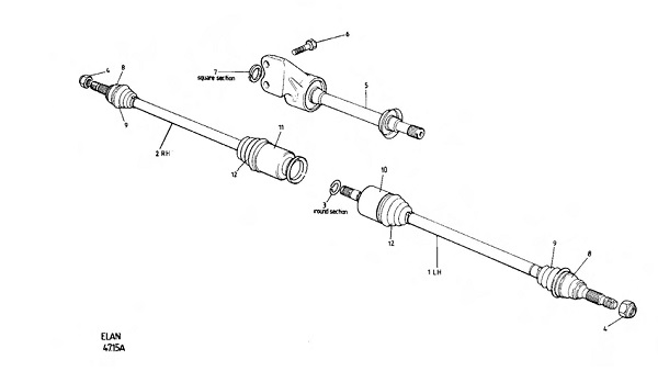

Postby dapinky » Sun 17.11.2013, 13:49
Hmm, if you haven't got the bracket, then you haven't got an O/S driveshaft, so you wouldn't go anywhere!
I can't find a photo which shows it, but it is definately there!
Best way to describe its location is near to the altenator.
If you feel up the back of the engine block, along the driveshaft, you will come across the bracket which (should be) bolted tight to the engine block by a couple of 14mm (headed, not thread!) bolts.
A combunation of vibration and age (or incorrect initial tightening) can cause one or both bolts to work loose and cause your symptoms - if it becomes completely undone, i don't think that there is enough room for it to spin round and the drive shaft to drop off, but I'm sure it'd make some interesting noises :-D

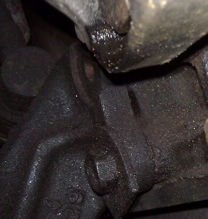

Postby epipete » Mon 18.11.2013, 15:33
Yep, got it. Bottom bolt was pretty tight but took a little turn, the top bolt is missing! Any ideas if there is anything special about this bolt presumably I can get the size from the manual?
Thanks
Loads of oil but no bolt!

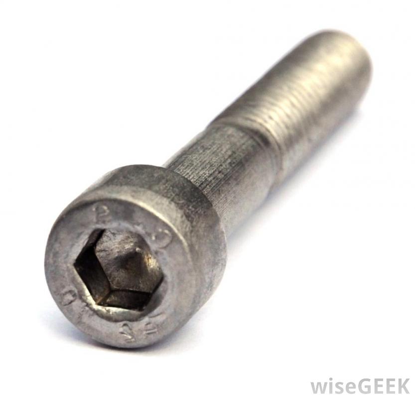

Postby dapinky » Mon 18.11.2013, 17:21
Glad you found it before it fell off!
Firstly, I don't think that there is anything special about the bolt, but I can't remember - I just re-used mine.
Secondly, the parts guide just gives a part number, not a size - this suggests to me that it might not be a 'standard' bolt (possibly only because the head (spanner) size is not what you would normally get on that thread diameter/pitch?????)....
...that's not to say that a standard bolt wouldn't do the job, though - nowt special about the tensile strength needed - it just supports the bearing...
....it may well be that the thread is something like M10, but the head is (IIRC) 14mm, whereas a 'standard' M10 would have a 17mm head, which may not fit in the metal bracket without fowling.
I would suggest sticking any old bolt into the top hole just to hold it in place, remove the good one (they're both the same part number, so will be identical) and measure it (thread diameter/pitch & length) - if it needs a smaller than standard head, I would suggest just using a cap-head bolt with an allen key fitting......
.....something like this:-
