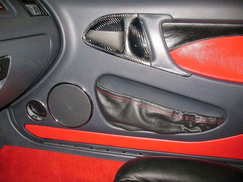

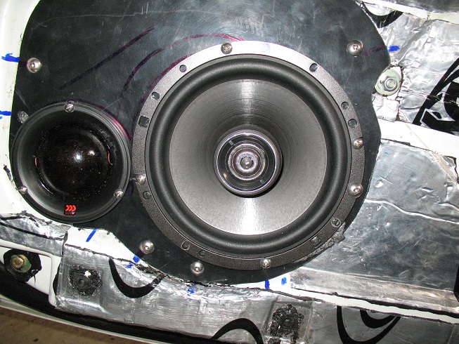

I love a great stereo. There's nothing like blasting out a great tune with the roof down and scaring all the neighbourhood children and cats (I mean really, do you need either of these???). Problem is, the Elan may be the worst sound stage to configure in the history of cars (although most convertibles suck at this). I did pretty good with the Polk Audio 6.5 speakers (incredible sound and clarity) and the 10 inch sub from a few posts ago. But, it just wasn't enough. With the roof down driving on the highway you lose a lot of mid range to road and wind noise. Blah. So, I decided to add some more speakers :-D Actually, I decided I needed more mid range.
The Polk's are components so I can mount the tweeter in the centre of the woofer (where it should always be) saving space. I sourced out a very nice set or Morel CDM88 midranges on eBay that were tiny enough to fit. I've always found the rear speakers to be practically useless blowing sound up your a$$. So, I removed them completely and ran the Morel's from the rear channel outputs. At least ALL the sound will be coming from the front sound stage now. Oh yea, I replaced the amp at the same time and installed a JBL HD900/5 (meaning I now have an almost brand new Kenwood Excelon X5 5 channel digital amp for sale (nudge nudge :D ).
This was a complicated job but proves that you can fit a 3 way speaker system in the front if you want. I had to make new speaker mounting panels first for which I used some plastic serving trays (don't laugh) with a rubber backing to reduce vibrations. The Polk Audio speakers are shallow mount which was a requirement to get everything to fit. I also had to trim away some of the fibreglass of the door panel to fit a larger speaker mounting panel - no big deal there. Even so, the windows had to be adjusted outwards so the speakers didn't hit the glass. Below is a pic of the speakers and I'll post one of the finished door panel when its completed as I still need to add an additional grill.
This isn't a traditional 3-way system. Its much better :mrgreen: My Polk 2 ways sound great on their own but with an additional set of spekers in the front (albeit midrange only) this system sounds really fantastic now sitting in the garage. Can't wait to test it on the road. Cats beware! :twisted:
Re: Interior Makeover
Postby Elanlover » Sat 22.06.2013, 16:33
The finished product.....so to speaker. I mean speak ;-)
Postby Elanlover » Sat 27.07.2013, 19:12
The stereo sounds incredible now - as good as one can get with this car I believe. I highly recommend people ditch the rear speakers in favour of some other arrangement which could include dedicated mids upfront (like I did), room for a sub (or two) behind the seats (or the amp like I did) or more power to the speakers up front by driving them on both the front and rear channels, etc.
