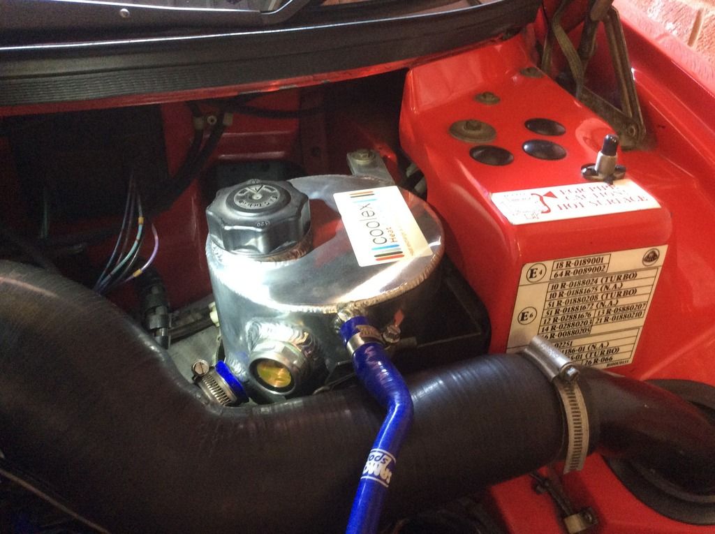

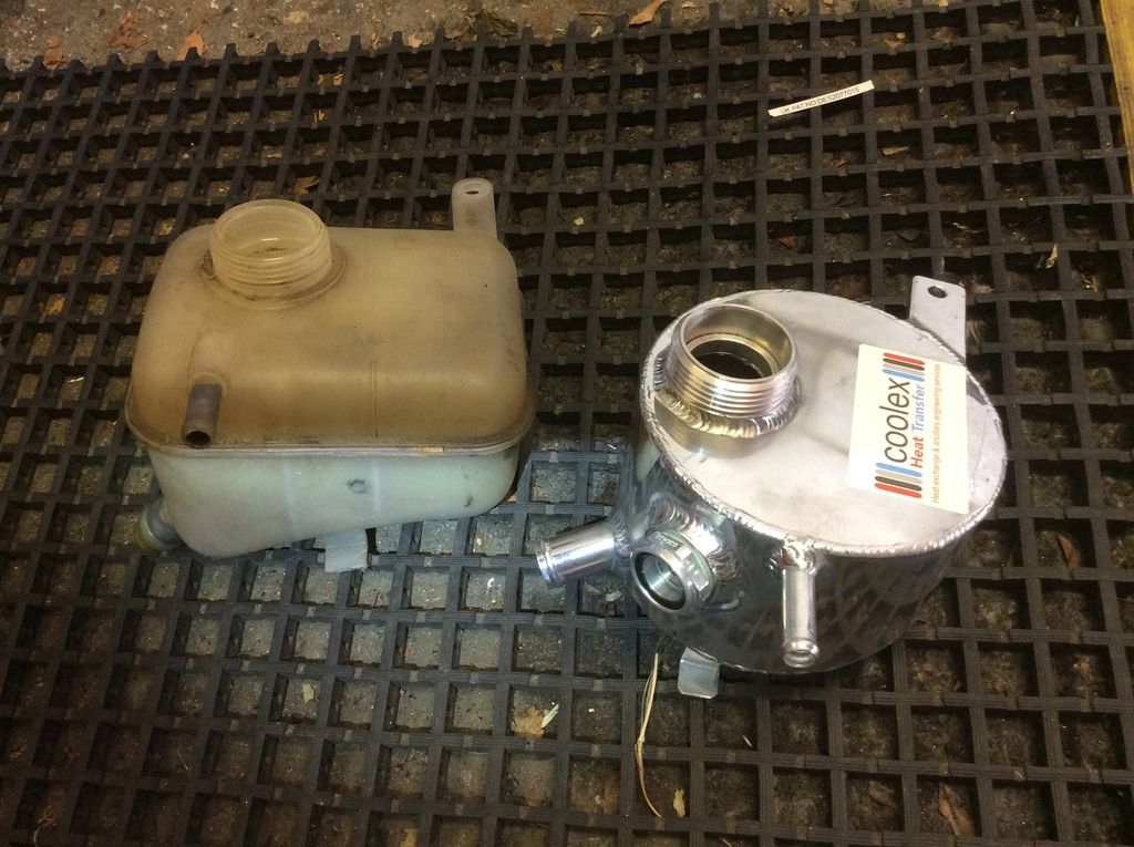

Postby Steve A » Mon 19.06.2017, 13:01
8) With such a nice day it would be rude not to fit my new Coolex header tank
It was all very straight forward, no cutting bending or fettling required :D
While the header was removed I fitted my new coil packs and fancy plug leads 8)

Postby Elanlover » Mon 19.06.2017, 14:32
The tank looks good. If I recall correctly there's no viewing window is there?

Postby Brit-Car-Nut » Mon 19.06.2017, 15:10
The sight glass /viewing window is circled

Postby Elanlover » Mon 19.06.2017, 22:07
Is it truly visible by glancing at it? It's hard to see from the picture and I'm concerned that it's not all that useful in reality.

Postby Rice crispy » Mon 19.06.2017, 23:58
Elanover, it's really easy to see, if you have anti freeze in its even easier
