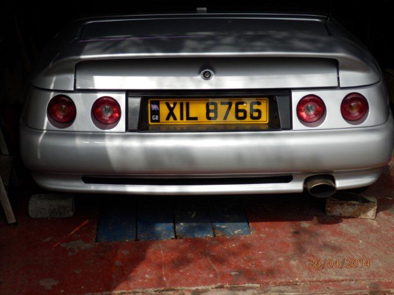

As the more eagle eyed among you can see, there are bricks behind the rear wheels. That is because the car is on axle stands - again.

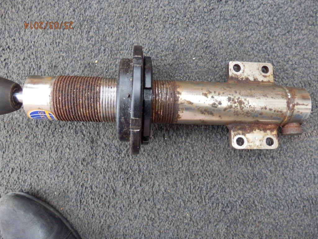

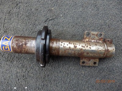

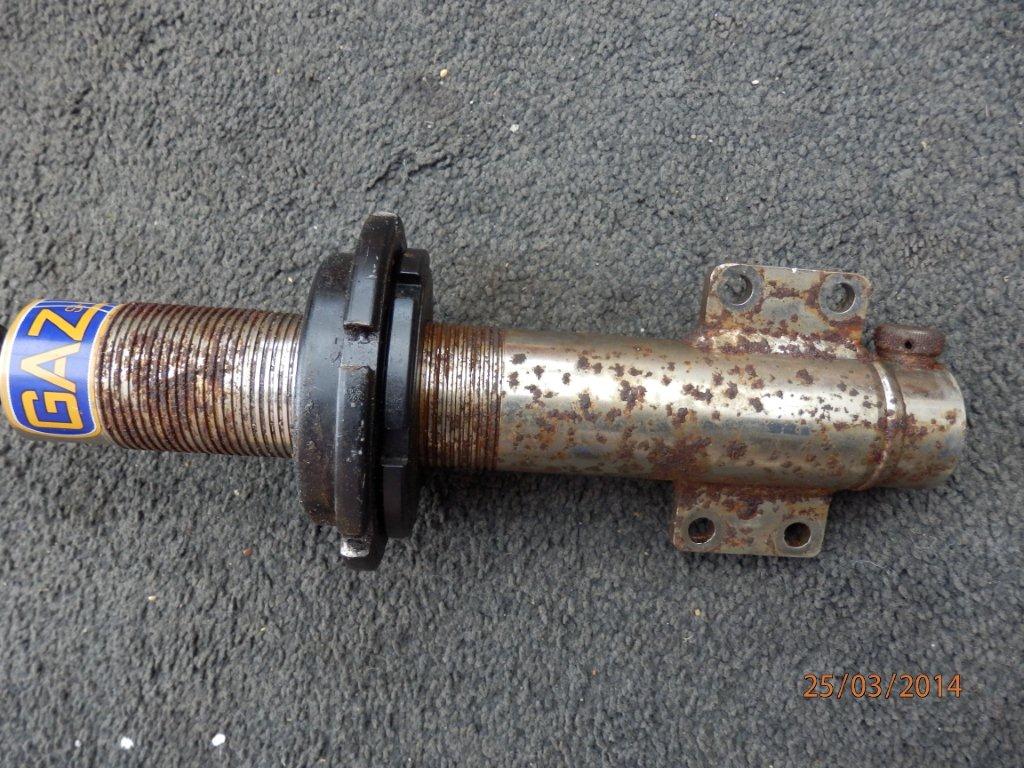

Andy at Q-Mech had mentioned that the front shocks were corroded and difficult to adjust. I was a bit surprised as they had only been on the car for 14 months & 900 miles. So had a look and found this:
You don't have to be Sherlock Holmes to work out why they were hard to adjust.
James at South West Lotus has been great, he really understands customer service and has been instrumental in dealing with GAZ to sort this out. A new set is on the way.
Apparently there were problems with the early Nickel coating process, this has now been resolved and while James has not heard of any issues, I would urge all members with GAZ shocks to inspect them.

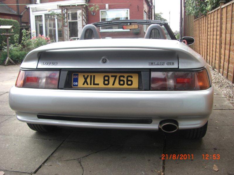

Before and after pics of the rear, I know which one I prefer.

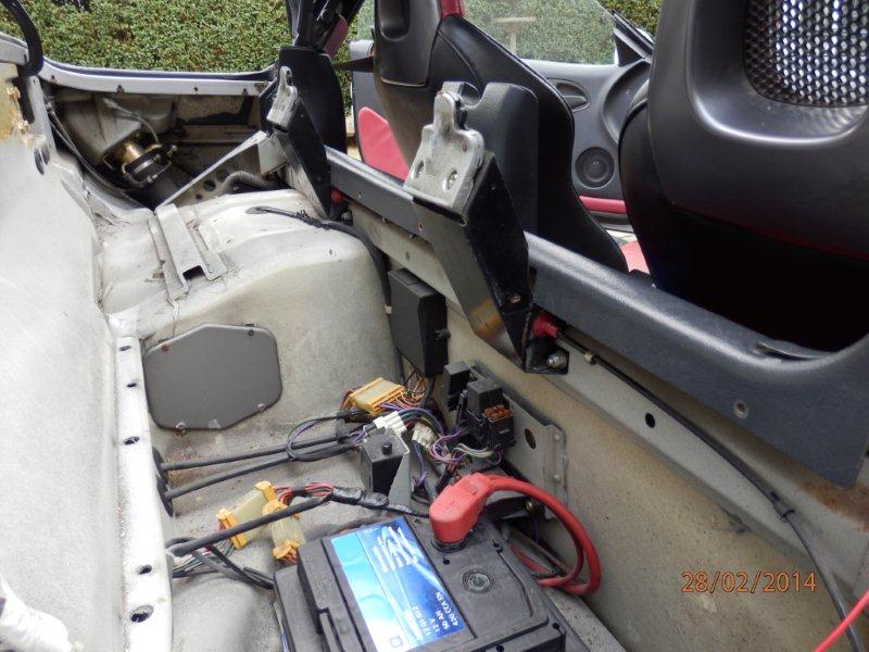

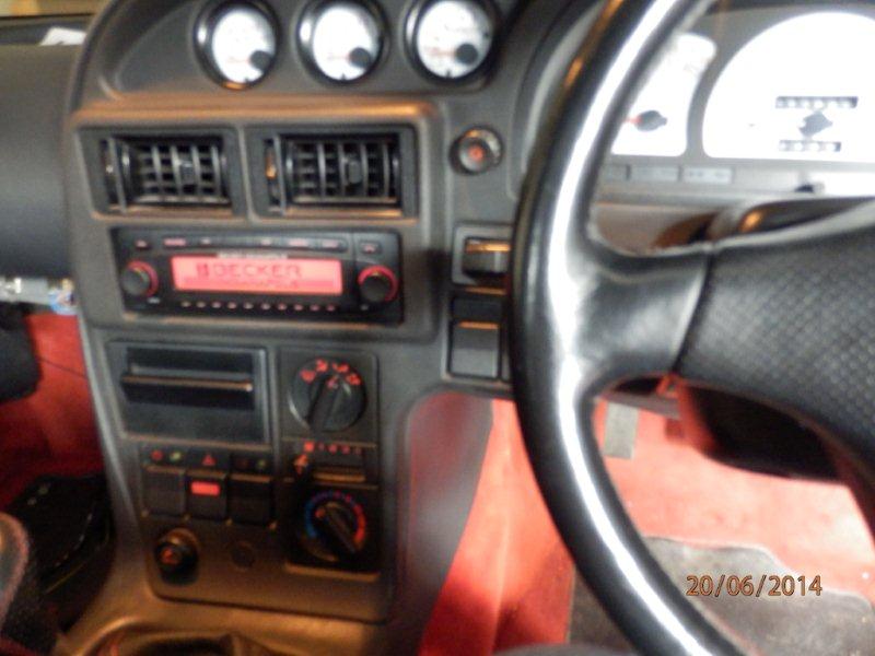

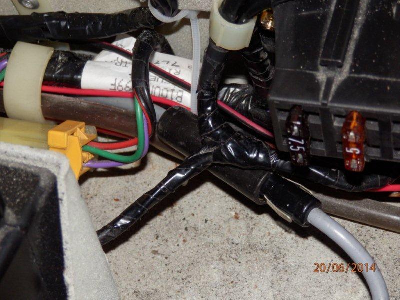

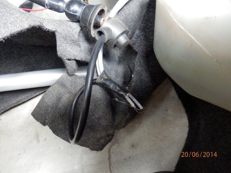

The radio reception has always been poor, this could be why.
Someone has fitted a new aerial and decided just to twist the coax cables and shields together and wrap with tape. That has to come out, so while I am at it, time to sort out this mess.

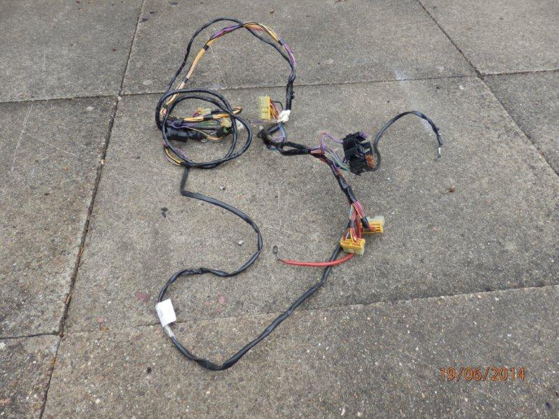

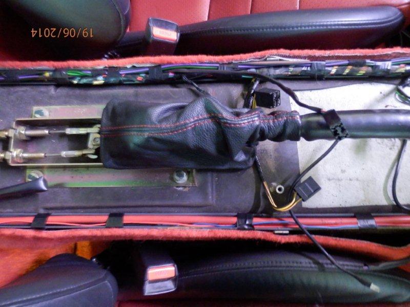

Original alarm wiring removed, although there is a lot of it, it is quite a clever plug & play design.

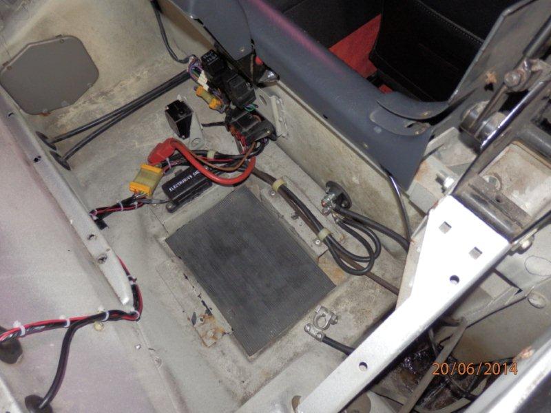

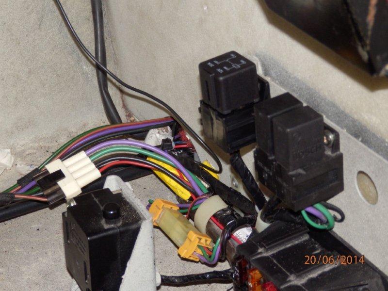

Boot remote unlock solenoid wiring and relay installed.
I also used the telephone connector to run in new wires for the radio. This plug has positive, earth, switched positive and illumination available, only needed to add a reverse light signal and speed input to fit this Becker 7922 navigation. A poor picture, but for me it is more suited to the dash than the old Alpine.
On my car there was an aerial cable plug near the fuse box so only had to run the new cable as far as there. Looks like it could be standard.
Alarm wire for the boot re-routed, aerial cable and battery isolator fitted. I really wanted to have the isolator in the boot but as I have a strut brace fitted, there was no easy way to make it fit and be out of sight below the plastic shroud. Looking a lot neater now.

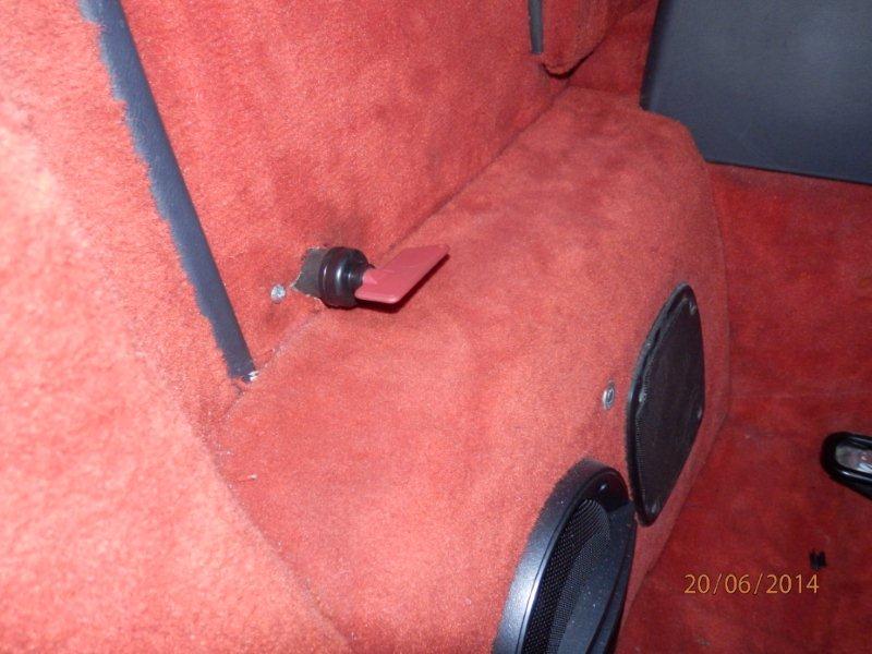

Battery isolator, red key is removable for some extra security. It also matches the carpets and looks pretty unobtrusive when the seat is back.
A new plug fitted under the centre console.

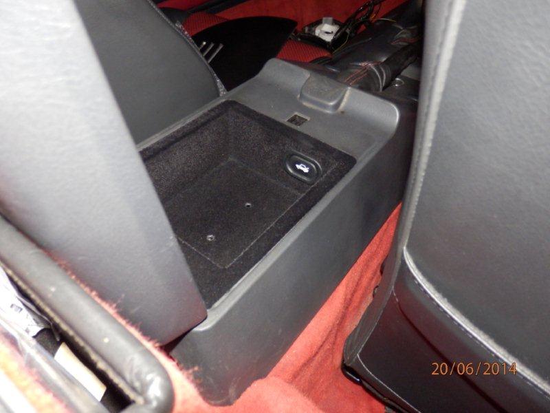

Saab boot release switched tucked neatly away under the armrest. As the Toad alarm has a boot release function (hence the relay) this switch will only work with the ignition on.

Mine is similar, working from the spare button on a Scorpion alarm fob and from a switch in the car, but it has a permanent feed. I decided the security issue of a permanent feed was not an issue, as did a few others here.
I used a Volvo double switch and I can also open the fuel flap. Each part of the switch is appropriately labelled.

The Alfa GT does not have an external boot release switch or key, it can only be opened by a button on the key fob or a switch on the dash. This switch works with ignition on and remains active for a timed period after the ignition is turned off.
Being used to such a system, I would rather have the added security of the boot release being off when the car is left unattended, especially when driving around some of the less salubrious areas of Europe. A hidden boot key would seem to be a better solution.

I really like that idea of locating the boot release in the armrest tray - I'll be doing that next time I install one. :D

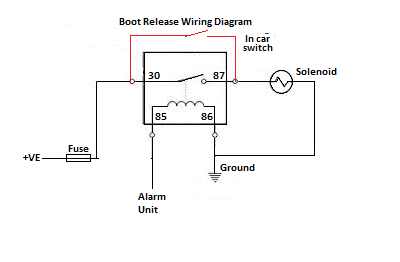

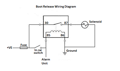

Sorry to hijack your thread but does this diagram I've drawn up look right?
I have a hidden switch that I want to work at all times as well as the remote boot release from the Toad alarm that will only work when the ignition is off
Boot release.png (12.27 KiB) Viewed 11744 times
novacaine
Posts: 428
Joined: Tue 07.06.2011, 18:16
Re: XIL - A Rolling Project
Postby cliff » Mon 23.06.2014, 22:36
That´s a nice diagram, better than my scrawled effort. :D
Only thing I would be worried about would be the 12v from the in car switch causing damage to the alarm control unit. You would be better off with either a diode on the alarm line or connect the in car switch to pin 87 so that the alarm unit is totally isolated.
Something like this:

Postby maz_r » Tue 24.06.2014, 00:22
Much cleaner.
(and we are assuming here that the Toad outputs a +ve pulse when activated, rather than pulling to ground. Consult the Toad manual......)

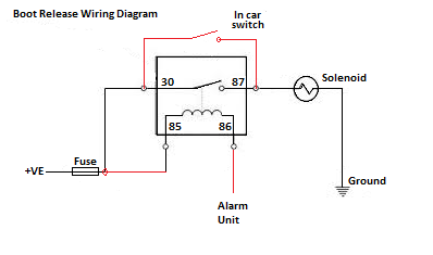

Postby novacaine » Tue 24.06.2014, 08:07
Look much nicer! But I guess for the toad system this is wrong, the manual says the boot release output signal pulls low (to ground).
Not a clue where to start with that, time for some research after work I think.

Good point Maz, thanks for that, what would we do without LEC? :D
I spoke to the technical department at Scorpion and they confirmed that the blue/black boot release wire goes to ground. So the diagram should look something like this:
Boot release.png (16.42 KiB) Viewed 11706 times

Would that not send a 12v shot to the alarm unit? or will the electromagnet lower current enough?
novacaine
Posts: 428
Postby Brit-Car-Nut » Tue 24.06.2014, 17:45
No. The alarm is feeding the pull-on coil in the relay. Cliff's circuit is bypassing the switch part of the relay.
Terminals 85 and 86 are always windings while 30 is always power and 87 and 87a (where used) are switched circuits from terminal 30. I believe 87 is normally open while 87a is normally closed.
Postby cliff » Tue 24.06.2014, 18:37
As John says, 12v is waiting at pin 85 for something to happen. In this case it will be the ground (or earth) on pin 86 coming from the alarm unit, nothing will happen until that ground is present. When the button on the fob is pressed, the alarm unit supplies the ground, the relay solenoid will then close the contacts 30/87 which will in turn operate the boot opening solenoid.
Exactly the same with the 12v waiting on one side of the in car switch. Operating the switch supplies 12v to the boot opening solenoid, the difference is that the ground is already there.
By the way this is only for the Toad AI606 system, other alarm systems may use different logic.

Postby novacaine » Tue 24.06.2014, 18:54
That makes sense. I know what I'm doing Saturday I have a i606 so should be good for me. Cheers for the help

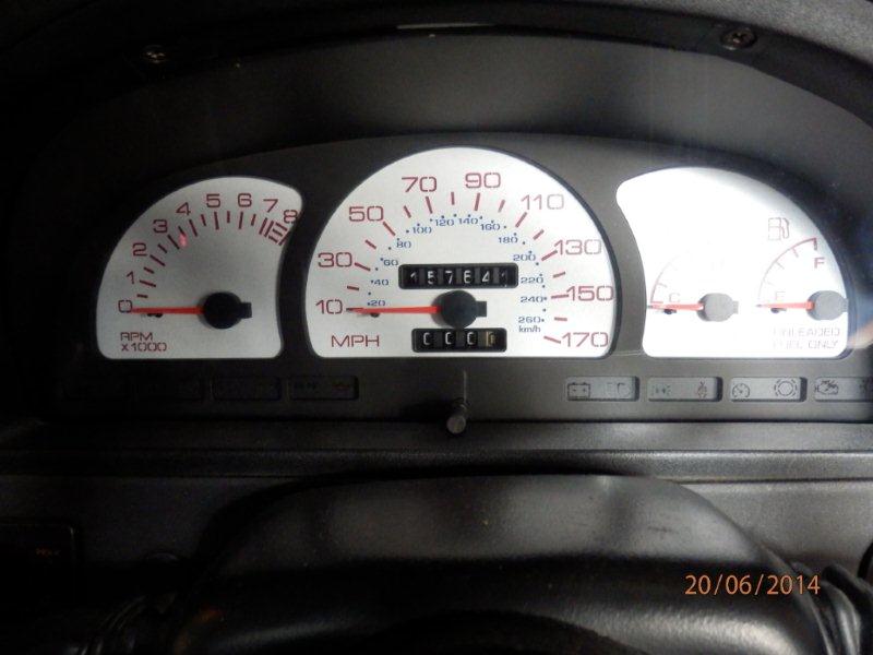

I really like my metal monkey dial faces but I wasn't happy with the look of the white warning lights so I left the originals in place.
viewtopic.php?f=39&t=11457&hilit=metal+monkey&start=100
I asked Naomi at MM if they would make me a set with a black background but with a slight modification.
For me, it looks much neater than before.
Can anyone spot the change for a (hopefully) future modification?
