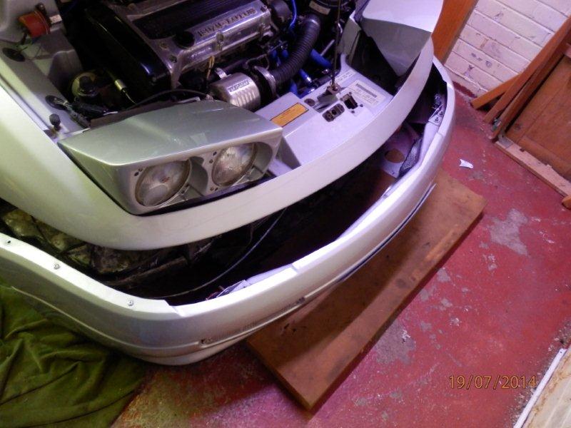

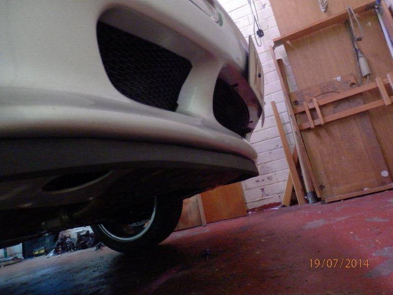

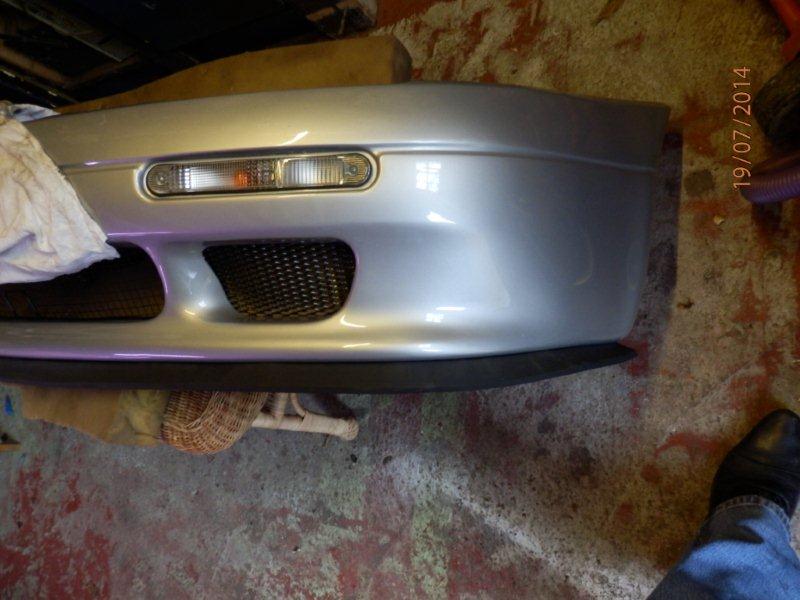

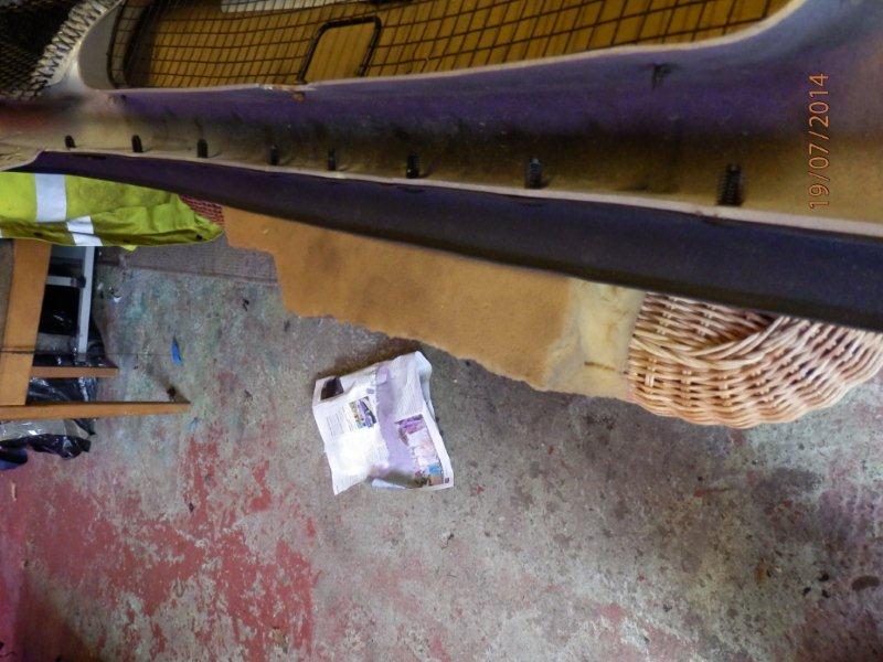

Need to fit new grills so it's bumper off time.
Quite easy really, 4 nuts at the crash structure, 2 height adjustment brackets and 2 13mm bolts at each cooler duct.
New grills shaped and fastened with sealant, the centre one is original Lotus so I left it in place. At the same time I fitted a new universal Rhino Lip as mentioned by Novacaine in his thread. This is held on with fir tree fasteners, they were supplied but I had to go up a size to fit the existing holes.
Bumper back on and looking good.

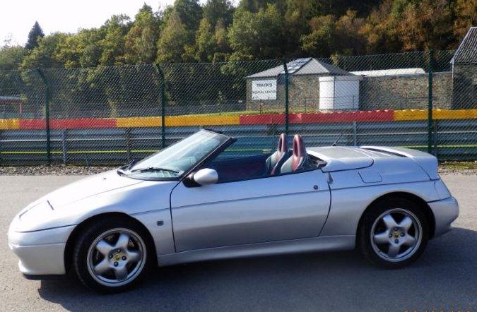

Drove to Frankfurt on Sunday through some horrendous weather, storms coming down the A1, torrential rain trying to get through the Blackwall tunnel but the hood kept me dry. A few drips here and there but on the whole, pretty good.

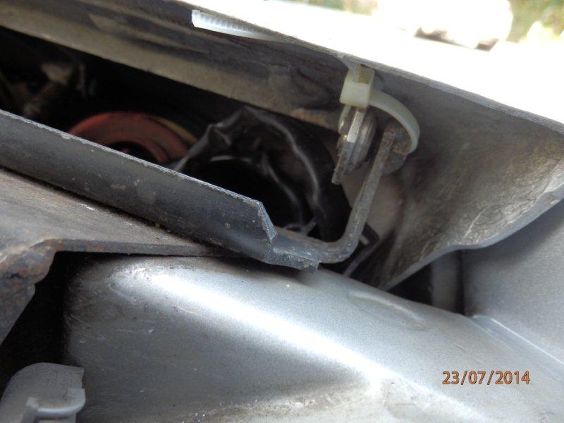

XIL drove beautifully, the only problem I had was when one of the headlight pivot bolts decided it wanted to stay in England. One tywrap later and good for another 350 miles. Now replaced with an M6 x 16 cap screw.

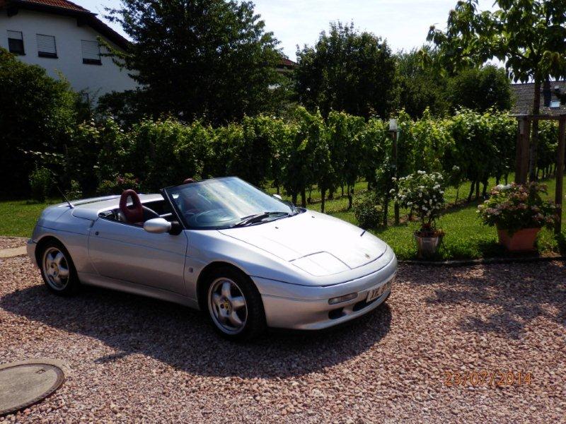

Lots of cruising around with the top down, this is on the Rhein ferry from Nierstein with a boot full of wine from my favourite Weingut (Vinyard). :cheers:

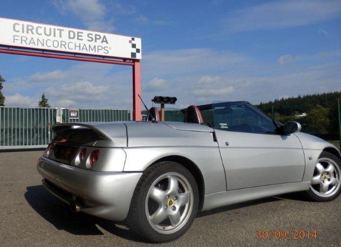

I have been using the Elan as my daily driver in Europe for the last three months. She has taken everything in her stride including the monthly trips from Tongeren in Belgium to Gross Gerau (near Frankfurt). This is 200 miles of motorway with lots of unrestricted sections, noisy but fun. :D
Apart from ripping off the front lip in a multi storey car park, the only problem has been the weather.
Had some sun on Tuesday so had a run out.
The E25 on the way to.
I have never been Belgium's biggest fan but the scenery and the area around Spa is beautiful, I did over 100 miles just cruising around.
There are some public driving days coming up and I am seriously tempted.
http://www.spa-francorchamps.be/en/trac ... rience.php
However she has started using a bit of water and there are some oily deposits in the water bottle, nothing on the oil filler cap yet but I have a feeling that HGF is not far away.

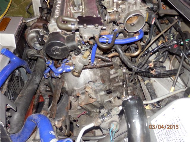

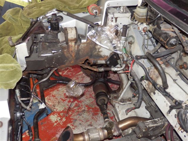

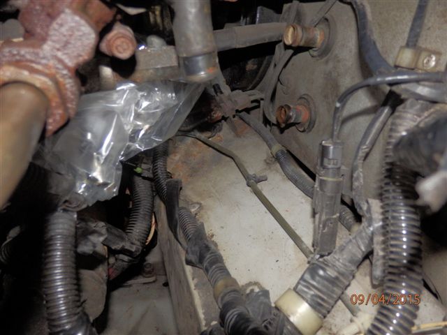

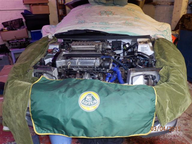

Postby cliff » Sat 04.04.2015, 19:37
There is an Elan under here somewhere.

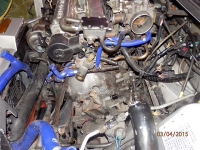

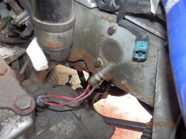

Bonnet off and light pods out. Not needed for engine removal but one of my motors has gone so might as well tidy up everything and replace the broken captive nuts so I can finally adjust the pod gaps.

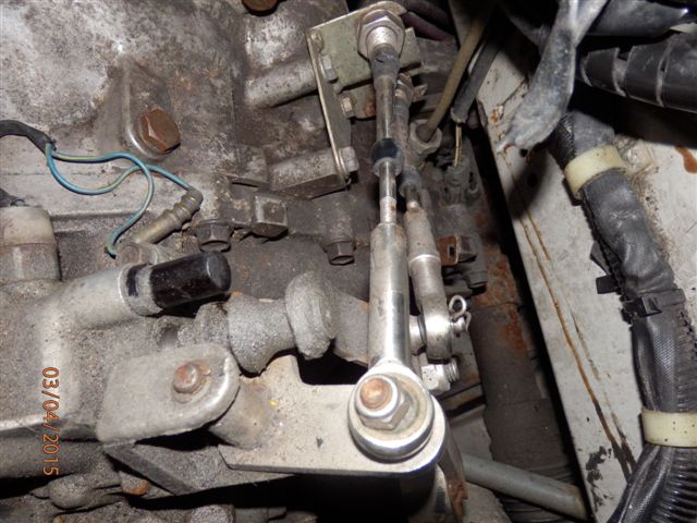

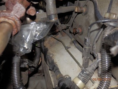

Started disconnecting.
There is another switch near the clutch cable mounting, shorted out with a green cable. Anyone know what it is for?

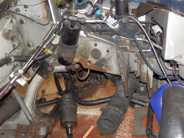

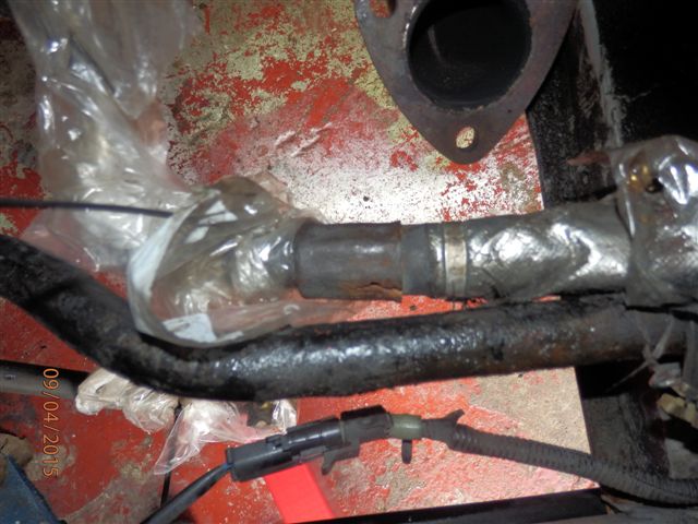

Postby cliff » Fri 10.04.2015, 12:03
Beware project creep.
Corrosion.
Split crimp on the ac pipe.

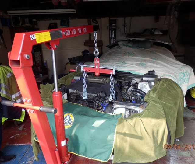

The engine should have been out and stripped but having flu put a stop to that. Just the mounts to go when I get back next month though.
On the plus side if anyone in N.Lincolnshire or N. Yorkshire need to borrow an engine crane, drop me a pm.

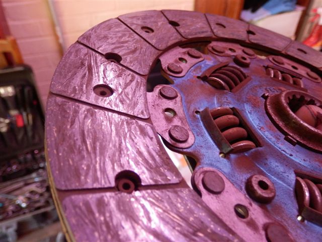

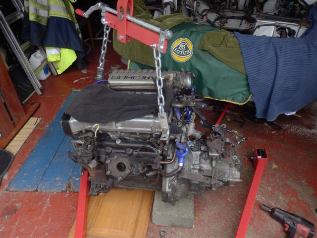

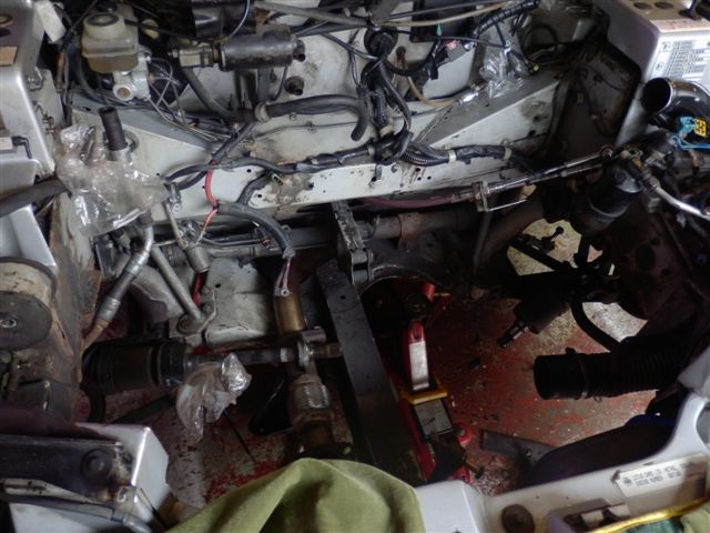

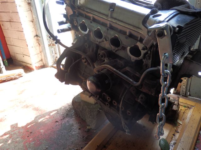

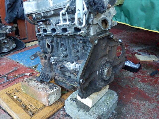

Postby cliff » Tue 05.05.2015, 20:33

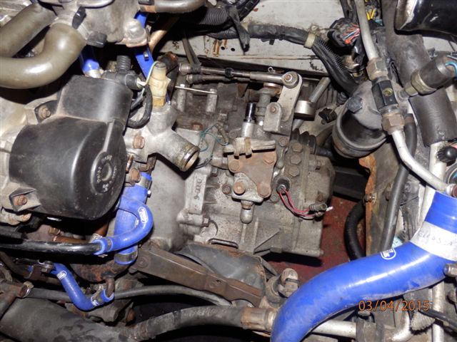

Finally out.

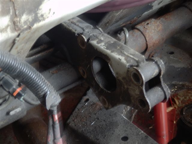

Quite straight forward except for the rear mount. There is very little information about this type either in the service manual or on LEC.

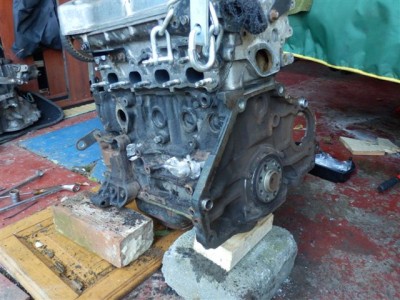

5 Bolts secure this thing to the engine/gearbox. The forward 2 are 19mm bolts which go into the engine, with a breaker bar and 3 12" extensions they can be reached from the RH wheel arch. The center bolt is 17mm and goes into the gearbox, again, reached from the RH wheel arch. The rear 2 are 17mm bolts with a 17mm nut on the lower and 16mm nut on the upper. The lower bolt can be reached from the RH wheel arch and can be removed using a ground down 17mm ring spanner. A spanner on the 17mm bolt and the upper nut can be removed from the LH wheel arch. In hindsight, I would have removed these first but you live and learn. :banghead:
Gearbox off.
The clutch plate is quite worn and it would have been false economy not to replace it. There are also some odd wear marks, although I have not had any problems with the clutch, only worn synchromesh into third.
Usual dirt and corrosion, this will all be sorted along with replacing AC and oil hoses, treating the rust, painting etc, the usual project creep.
During the removal, I managed to crush the jackshaft flange. I will try to dress it out but I do have a spare if I need it.

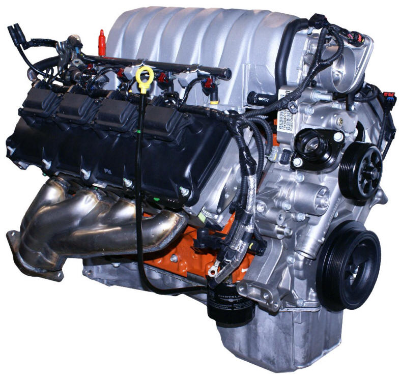

Jamie N wrote:I think if it was me at that point there i would be fitting something else back in that space :D .
Would love to but I don't think this will fit.
http://www.bpeusa.com/BPE440ENGINESRT8.asp
Fits the Cherokee though. 8)

Postby cliff » Wed 06.05.2015, 15:56
Will bear that in mind, thanks Simon.

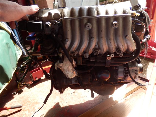

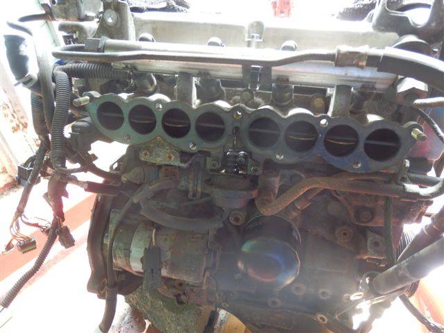

Intake removal - how that is done with the engine in place I have no idea.
Off finally, seriously over complicated!
Manifold off

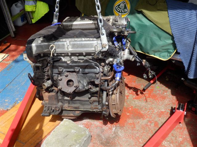

Flywheel & exhaust manifold gone. Almost time for the head.

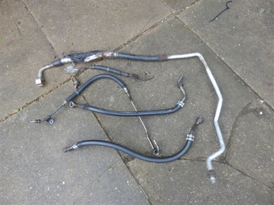

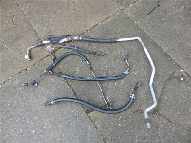

AC, oil and engine fuel pipes ready to go for refurbishment.

cliff wrote:Intake removal - how that is done with the engine in place I have no idea.
Having just done it, I can vouch for it being possible, and I did take the time to write it up... When I have got all the photos together I will have a go at transferring it to the Wiki. See here in the interim: http://www.abs-zero.com/how-to-guides/h ... -manifold/
