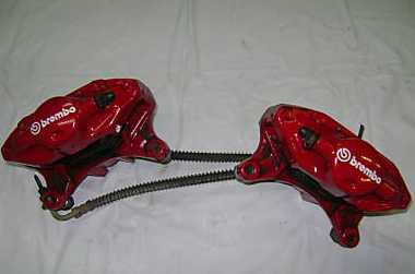

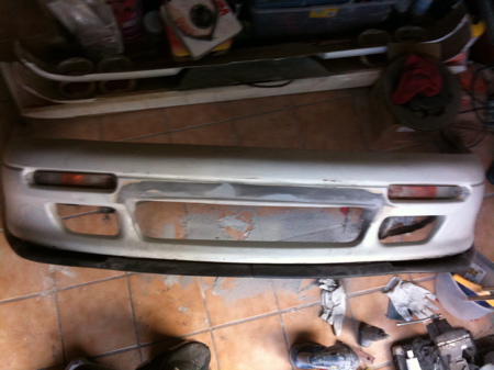

The new shifter cables are in during my brief time in SF. I also managed to pick up my new rear calipers for my custom rear big brake upgrade. All this and a brief bit of glassfibre work on the rear valance. Rear big brake upgrade to come after the valance are done. E-brake to be a second spot caliper on the off side of the disc.

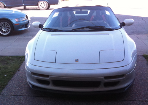

Between flying, fibre glassing, sanding rear valance, cleaning house and shop along with countless other projects I managed to do this...
Simple, unobtrusive, agressive and very effective.
Openning up the centre mouth to allow better cooling and to make the front end more fitting

Marie, are you using fibreglass to shape the front end? If so, how are you getting it to adhere to the plastic bumper skin? Thanks!
Re: LGM Elan
Postby lotusgirlmarie » Thu 29.10.2009, 21:46
Nope. Liquid urethane and catalyst. It's a bumper repair compound to fix tears and holes in urethane bumpers when plastic welding doesn't work. It's for thermoset urethane materials.

Ahh. Is it somethign that's formable then? I ask because I'm contemplating some changes to the rear bumper skin (reshaping, etc.) and doing it with fibreglass is problematic as you would already know.
Re: LGM Elan
Postby lotusgirlmarie » Thu 29.10.2009, 22:58
Kinda. It's easily sandable but it needs backing to have shape.
