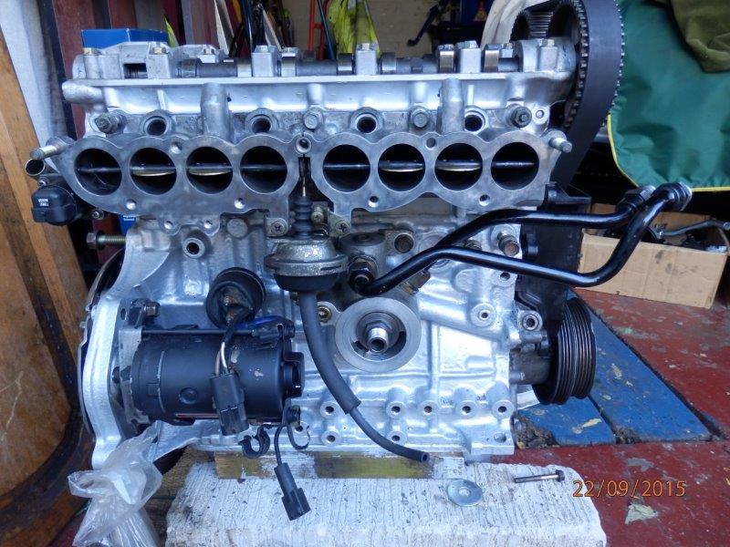

A little further.

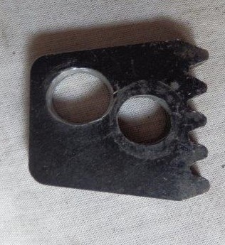

Turns out the teeth on the Elan flywheel are almost the same as an Alfa Romeo twinspark. I do have to admit that I got the initial hole a bit wrong but that is why dremels were invented, so slight modification of the Alfa locking tool later.
A couple of washers and a gearbox bolt, just needs tightening to lock the flywheel. The Alfa tool comes with a nice spacer but I didn't want to cut that down.

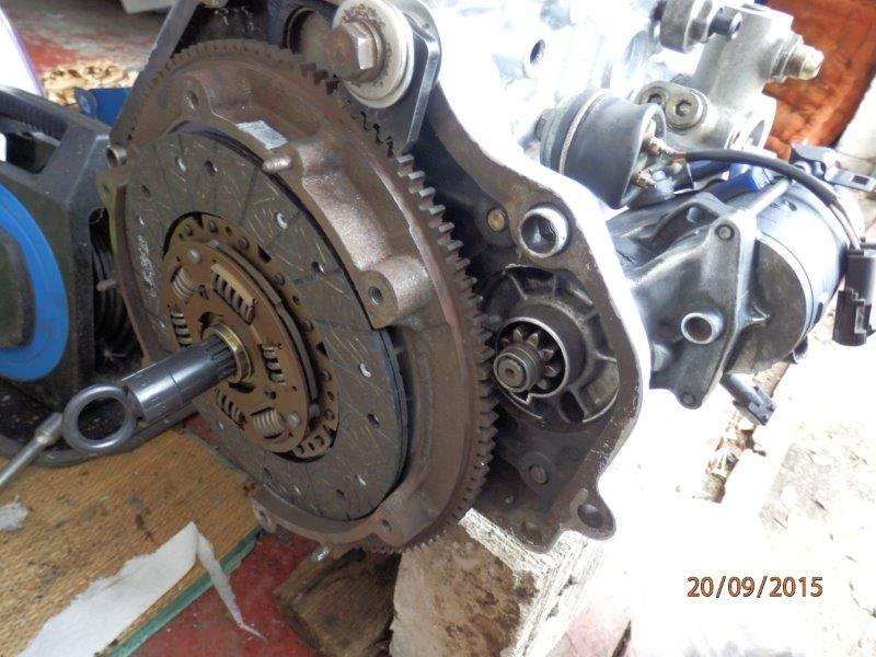

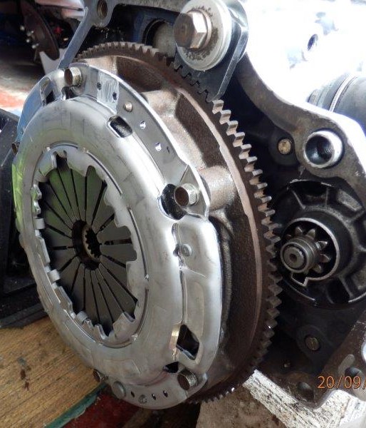

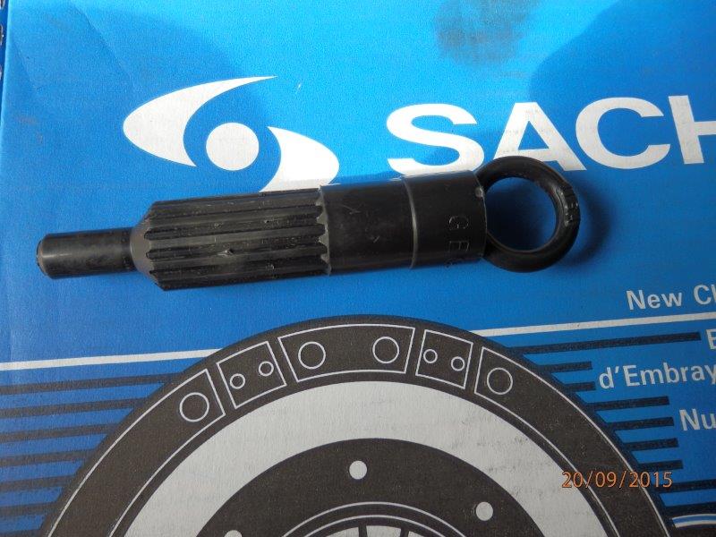

The Sachs clutch kit even came with an alignment tool although the friction plate was wrapped in a Valeo bag. As Valeo clutches are OEM for Alfa's, I am not too unhappy about that.
With the flywheel locked, torquing and fitting the pressure plate was easy. The white mark is to align the flywheel and pressure plate to their balanced positions. I don't think this will make much difference but as the flywheel had to be skimmed anyway, worth a go.

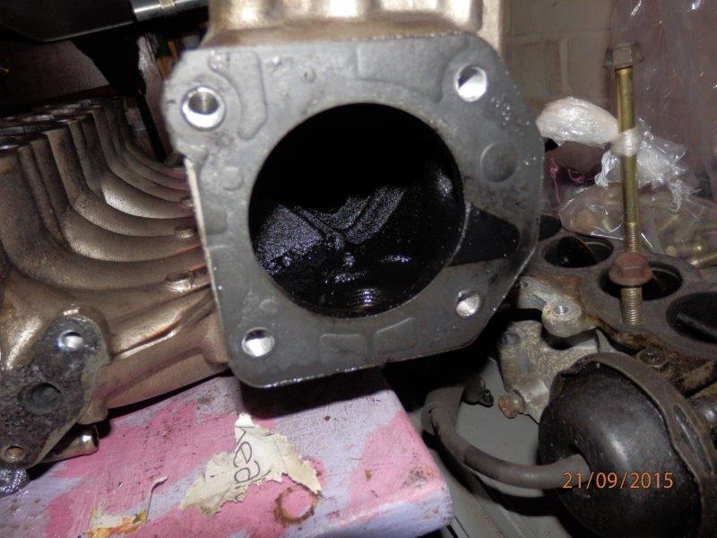

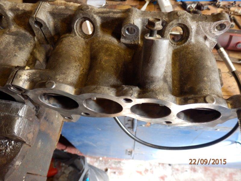

The inside of the plenum is a mess, left soaking in gunk overnight before some serious cleaning tomorrow.

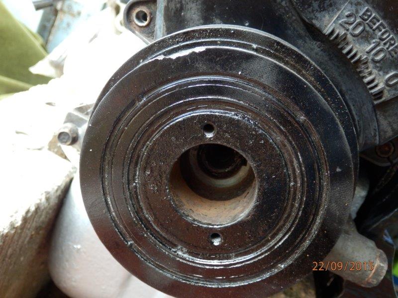

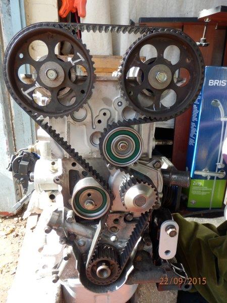

Timing belt fitted, had a problem trying to get the marks lined up after tensioning the belt. Aamir's write up on Isuzu zone mentioned rotating the crank one tooth in the opposite direction then re-tension. Worked a treat.
http://www.kact.co.uk/lec/replacing_timing_belt.pdf
Then disaster, the pulley slipped out of my hands.
Something else I need to buy. :banghead:

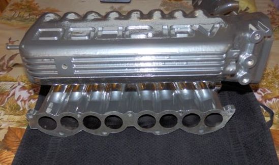

Manifold and other bits fitted, starting to look more like an engine, plenum and cam cover have gone for powder coating.

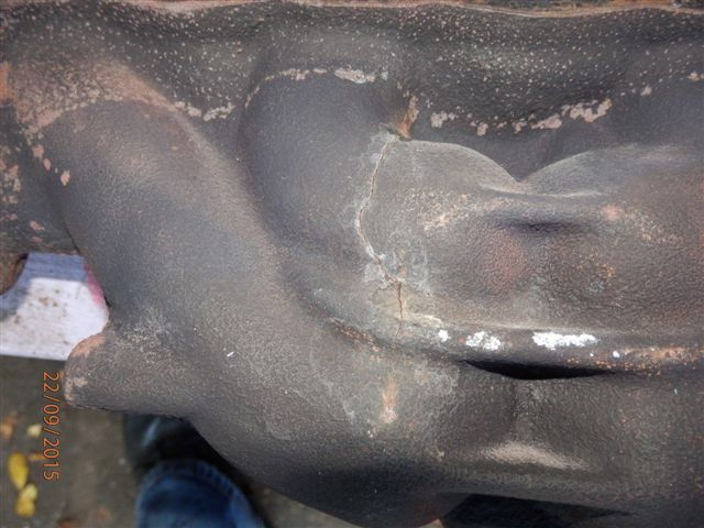

Postby cliff » Fri 23.10.2015, 19:22

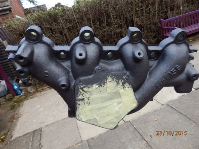

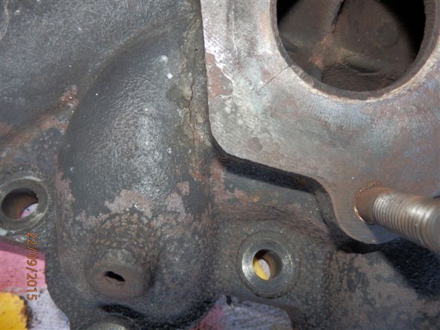

More project creep. The exhaust manifold is cracked, not unusual but the one at the rear is too much.
Out of curiosity, I called a couple of companies specialising in cast iron weld repairs, after a quote of over £300, found one on ebay for a very good price. After blasting and a coat of POR 15 manifold grey, hung it out to dry.

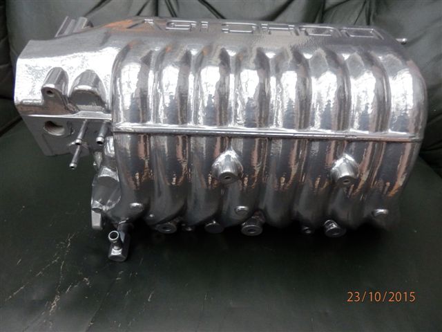

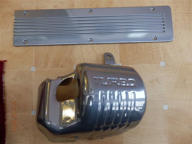

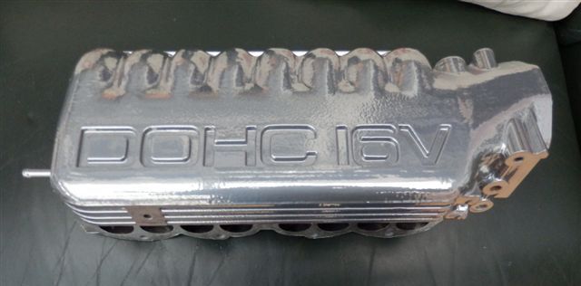

Had a couple of bits back from powder coating.
Not clear from the picture, but done in the same colour as this.
Almost too nice to fit. Thanks to Steven at Frears Wheels in Scunthorpe, beautiful work, really looking forward to seeing the cam cover..

I'd be interested to know how the Turbo heat shield powder coating copes with the heat. Was it a special high silicone content powder or just a normal one? I was told normal powder coating wouldn't be able to cope with the heat on the heat shield.
Andy
I had the heat shield powder coated a couple of years ago and have had no problems. I only had it re-done as I wanted it to match the plenum and spark plug cover. Yeh, I know. 8)

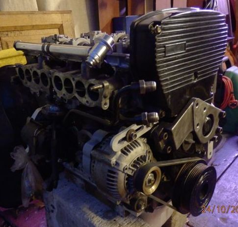

Postby cliff » Sat 24.10.2015, 19:10

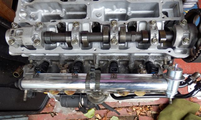

I finally had time to collect my gearbox from Alan Voigt in Wallasey. Third gear synchro and drive shaft seals replaced, the rest was in good condition. Thanks guys.
This bit of the build always seems to take ages, finding stuff and poring through the myriad of pictures to see where it goes.

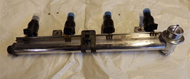

Injector rail cleaned up nicely with a bit of Autosol.
Injectors and pressure regulator replaced with parts from Rock Auto.

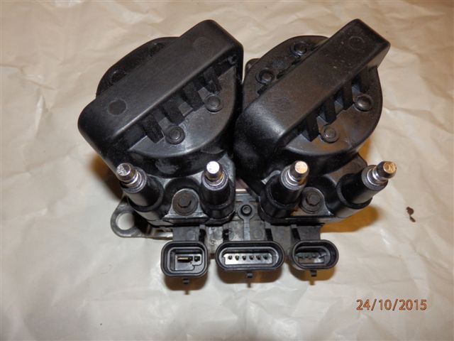

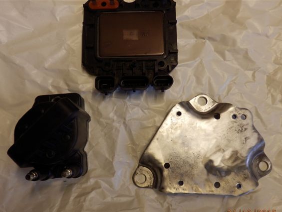

Coil packs replaced, this requires a 5.5mm socket. The back plates were quite corroded but cleaned up nicely, there were new seals in the box so it was silly not to replace them.
All done
Some progress.

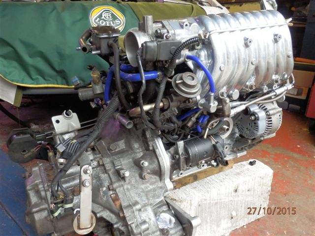

Postby cliff » Mon 26.10.2015, 20:58

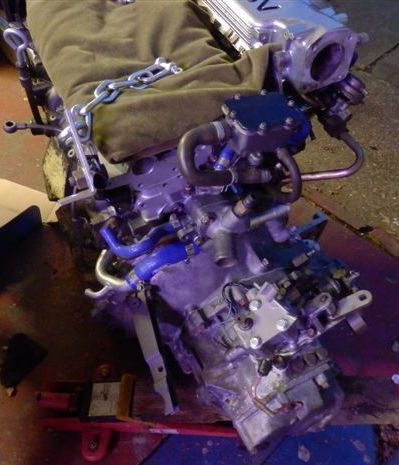

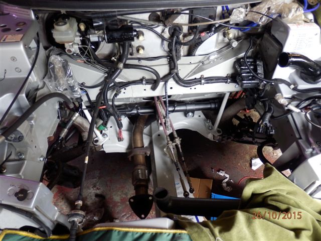

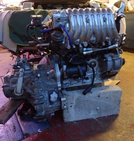

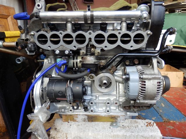

Tangible progress today, power steering pipes. mounting and coil packs fitted. Engine bay almost ready.
Nice view of the secondary throttle reservoir & solenoid valve, vacuum hoses replaced as well.
Plenum and gearbox fitted.
A few little things to sort out but almost ready for refit.

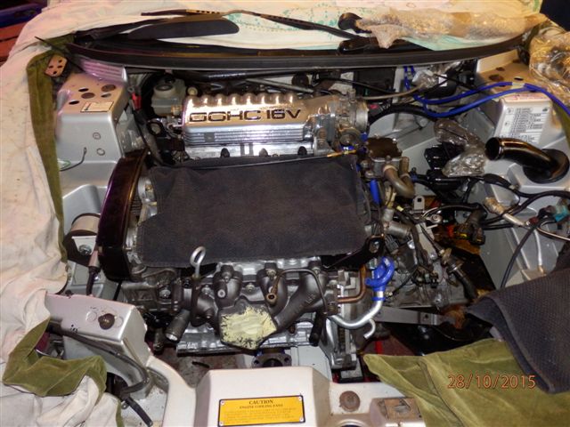

Postby cliff » Wed 28.10.2015, 12:48

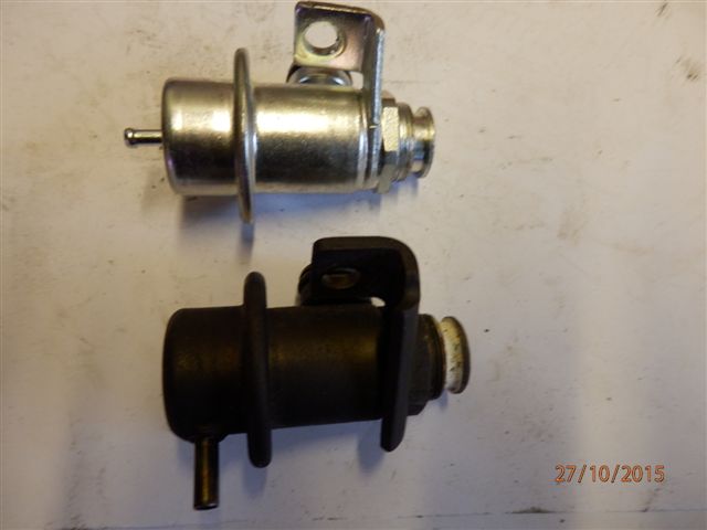

Word of advice, fit the engine wiring loom before the plenum.
The new fuel pressure regulator PR92T has a straight connector for the manifold pressure pipe, this will not clear the forward engine hanger. The old one was working fine so I have refitted it for now.
It's in. :D
Fiddly but straight forward except for the forward gearbox mount. If I could have got my hands on the designer this morning, he would be walking funny for a while - there would not have been any lube involved. :twisted: :banghead: Who specifies 3 shims and 2 extra plates ffs! Basic rule of design, keep it simple.
Work tonight so that's it for now, there is definitely light at the end of the tunnel.
