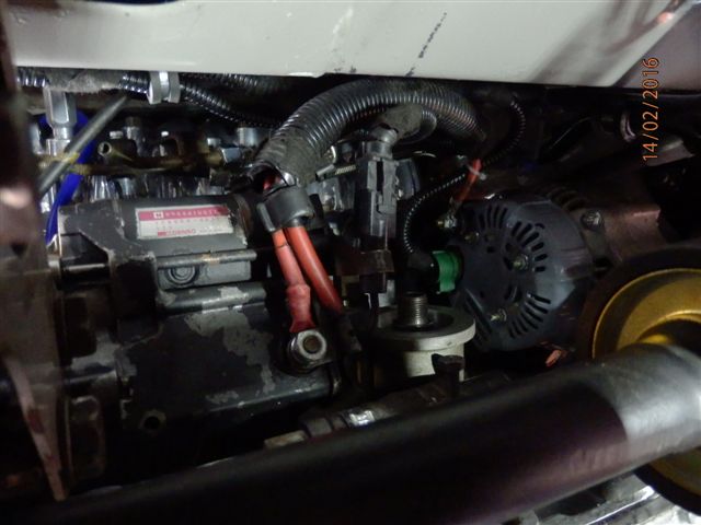

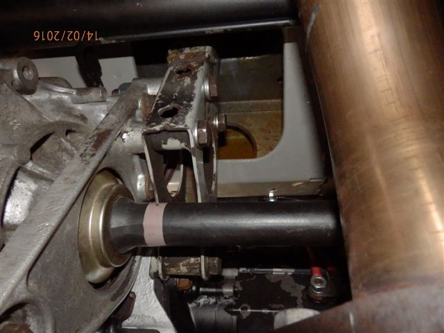

Don't fit the engine hoping that you can fit the lower transmission cover. So, progeron off again.
Makes it much easier to access the rear engine mount and connect the alternator and starter motor. In hindsight, I would drop it just for that. Some split conduit makes the whole wiring loom much neater and more professional looking.
New jackshaft fitted.
Driveshafts fitted and suspension going back together. Can see the light.

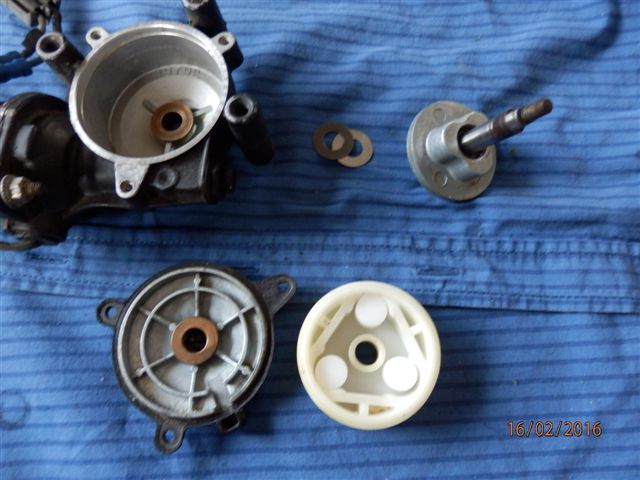

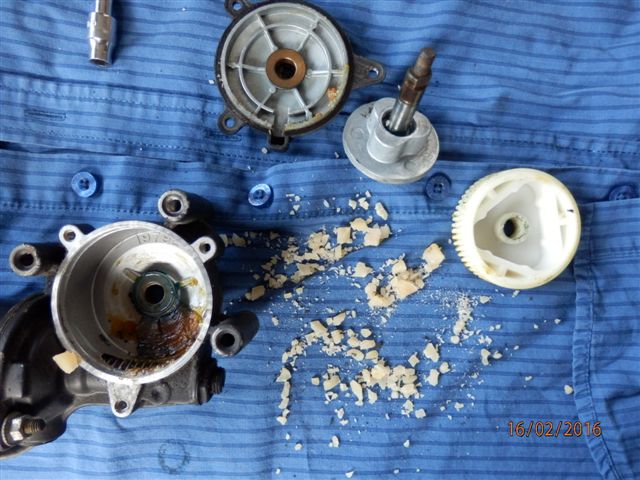

Re: XIL - A Rolling Project
Postby cliff » Tue 16.02.2016, 22:05
Spent 2 hours fruitlessly looking for some decent gearbox oil, thought this would be a quick trip to the local motor factors. I don't see many forums recommending Comma or Halfrauds own brand! :banghead: Guess I will order it online for my next visit.
I must be getting to used to warmer climates, it was very cold here today, so gave up on the garage and rebuilt the headlight motors instead. Well documented and quite easy, three small bolts.
Quite obvious why the headlight wouldn't pop up.
Mess removed, cleaned ready to be re-greased and put back together.

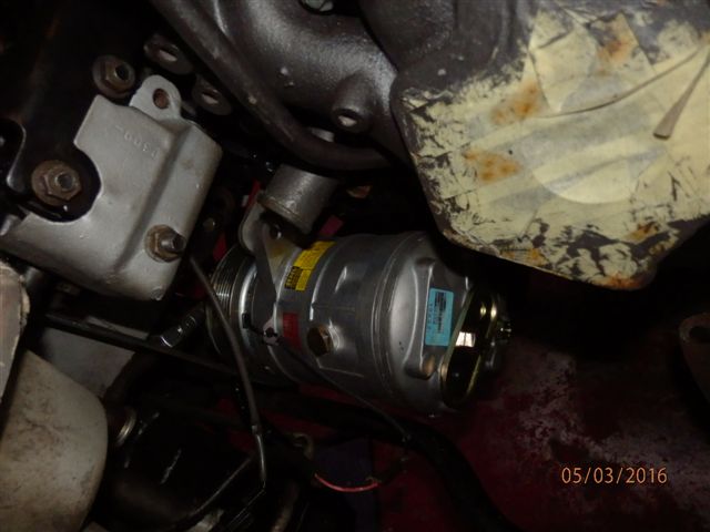

Postby cliff » Sat 05.03.2016, 20:53

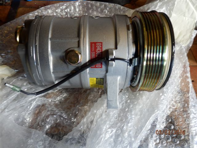

Compressortech told me the clutch on my AC compressor was worn beyond repair, they can normally repair most of them but had no parts for this one. Steve went out of his way to find out where I could buy a secondhand one but luckily Lotus have them on the aftersales list.
A nice shiny new compressor.

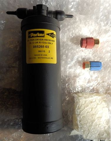

They also had dryers in stock (pretty good value at £25) and the adapters to convert to the later system.. The dryer fitted to the Elan is used on many classic cars with ac including Aston Martins & E types.
http://www.compressortech.co.uk/index.html

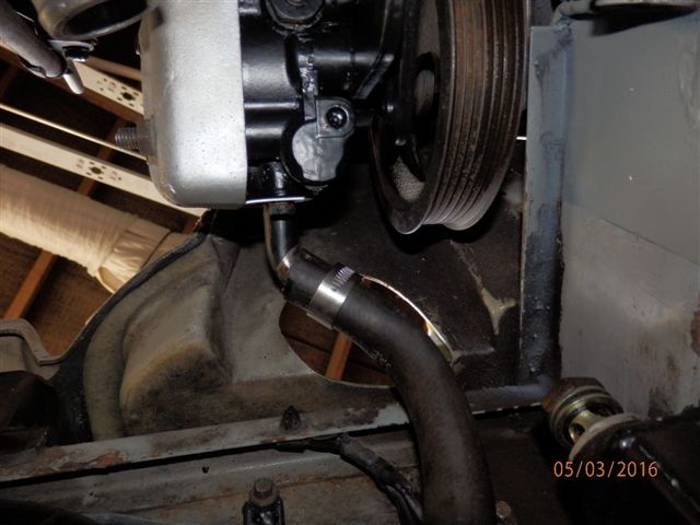

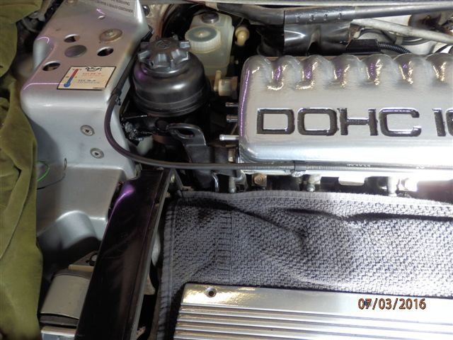

Power steering pump refitted. This pic shows the low pressure connection usually accessed through an opening below the RH light pod.
Compressor installed & belts tightened.

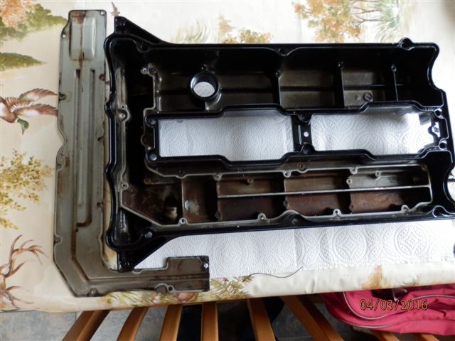

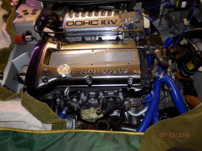

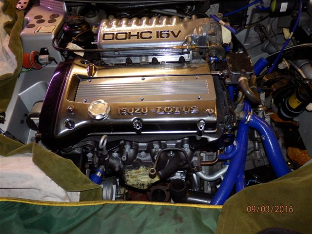

After having the cam cover powder coated, it was time to remove the baffle and clean everything out, quite easy but I would recommend using a pillar drill and a good cobalt bit. There was quite a bit of old oil and blasting residue in there, well worth doing. Cleaned and waiting to have the holes tapped and cover refitted.

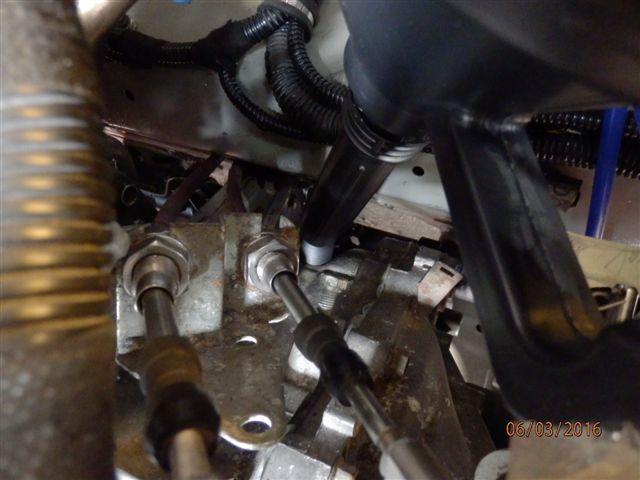

Postby cliff » Mon 07.03.2016, 21:07

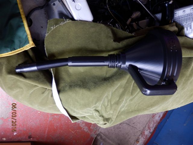

Time to fill up the gearbox so bought this.
Almost made for the job.

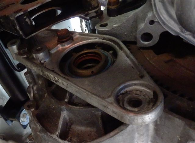

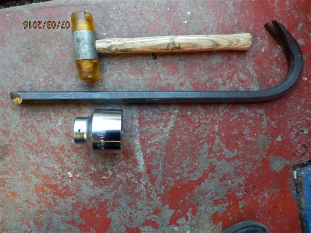

Unfortunately the LH drive shaft seal was leaking, maybe I damaged it when I fitted the shaft. Called Alan Voigt and he told me they use the seals from a Vauxhall Insignia M62 six speed gearbox, GM 12755013. The local GM dealer had one on the shelf. Not difficult to do, none of my screwdrivers were man enough to get the old one out hence the crowbar. I don't have an insertion tool but a large socket did the job.
Removal/refit tools, crowbar, hammer and 50mm socket.
Oil topped up, no leaks, speedo cable secured with the small metal plate and bolt.

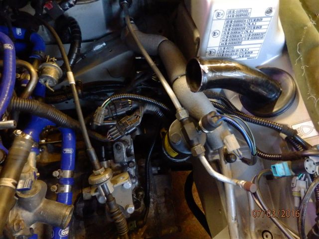

Power steering & throttle cable connected.

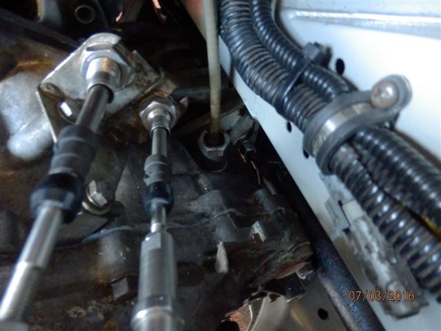

Gear cables, clutch cable, AC pipes & dryer installed, the dryer clamp was a total pita, there was more than a few remarks about the parentage of the designer of that particular item.
Getting there slowly

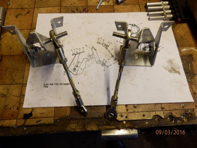

Postby cliff » Wed 09.03.2016, 21:37
Get a pile of bits.
and put them together.

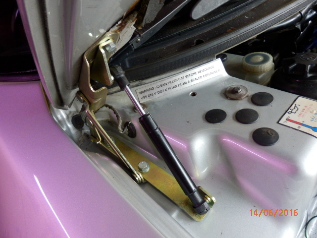

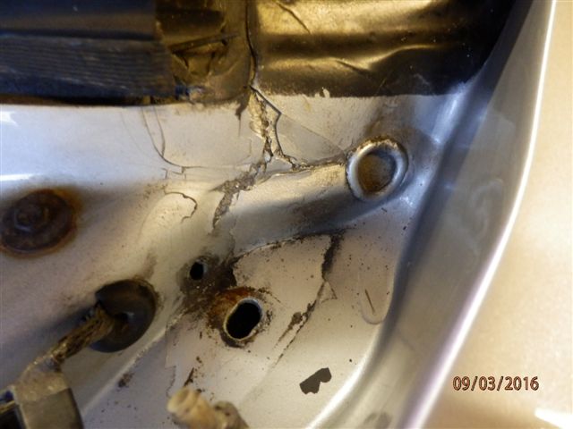

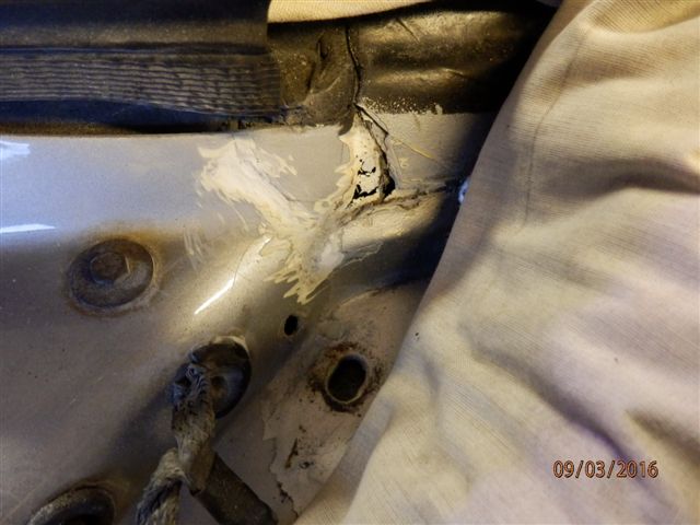

Decided at long last to replace the bonnet hinges and fit the gas struts but found a little crack.
Cleaning it up a little shows a previous repair. Nothing some fibre glass won't sort out, there has been so much project creep already, what's a little more?
Brakes and suspension back together, engine mostly connected. Need a new reversing light switch so will leave the intake pipes off for now. That's it for a few weeks but couldn't resist a quick try to see how it looks.
I think it is only when it comes to the rebuild that you realise how much has actually been taken apart. I was hoping to have it 99% done this week but there is always something else to be done. Am getting there though.

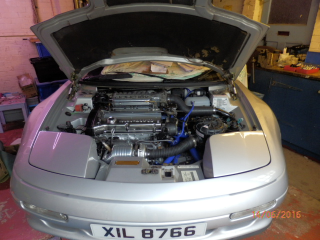

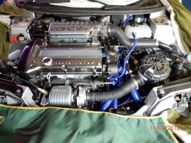

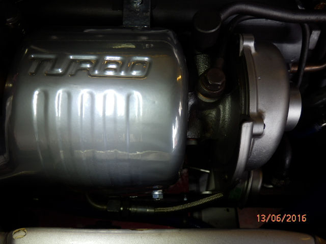

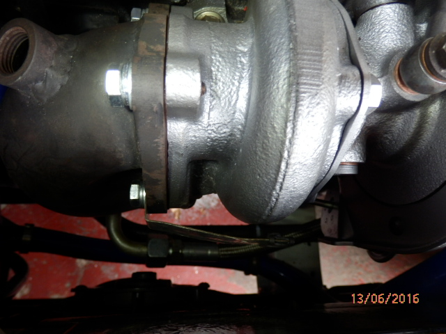

Postby cliff » Tue 14.06.2016, 09:31
Finally managed a few days in the UK.

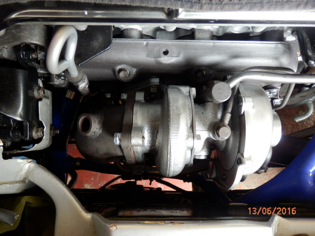

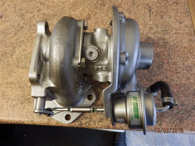

Turbo rebuilt with a new aluminium billet compressor and ported by CR Turbos (Universal Turbos).

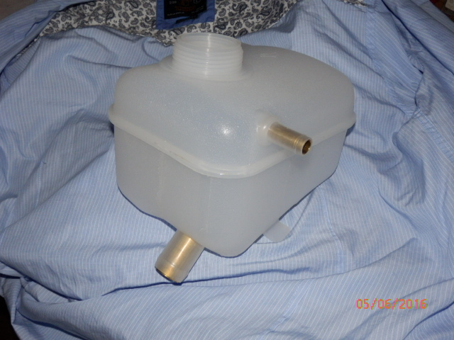

Nice new header tank. Thanks Wayne.
Turbo and downpipe fitted.

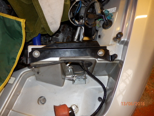

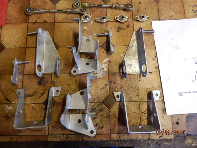

As there have been a few discussion about this, a picture of the bracket I made to support the lower part of the heatshield. To make it easier to fit, use a captive nut.
Fitted.

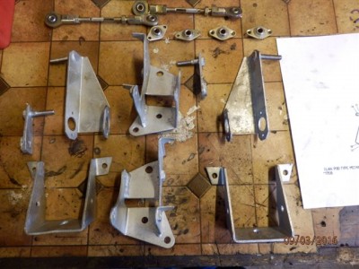

Light parts powder coated and galvanised, fitted waiting for the pods.

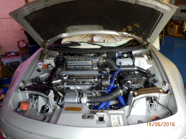

Very productive day.
The intake pipes will be going soon.
New hinges and gas struts fitted.
Looking better, apart from the bonnet liner.
Light pods back on and looking more like a car for the first time in over a year. Pretty much done, brake bleeding and fluids to go. This has to wait as back to work tomorrow.
Postby par » Tue 14.06.2016, 23:49
Looking very clean. Rocker cover looks very nice has it been polished?
I thought you had gone for a metallic purple accent on the cambelt but I think it is just the lighting from your sunbed making it appear purple :D
par
Posts: 572
Joined: Thu 19.02.2015, 23:22
Location: Fife
Postby cliff » Wed 15.06.2016, 09:23
par wrote:Looking very clean. Rocker cover looks very nice has it been polished?
Thanks, the rocker cover was powder coated in Shadow Chrome by a local company in Scunthorpe.
Didn't notice the purple, one of the fluorescent tubes is an odd colour though.
