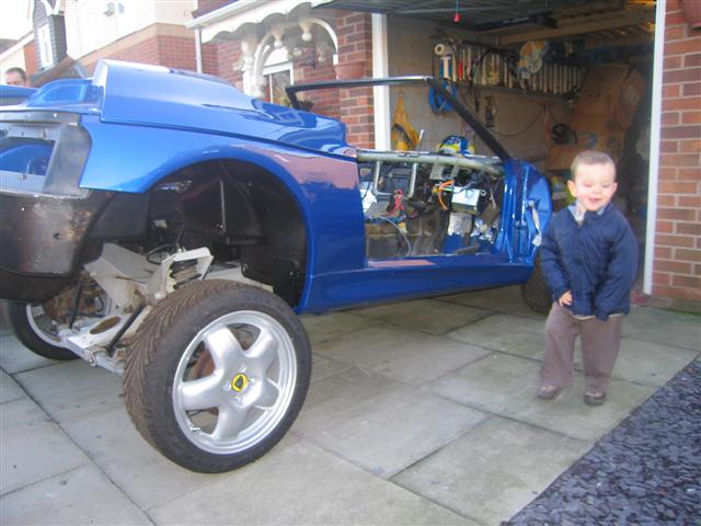

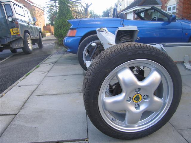

Postby Dico » Mon 30.10.2006, 21:39
Found some uprated shockers on a landrover website, thought i'd give them a go -
Elan offroader!
IMG_2129 (Small).JPG (53.59 KiB) Viewed 80063 times
S2 wheel changeover
IMG_2147 (Small).JPG (57.41 KiB) Viewed 80065 times
Postby Monty » Mon 30.10.2006, 22:09
Got to be Fed-spec dampers :-D
Postby Doug » Mon 30.10.2006, 22:12
I think it looks like he's dancing to the thumping music that that Elan's hydraulic suspension is dancing to . . .
