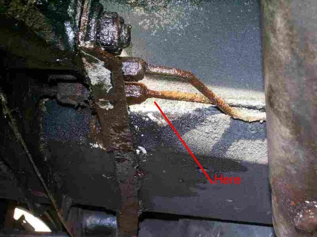

Just found the brake problem to be a ruptured pipe.
The rear of the two pipes in the middle of the pic is squirting fluid upwards.
Just to give you an idea of where you are looking in the pic:- I have taken it by removing off the off-side rear wheel. You can just about see the other rear wheel in the bottom left.
Nobody told me that owning an 18-year old car was easy!
(27.29 KiB) Downloaded 116 times

Postby paza1 » Sat 07.06.2008, 12:15
Wow, glad you are OK. Those look in a bad way. Are you going to replace both pipes? If so, will you replace upto where they disappear into the box section or the whole run?

Postby rip » Sat 07.06.2008, 15:14
I believe that from the join, they run forward to somewhere around the engine bay.
I may as well get both done. If one has gone, the other could quite easily follow on quickly.

Postby rip » Sun 08.06.2008, 08:48
Are they the proprtioning valves on that cross-member? If so, I will probably renew those too.

Postby RayD » Sun 08.06.2008, 10:29
The proportioning valves are at the other side as you say, Rip.
With that amount of rust it's a wonder the brake pipes passed an MOT in the last 12 months. If that area of the car is typical you might have to change all the pipes to be on the safe side. :cry:

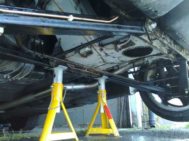

My stainless bones are in place so I thought I'd give the chassis a clean-up ready for painting with POR-15.
Clean chassis

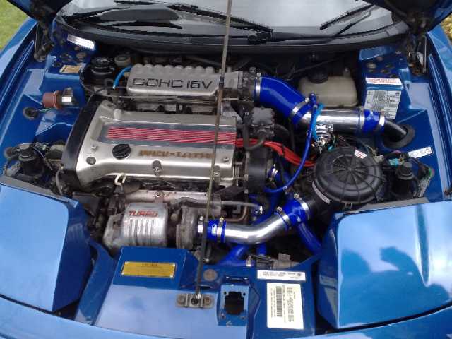

The engine bay is just about done. I was lazy when fitting the intake pipe so the jubilee clip chafed the hose which attaches to the expansion tank. I have now cut the intake hose a little shorter & will be buying a replacement Samco shortly.
Engine bay
Engine Bay.jpg (38.93 KiB) Viewed 20592 times

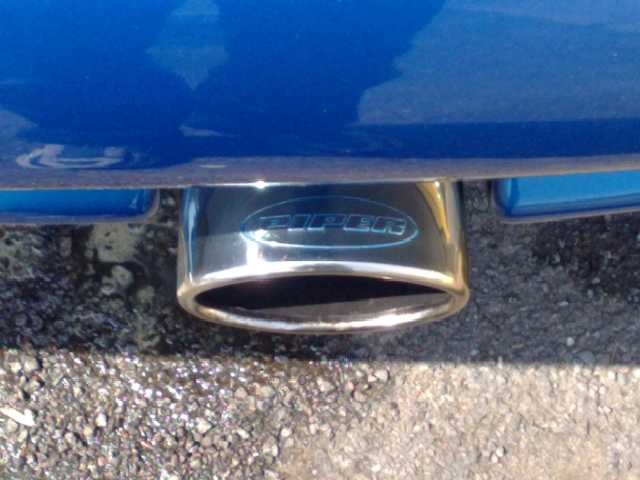

I also polished the exhaust & picked out the logo in blue paint.
