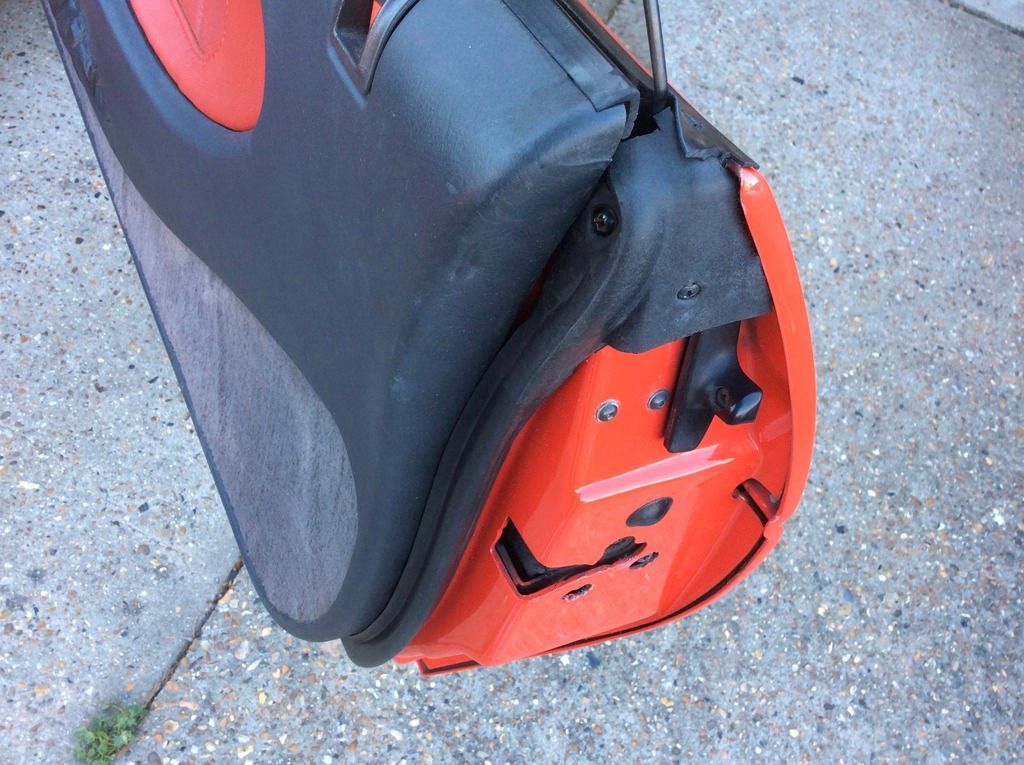

A rubber seals day, banish the sponge :wink:
Found these in my boot (how could I forget) job number (5) :roll: oh yeah and there's the bonnet liner (6) :bonk:
