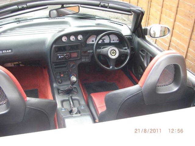

Alfa do a similar Tan leather, I had it in in my first GTV, red & tan looks superb. The same colour in a GT:

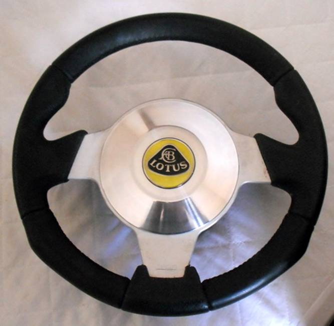

Have you thought about an Elise wheel? I think it looks better & you would only need to cover the middle section to make it look good.

hmmm. had a look about and can't see a price on an elise wheel easily, found one pic of one that had been coloured in the centre panel. i really like the wheel. i think having to leave the centre horn button in black is a shame on the elan wheel, and Elise is a better style for a two-tone wheel.
each to their own, and its a really cool wheel, but i'm guessing its a few hundred pounds and for me i don't think its worth it.
i'm wanting the look to be knowingly retro rather than to try and modernise the interior too much. trying to aim for a timeless look rather than to show up the older materials and design features by shoehorning in parts that are too modern. i'd discarded the idea of tan handgrips on the left and right section of the wheel only as its still a bit modern.
Love the leather in the Alfa. Wife reckons its a honey orange I am looking at. There are only so many colours for leather so we will see what the samples bring.

Can do the wheel centre yourself with a bit of time and patience. I did mine in alcantara which i glued on

I'm definitely passing all the leatherwork to somebody else to do for this car. As I do different projects I am picking the pieces where I can't do any real harm or cost myself money to practice techniques.
For example, I am going to remove the trim from my Audi project and wrap it in the carbon fibre type material by 3M that heatshrinks. If I rodger it up, its a cheap and small thing that I can strip and start again. Or buy new trim even.
I will however be removing the inner dash fascia from this car, and fibreglassing the breakage back together then recovering it. Either black plastidip or if I can think of a cool neutral colour that would work and look good, like a grey or dark grey, possibly a gloss spray.
For practice on that I've been working with my van projects' fairing, badges, trim and dash parts - one interesting thing I stumbled across was Tamiya polycarbonate paints for modelling. The Smoke paint works amazingly on silver/chrome plastic/tat to give an unusual gunmetal approach. Its too expensive to be worthwhile in large batches but the van I'm just finishing is going to have a black chrome/gunmetal type finish to the merc badges, AMG badges and door handles.
So I am quite confident on my indoor spraying and lacquering now (could do small items, happy to try a bumper and have one to practice on; had a mixed experience doing the van roof outside so whole vehicle work is out) and am thinking either the matt plasti-dip (except they dont make a dark grey, I need to look for a better product) or a black or dark grey gloss for the dash inner.
Its also possible I can use a light spray of this smoke paint just to add some interest to it.
But yeah, I've got a price I am happy with for seats, handbrake/gear gaiter and doors, out of which I am going to cancel the gaiters because the wife just thinks it looks awful to have the standout gaiter colour flashes. I don't 100% agree with her but I do think its a matter of personal taste; and I don't want to fling in features for the sake of it that aren't to many peoples' tastes.
The original wheel is about 20% of that cost again to cover. So the Elise wheel does seem to be a cheaper route to adding a bit of flair. But I always factor in my time as well and with my limited knowledge, and the fact I *still* can't find a price on an Elise original wheel; just finding Chinese fakes, I think I'm going to be stuck with the full wheel trim. Happily, the removal of this will be the practice job for replacing the SRS Merc wheel on the van with a colour-coded Momo I have been sitting on for a year.

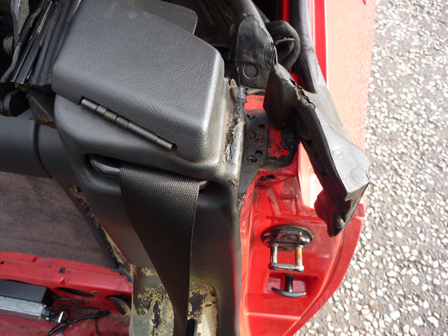

It rains, and it rains, and it rains. The van is taking up all my time anyway, I'm still going down to the spray shop daily and stripping little bits off, customising final trim, and cleaning up bits the spray won't hit. Bonus is, when it comes back, all I need to do is put a fresh coat on the calipers, and clean up the little bits of damage and paint the wheels and it will be 100% done, in and out. Which is not something you can often say about a project. Very excited. One last little hurdle which is to actually fit the spoiler perfectly.
Stuck a hand inside the cover and the foam is DRY! I am however thinking of replacing it all. I'm researching options on the sound system and am almost fixed on 2 Peerless subs behind the seats, a DLS Nordica component set in the doors which will mean some customization of the door cards, and an Image Dynamics amp perhaps as they are on closeout, or more likely, another Genesis Profile 4 - I love those amps.

I found an Elise steering wheel here: http://compare.ebay.co.uk/like/15084839 ... adtype=pla
I will post it up in the eBay thread also. For £65, plus the refinishing, I can get my existing wheel done for £175. I'm definitely sticking with that. Less messing around.

So the first part will still be waterproofing, together with further stripping of the foam, rust treatment and any strengthening or rebuilding of the sills, and finally removal of the door cards, trunk, map pocket and B-pillar carpet, to make a perspex window for the amp, the custom sub boxes, and baffles for the doors. Then I'll plaster the entire shell in Dynamat Superlite (which incidentally you can get bulk packs of for £140 just now - superbargain!), treat the rust, paint the interior because I just love the fact that under the carpet, the paintwork is pristine for no apparent good reason, and post pics when I do it all.
So its as ever going to be more destruction before the construction happens, and I won't be driving her anytime soon, but the plan is solidifying!

Jeemy wrote: I found an Elise steering wheel here: http://compare.ebay.co.uk/like/15084839 ... adtype=pla
I used an Elise air bag wheel on mine less the air bag with a cover over what used to be the air bag.

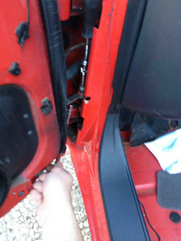

Having neglected to obtain the door lock clip surrounds, both of which are broken, I decided I might instead repair with fibreglass and then finish these and other key parts in the same anthracite grey I plan to do the wheels in (very similar to Audi centre caps, based on Oz wheels' signature style). I feel using grey is going to tone down the fading of the vinyl and such.

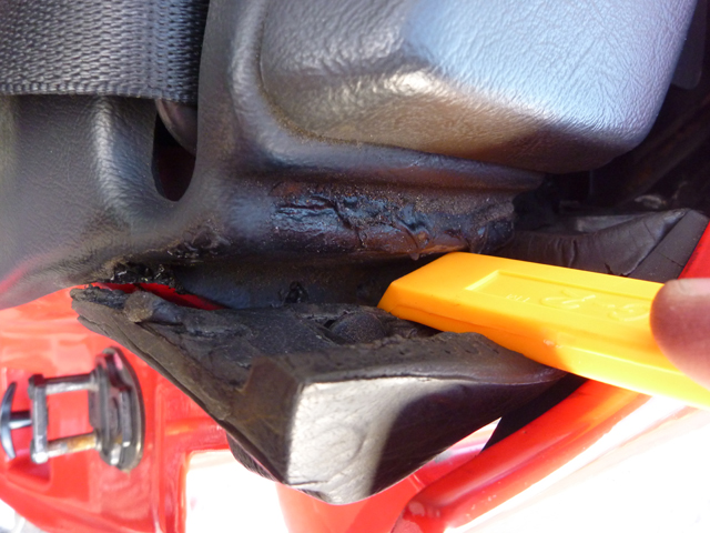

So tonight she had her first, and likely only (without the shower cap) power wash, and the ingress points of water were obvious:
- from the passenger speaker (i.e. through the weatherstrip and down the path of least resistance
- from the corner of the passenger window and B-pillar. The seal top is missing, so a rebuild in Sikaflex is likely before I go any further on cost there
- surprisingly, from the top of the drivers window at the front apex. I'll need to look at the seal there.
I used half a tub of Meguiars Hot Wheels and a scourer on the backs of the rims, as they've been getting the cover straps filthy. They felt like scrubbing the grill from Harga's House of Ribs - absolutely black. But after a snow foam and a good jetting, I reckon they'll only take 5 or 6 more cleans, haha.
So the doors will continue to get stripped as I work my way towards the outer weatherseals, which I have the vintagecarparts replacements for - doesn't look anywhere near close, but ho hum, I'll see when I get there.

So I drove the Elan back to town to get started on the bodywork prep.
First thing was to get the seats back out, which was made immeasurably easier by use of a 12" ratchet and slim 17" socket on the upper part, with a breaker bar and a standard wheel socket on the bottom; I was able to do it myself.
Bolts and cups were placed into envelopes by area, just in case there is any variance by area.
I'm still awaiting a couple of bits for the compressor, and I had to fix the exhaust, battery and stereo on my van before I had anything to drive home in, so I spent the rest of the short period of afternoon I had left working on the door, which bounces open too far with some kind of botch-job bolt rattling about in the centre retaining hinge.
Managed to get it out using a screwdriver with a universal joint extender and a mini ratchet, and I made up a new M8 bolt with rubber grommets on either side, a square bolt to perhaps give it more of a chance of locking into place, and a second bolt below it to stop it coming loose.
Hey presto - door opens satisfactorily and smoothly and doesn't bounce off the paintwork anymore! I just need to epoxy repair the small chip caused by the previous bolt rattling off the bodywork, which isn't visible when the door is closed.

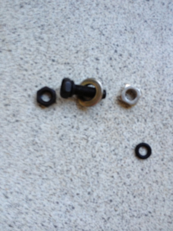

Postby Brit-Car-Nut » Thu 04.10.2012, 21:14
Jeemy wrote:So I drove the Elan back to town to get started on the bodywork prep.
Jeemy: it is supposed to be a tapered pin: A100B6020F which is now obsolete, but you could use two flat washers and a clevis pin with a "P" linkage clip instead of a cotter pin.
Definitely easier to install or remove than a bolt and nut.
Re: Jeemy's Elan Rebuild
Postby Jeemy » Tue 09.10.2012, 19:41
Cheers John, both sides have a bolt, and I just assumed that was the correct item. Obviously I didn't check the manuals, lol. That makes a lot more sense, even though its currently gibberish to me, I'll look it up and get the correct fitments.

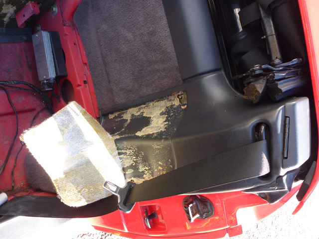

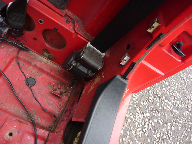

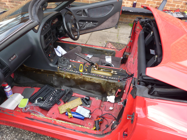

The last 3 days have been busy, so I am proud to show the first real progress on the Elan.
*Outriggers (Interior)*
Today was a good day. Sunshine, little wind (otherwise I'd have been windsurfing anyway!, and my red Samco hoses arrived!
I'd hoped to get the rust treatment completely done but it took a little longer than anticipated to strip the vehicle.

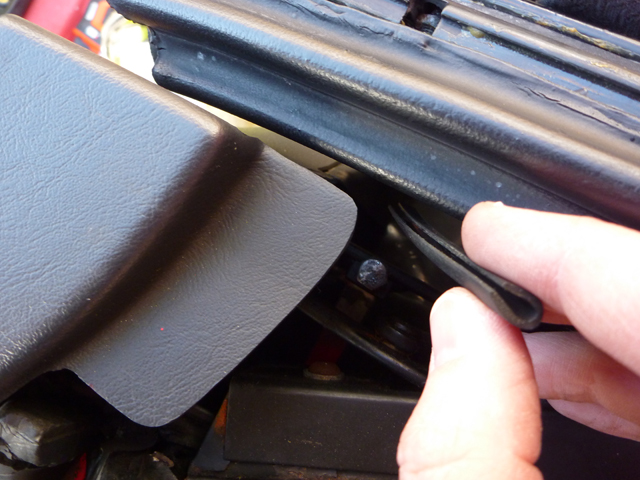

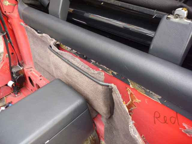

First step was to get the B pillar covers off. This proved trickier than it looked.
I started by pulling away the carpet to expose the screws.
I noticed there was a little vanity cover so I removed it and filed it (I am already up to over 50 plastic labelled bags of fittings. Sadly, its missing from the other side.
So far so good, but then the top screw, had no head left, and just spun.
Once I worked out by going to the other side, that it just locates in a plastic clip, I pulled it with pliers. The clip is intact. All the screws will be getting copper-slipped on the threads, and black POR15 on the heads, so they will be uniform. I filed it in a plastic bag for later.
Pulling the carpet further down exposed all the screws. I was really worried I was going to damage the B-pillar, so I started using a little orange plastic radio removal tool to scrape the carpet away without damaging it - I'll need it to measure and cut the replacements later.
I then had to carefully remove the top of the B pillar seal (if thats what it is; the one that goes around the hood compartment and comes to the top of the B pillars. If it is, then Paul Matty can't get them anymore, and with the cost of seals and the fact its not leaking, I decided to try and rescue it) by carefully cutting away the Sikaflex, and prising it lose with the Tool of the Day, my little orange radio removal tool.

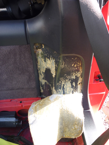

Once prised loose, I found another screw with no head left, seized solid. This took me over an hour to free with WD40 (taking care not to get any on the seals), various screw bits, attempting to loosen it by hammering a flat-head screwdriver under it, trying to turn it with pliers, and eventually success was had by hitting it with an impact screwdriver.
I wasn't keen on this as I felt I could hammer through the fibreglass if not careful. But luckily it yielded results, and soon the B pillar cover came off for cleaning and detailing away from the vehicle.
The second B pillar needed the same treatment as although the top screw had a head, it was pretty solidly seized. The impact driver free'd it without the need for WD40, and before you knew it, the second one was off.

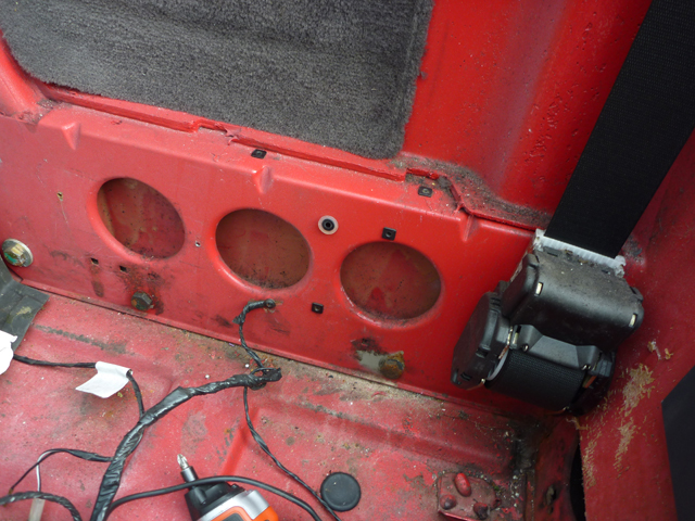

The next step was to try and remove as much cosmetic items as possible so I don't risk getting overspray on them. I'll be masking up anyway, but nonetheless, parts need cleaned and treated, so off came:
- the door sills
- the back carpet (little orange tool proving brilliant at prying it from under the back bolster without damage)
- map pocket

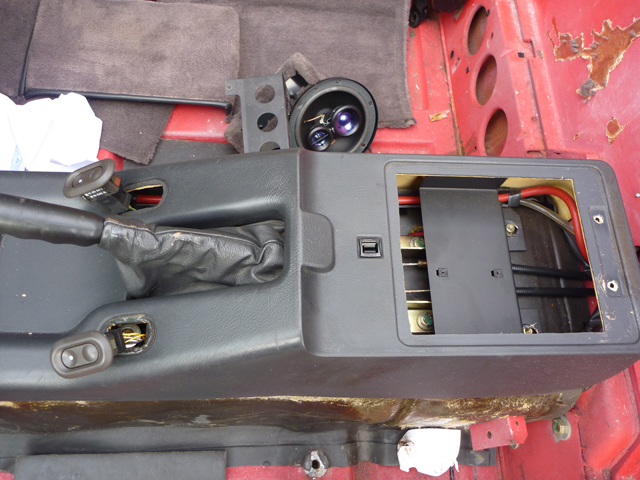

- the ECU. This won't go back there because of the subwoofers I will be mounting, but there will be space behind the subs on top of the back sill.
Then I ventured into the centre console, prying the switches loose with, you've guessed it, the little orange tool, undoing the bolts which are in two places, under the storage lid (shown) and under the mirror switches.
