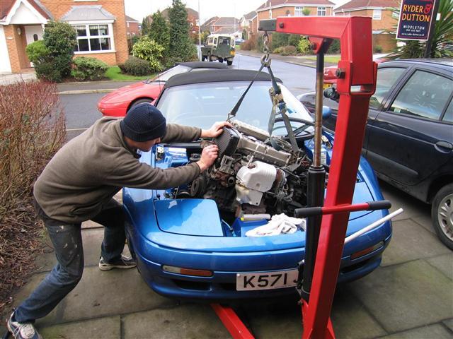

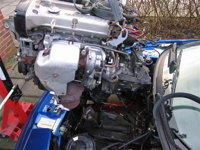

Its out! :D
Its out!
Picture 023.jpg (72.72 KiB) Viewed 136574 times
200+ horses 1 donkey
Picture 018.jpg (73.92 KiB) Viewed 136579 times

Postby Monty » Fri 27.01.2006, 23:21
LMAO :smt082
Honest guv it was n`t me who scratch your lotus :shock:
We want more pic`s.

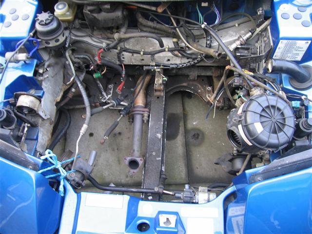

Postby Dico » Fri 27.01.2006, 23:29
Gutless
Disembowled Beast
Picture 024.jpg (68.68 KiB) Viewed 136568 times
Postby Paul.P » Fri 27.01.2006, 23:32
Dico wrote: Dissembowled Beast
& will she never be the same again ! :?
Postby stevo » Sat 28.01.2006, 08:45
look at that skinny wee exhaust pipe! needs sorting dico.

Postby Doug » Sat 28.01.2006, 09:00
at least he has all the wiring clearly marked to allow easy re-instalation . . . :roll:
looks like a lot of work for a simple oil change :P

Postby nitroman » Sat 28.01.2006, 11:58
I am in awe of your tenacity. Not to underestimate what you've achieved, but now is the perfect time to tighten the drive belts, access the alternator or anything else you can think of, remove the exhaust to fit a "stiffy", and have the exhaust manifold Jet-Hot coated. Basically, the list never ever ends.
Congrats on having the guts or suitable quantity of beer to do what you've done! :wink:
p.s. - You don't suppose a FWD Northstar V8 would fit do you? :smt029

Postby Monty » Sat 28.01.2006, 14:34
Doug wrote:at least he has all the wiring clearly marked to allow easy re-instalation . . . :roll:
Actually there wasn`t to much wiring to disconect, but some were just difficult to get to. U`ve got the wires going to the coil side and the ones to the alternator, starter and think there was only one more going to a sensor. There was only 2 earth leads just above the alternator, which i thought there would be more :? Then u`ve got the gear cables, fuel pipes and oil cooler pipes which were a pain to get to. If u`r going to remove engine and gearbox out in one go, remove the filter bin and it`s bracket as it`s dam tight to get out :evil:
Dico`s got alot to do, cleaning, rust treatment :roll: waxoyl change all the belts. Things to be painted or blinged. but i think he`s already lost the will to get it done :-D maybe ready for Donny 2007

Postby Dico » Fri 17.02.2006, 22:22
I have just removed the cast iron piece of cr@p (which was a job and a half, with the engine out!)
The stiffy is being sent away next week to be ceramic coated.
My question is - Could porting the wastegate to 20mm have any negative effect? (should i just do it to be on the safe side)
Its an easy job whilst the engines out.

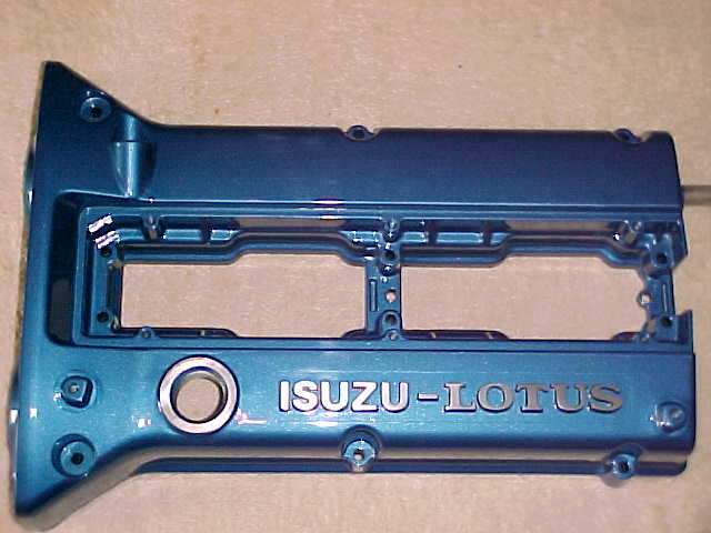

Postby Paul.P » Fri 24.02.2006, 18:06
Dico asked me to post pic of his nice newly painted cam-cover, think there's more bling going on in Manchester than we know of ? :o
Dicos cam-cover.JPG (35.92 KiB) Viewed 136322 times
Postby Gazza » Fri 24.02.2006, 18:32
Cam-cover looks excellent, come on then how much, who did it, how long did it take and what type of paint was used?

Postby Paul.P » Fri 24.02.2006, 18:42
Gazza wrote:Dico
Cheers Gazza
Gazza, i had a local bodyshop do it for him, same people that did mine. Time is really imaterial because we told them we were in no hurry, & they used 2 pack paint. They reckon theve done loads of these & never had a problem yet. Price was £50, as it was mettalic, its £40 for normal.
Postby Enright » Fri 24.02.2006, 20:10
That looks nice. Bit surprised that the Isuzu is still there, but that's just personal preference I suppose.
