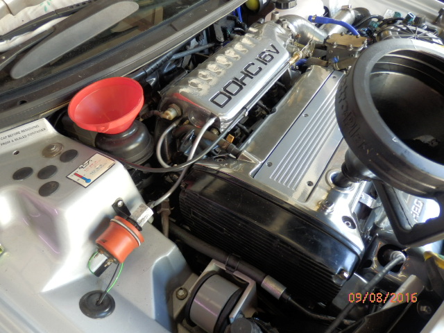

Time for some fluids and a last check.
Outside under her own power for the first time in ages.
A few little issues, a fuel leak from the pressure regulator, cured by replacing the seal. Idle was way too high but noticed that I had left the vacuum pipe to the brake servo off.
Worst problem was that the gearbox jammed in a forward gear, so called Alan Voigt who overhauled the box, he suggested that the selectors may have moved in transit. I removed the selector box, reseated everything and put it back together, all good. Noticed the reversing light was on tried so select gears again, jammed. Selector box off again, found out that the new reversing light switch was jamming the mechanism. A thicker washer than the one supplied cured the problem. Thanks to Alan and Mark for their assistance today.
Need to bleed the brakes, compressor gave up the ghost today, then have a look at the cooling fans. Getting closer to MoT and road test.

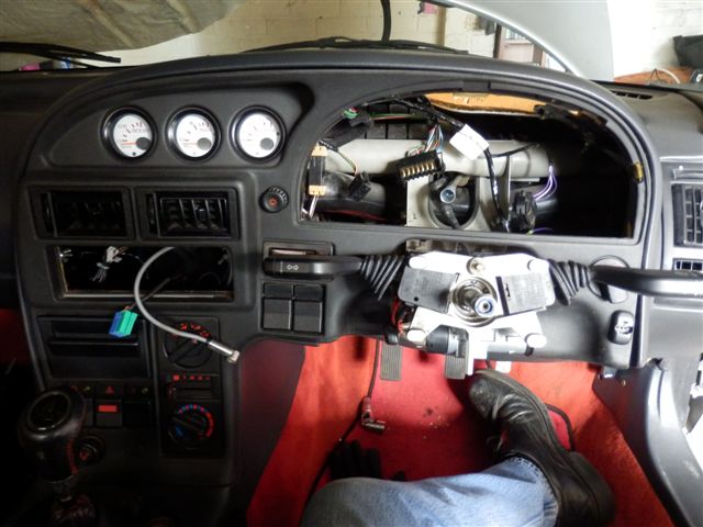

The Australian comedian Kevin Bloody Wilson sings a song describing the kind of day he has had. Note, only google this if you are very broad minded. After today, I know where he is coming from.

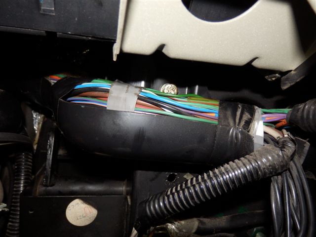

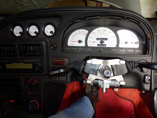

It started off quite well, steering wheel off, column out, instrument panel removed.
The silver box on the rh side is from the alarm immobiliser I had fitted a while ago, at least I can wire it correctly now. The black box on the left is from a previous alarm install. That will be removed.

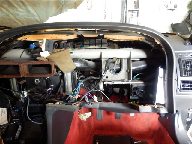

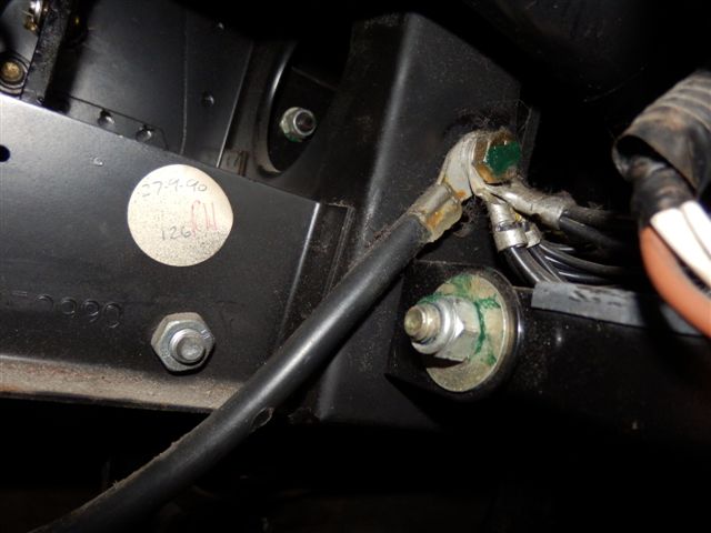

Then the fun started, disconnect the earth point,the manual totally forgetting to mention that it is a nut and bolt.

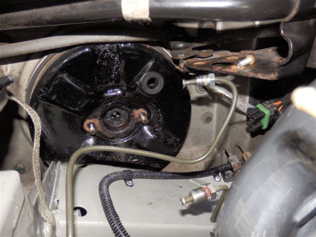

The manual says remove the 2 securing nuts and leave the master cylinder connected. This is not possible unless you have a trained octopus. Removing the wiper motor and power steering reservoir give a little more access.
You then have to remove the 5 13mm bolts securing the pedal box, 3 of them can be seen marked in green.
There is no way of getting to these without removing the BMC & wiper motor.
The manual then says, remove the pedal box and servo. After trying for more than 1 hour, I gave up and went for a beer.

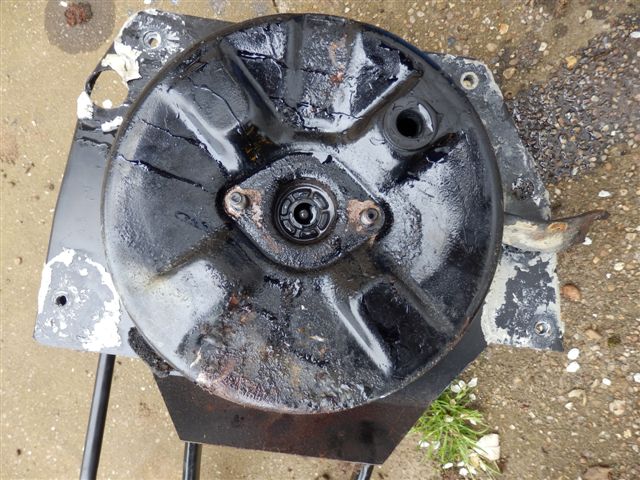

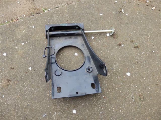

More things that are not mentioned in the manual, this bracket has to be removed. Two, 13mm bolts.
There are also two 10mm bolts that hold the cable conduit to the pedal box. You can see 1, the other is hidden under the cable loom. Had the clown who wrote the manual procedure mentioned this, it would have saved a lot of time and effort.
After these are removed, the relay box can be repositioned to allow a bit of movement in the cables. The cables have to be moved to free the top of the pedal box.
Finally, with a lot of jiggling it is out. Full of brake fluid!! Some of which, just to make my day even better, spilled on the carpet.
There was a 'new' servo on ebay last week for a good price, however the seals will be 25 years old. This is a job I will do only once, I would rather scrap the car than do it again. So it has gone off to a company in Rochdale for overhaul.
