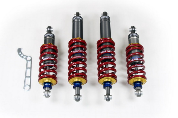

The Nitron dampers are now available.

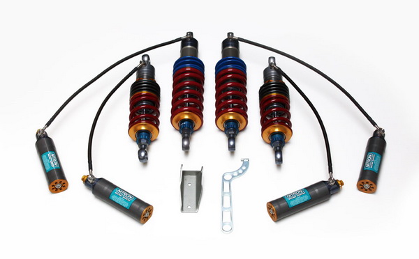

You can get them in different configurations so you could opt for a 4 way damper with remote reservoirs but they are expensive and they can be supplied with a pillow ball top mount which again adds to the cost.
Lotus damper a.jpg (41.29 KiB) Viewed 8311 times
from these
NTR Sport.jpg (79.65 KiB) Viewed 8311 times
to these
with the correct mounts which have now been engineered to suit the front yoke, rears are easy as the mounts are fairly standard.
I do not think there is anything fundamentally different with the fed setup just some minor changes to accommodate the difference in weights and springs and as the Nitron dampers are adjustable (with in a range) then I do not foresee any problems fitting them to a Fed car and the ride height can be adjusted to suit the Fed requirement.

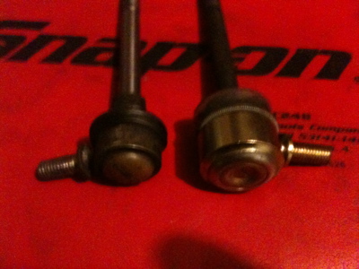

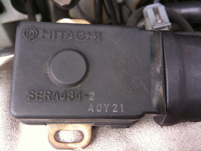

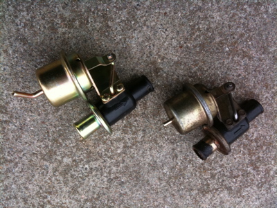

new heater valve, Bugatti type tie rod and TPS. Heater valve is from Volvo world and is pretty much identical to OEM. Unfortunately it is still prone to the same type of failure..

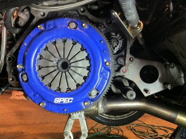

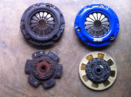

At the 'mo I've been working on daniel's car getting it sorted and going to work. Of course while all this has been going on I've all but neglected the upkeep on my girl. Well she let me know her displeasure. Clutch up and let go on the way to work a few days ago. When I got back to the employee lot I figured I'd give it a quick adjust then all would be well. That's what I did to go the last 1/2 mile to the lot. She wasn't really happy with that. I did manage to get her home but it was an ordeal. Clutch is deffo done. I figured 45K miles and 10 years of city driving and track days on a six puck racing clutch was pretty good. 'Bout time it let go. Just hope it didn't knacker the alloy flywheel to bad. Suggestions on a replacement? Was looking at a Spec stage 2 as I'm not going to track her much if at all anymore. Too much expense and heartache when some knob breaks something or looses a wheel and I inevitably strike it. Lucky like that. I just can't do it right now. I want my baby back to pristine. She has too many battle scars as it sits and I really want her back to show quality. Enough emotional turmoil. Anyone have suggestions on clutches they have used and price/vendor?

Postby lotusgirlmarie » Fri 12.08.2011, 23:32
Clutch in but, throw out bearing retaining spring snapped Doh!!!!
full face stage 2 kevlar clutch vs. 6 puck racing clutch
installed

Postby Monty » Mon 15.08.2011, 19:23
Hey Marie,
How does the pedal feel now compared to the 6 puk? Any details/links on the clutch you purchased as i`m sure others would be interested for future Ref :wink:
I`ve got a 6 Puk and lightened fly to fit but think i`ll wait till the stock clutch burns out :lol:
Re: LGM Elan
Postby lotusgirlmarie » Mon 22.08.2011, 19:02
The six puc is far grabby-er. Still street able but you will have to learn to modulate it better. The pressure plates feel very different from a stage 2 to 3. Stage 2 is just heavier than stock where a stage 3 is noticeably heavier. The full face clutch is very easy to modulate and still holds the power of my updated engine. Both are good clutches. Just depends on what you want from it.
