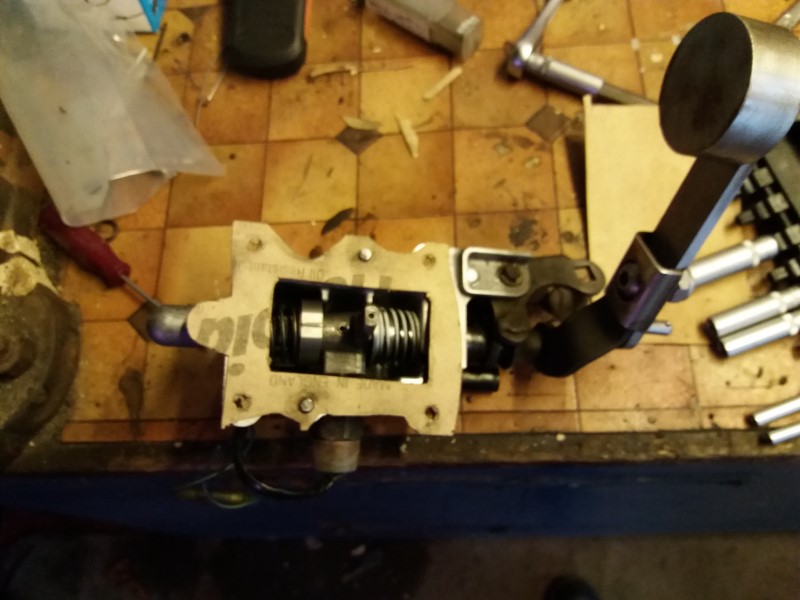

The car then decided to jam in a forward gear when going from reverse to first, it had never done this before the rebuild, the cables are the BB type and quite recent, gearbox was overhauled. The gears could be manually reset in the box. Reading on here and talking to Gerald at GST it looked as if the selector box was causing the problem. Took it apart, cleaned it, it worked fine, for 5 minutes!
Took it apart again, somehow I managed to rebuild it 180 degrees out.
No problem, take the pin out and do it properly. The pin would not move, pillar drill & cobalt bit - sheared. Not one of my better days. :banghead: :banghead:
I was able to get a fairly new one from Rainer Brammer in Mettmann, fitted it but still had the same problem. After replacing the gear lever assembly and adjusting the cables I don't know how many times, I stumbled on the sweet spot and it is working normally now. I really do not know what caused this but it was very frustrating!

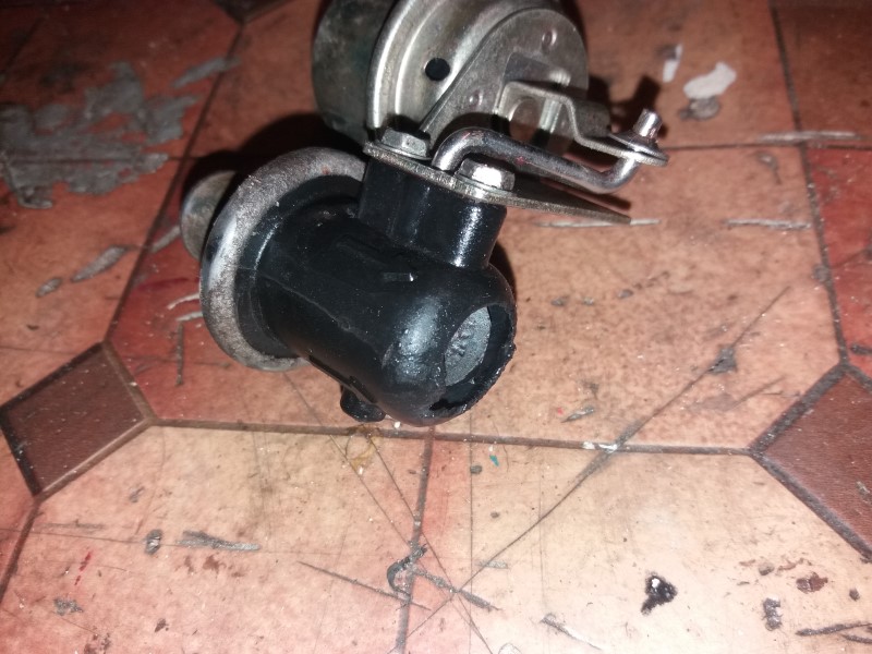

However the worst happened on the drive home, I heard a loud bang, next thing I knew that there was steam everywhere, temp gauge on full.
The heater valve had sheared and dumped the coolant in a matter of seconds. The valve was fairly new, I replaced it when I did the hoses a few years ago. I let the car, and me cool down over night, replaced the valve and started it up, looks like HGF!

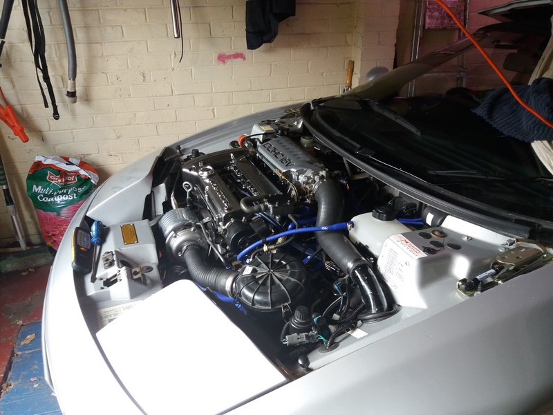

Postby cliff » Mon 15.10.2018, 20:37
I read a lot about different coolants from various websites, they all have different opinions, trying the OAT seemed ok at the time.. The water has self drained anyway so I will flush it and replace it with blue or green. My HGF was due to the heater valve shearing where the outlet pipe meets the body, hence immediate and sudden coolant loss.

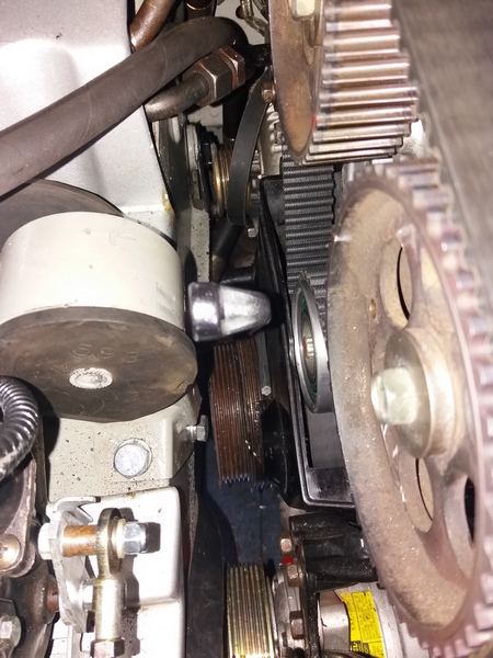

Almost six months since it happened, I have calmed down a little, so finding myself in the UK for a few days, decided to pull the head. Why do Lotus hate car mechanics so much? I have rarely seen such poor design or lack of thought put into what would happen when the car left the factory! It was a pig of a job even with a lot of new parts and a recent rebuild, I was tempted just to pull the engine several times, it would have been easier.
The you tube cambelt change video was very useful, I had only done the belt with the engine out, they must have edited out a lot of swearing!! In one of the comments he says "It was worse than it looked in the video. Anyway thanks to whoever made it.
https://www.youtube.com/watch?v=osBhwSw3VBk

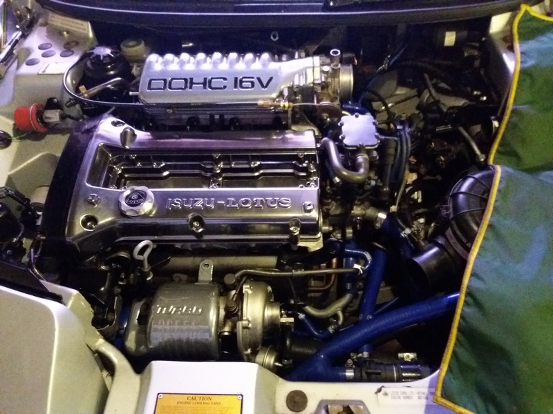

It's off.
Cleaned up nicely, no sign of warping or distortion on the head, gasket arriving from SJS tomorrow.

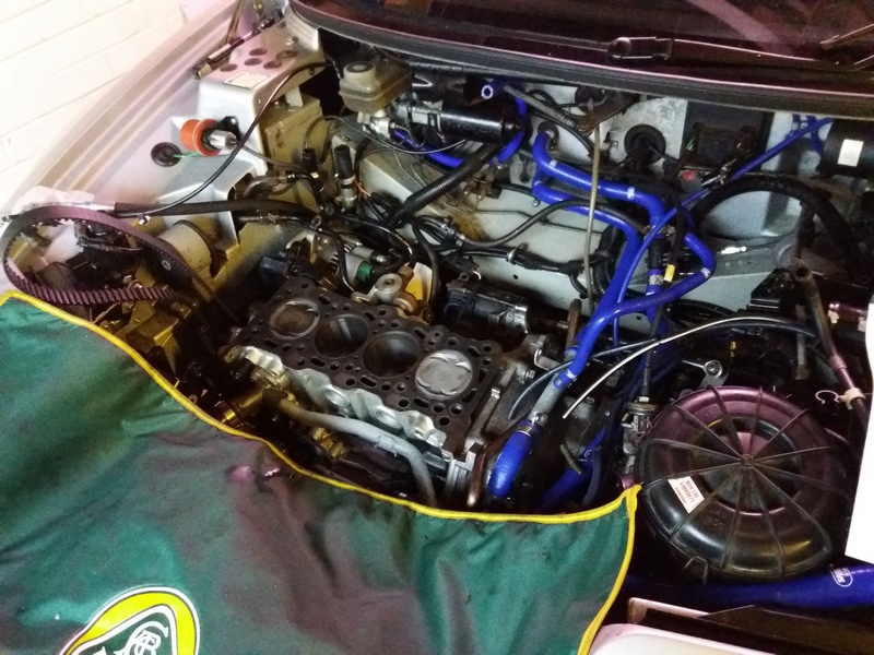

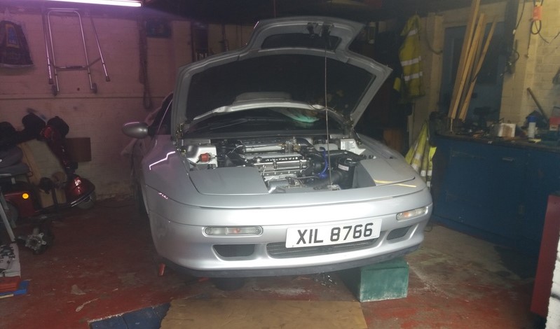

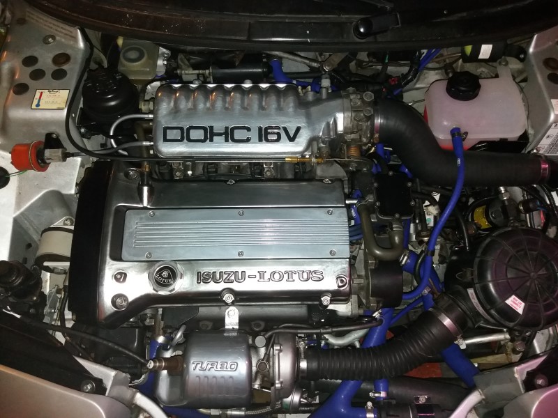

Postby cliff » Wed 17.10.2018, 20:50
There must be a special place in hell waiting for the person who designed the right hand engine mount! :banghead: :banghead:
Head is back on and almost connected.
Looking at the state of the oil, the oil cooler will need flushing as well, that will give me chance to fit the mounting duct that I has been sitting in the garage for some time.
I had a quick look at the other MoT fail, stiff steering. The upper and lower ball joints are fine, even with some weight on and the track rod ends are quite recent. The rack is very stiff, on most cars, it is easy to move, not this one! There is an adjustment screw, so need to have a look at doing that. Obviously, Lotus made it really hard to get to. :x :x

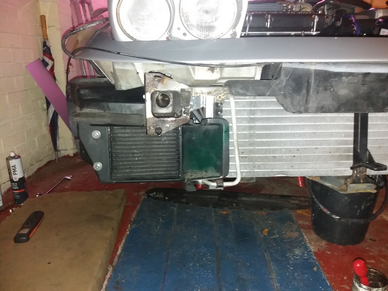

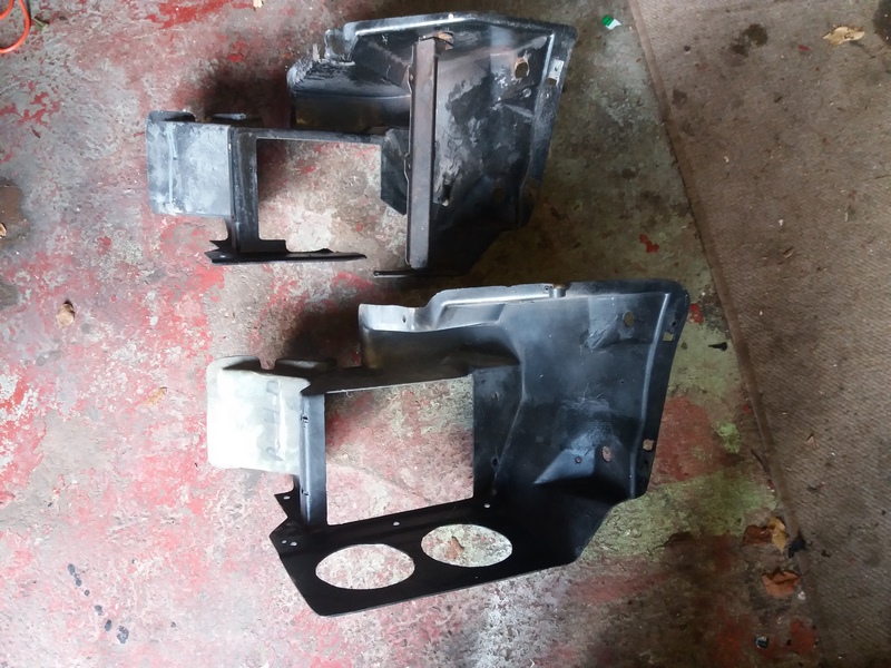

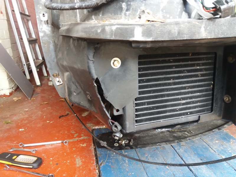

Postby cliff » Wed 07.11.2018, 21:54

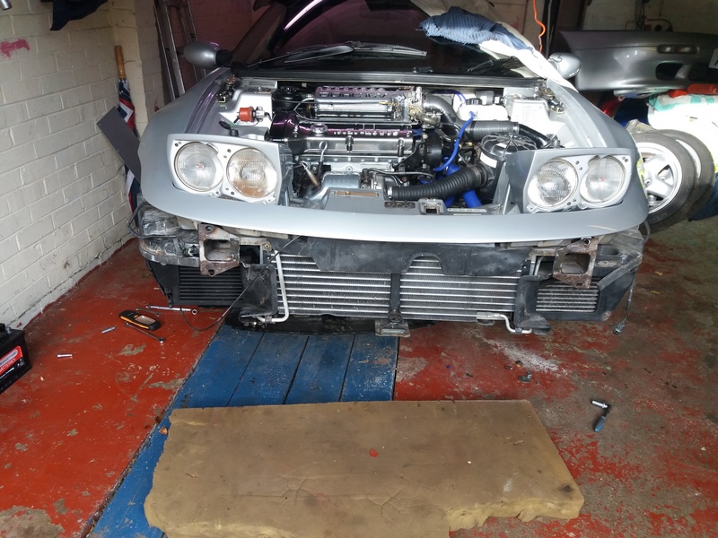

Engine reconnected, time to drain the oil cooler and replace the duct.
Bumper off, again!
Obvious damage to the duct, luckily I bought a repaired one from Phil (surfboardfiller) some time ago. As has been covered LEC before, the Cool Ex oil coolers mount slightly differently, nothing a drill and some nuts & bolts can't cure. Maintenance on this is now pretty much impossible without taking off the bumper but that is a small price to pay for having it mounted securely.
All done, annoyingly, the ac pipe routes through this area, giving even less access.

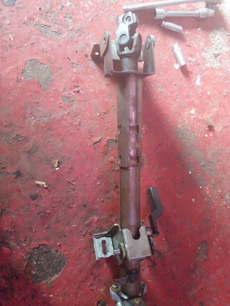

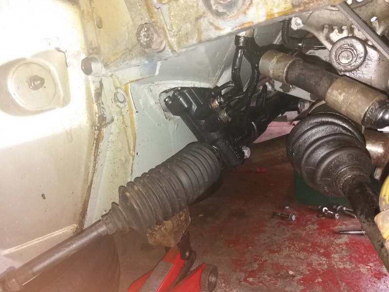

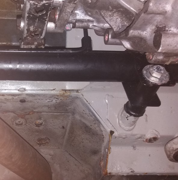

Postby cliff » Mon 26.11.2018, 21:12

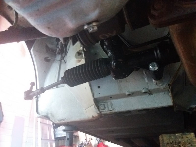

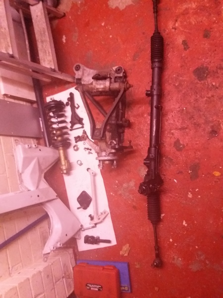

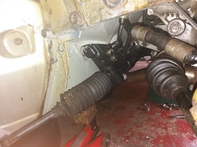

Time to look at the stiff steering. Column removed, some play in the upper uj but no noticeable stiffness.

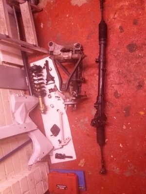

With the help of my best friend, time to get the rack off.
Old and a bit battered looking but it works well, makes removing the raft and prongeron very quick. With those out of the way access to the rack is quite good.
One word of advice, if you fit the steering rack with the engine out, make sure the replacement bolts are not too long otherwise they hit the gearbox and you can't get them out. Luckily that's why angle grinders were invented.
I wasn't looking forward to this job but compared to other stuff on the car, it wasn't too bad. Lift the car as high as possible and remove the raft rather than lowering it.
Rack going to the shop in the morning.
