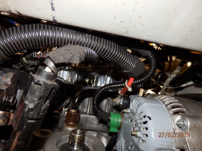

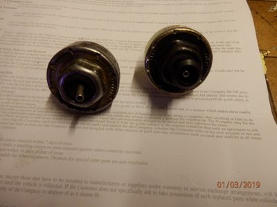

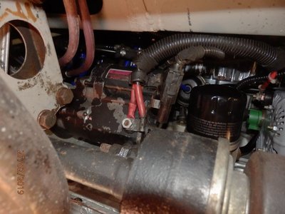

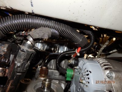

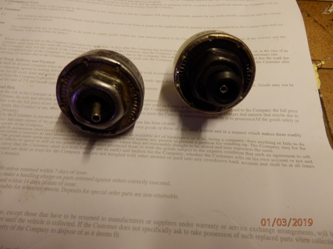

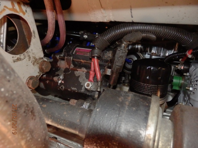

Knock sensor time. Prongeron off, can just see it with the camera but not physically.
Oil filter off, still can't see anything, but can feel it just above the oil filter and below the secondary throttle actuator.

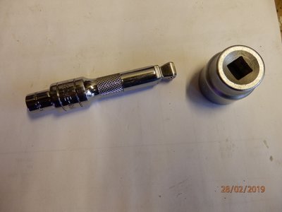

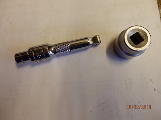

A 22mm socket fits over the sensor, but a standard 1/2 inch drive is too big. A 3/8th drive 22mm with a wobbly extension does the job.
Be careful when refitting it, dropping the new sensor behind the starter will lead to a lot of swearing! :censored: :censored:
The car is running much better, I went for a 20 mile drive around the country roads and she ran nicely, a little hesitation sometimes but that could be down to old fuel.

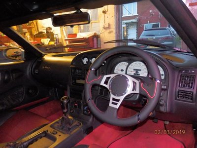

I fell out of love with the Elise wheel some time ago, I find it a little small so have had the original one on for a while now. This Momo wheel is bigger than the Elise but slightly smaller than the OEM.

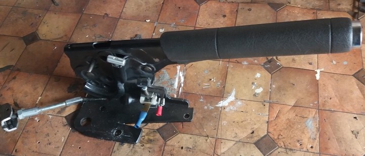

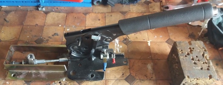

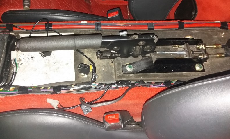

Jamie N's handbrake mod.
Modify the existing handbrake mount.
Paint and install the cables.
I had to remove a small amount of material from the centre console to allow smooth operation.
Looks good, just need a better fitting gaiter, the lever works really well, much better than the original.

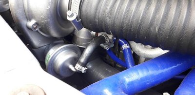

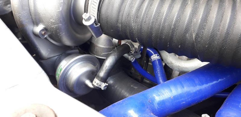

I have felt the car was not really producing the power I had hoped for since the rebuild, for the first time yesterday, there was an audible air leak, it still went pretty well though. Back home, I found this: The turbo pipe was just resting there.
Another jubilee clip and road test, now I have power and boost up to 0.85 smoothly without over boost.
