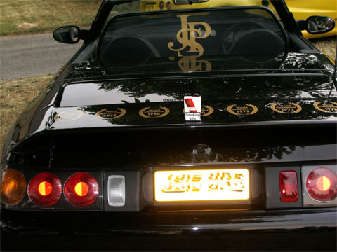

Postby Gary » Sun 09.07.2006, 17:01
Health Warning !
Postby Paul.P » Sun 09.07.2006, 19:23
You sneaky little devil, bet you did that in conjunction with Russ ?
Must admit, you can't see the damage to the bumper there !
