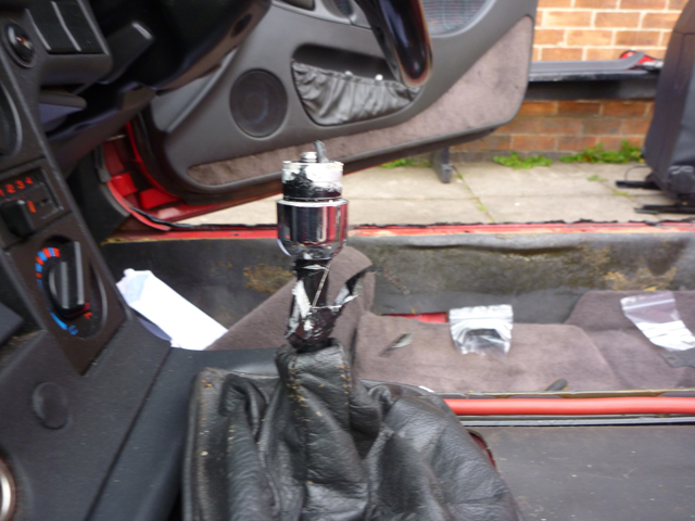

I had to spend a little time pulling the gear lever off because some dipshit had wrapped gaffa tape around it to fit their stupid aftermarket halfords gear knob.
Thankfully I have an even more stupid aftermarket chinese gearknob to replace THAT with.

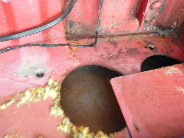

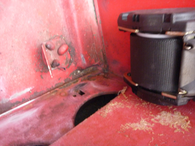

I had another look at the rust and am convinced I have caught it in good time. If I am correct, the picture below shows the jacking point and it looks fine, with just a little surface rust. I am not 100% sure how to clean it off, but it will get doused in Dinitrol and last 10 years or more, of that I am sure.
However, the area around it is pretty corroded. There are 2 big holes. There also seems to be an angled strut coming up from the jacking point. For now, I am taking the attitude that this is the structural part, and the outrigger panel with the circular holes is almost cosmetic, and simply a danger if allowed to feed rust to the jacking point and strut. Whatever the case, I have to treat whats there now; if I get a panel welded over this I don't think it would help much; in Bob Brown's documented case the rust from the picture shown above had fed into the jack point; mine hasn't.

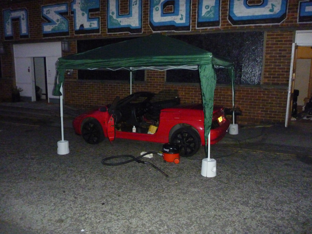

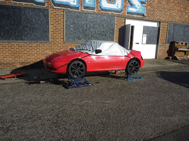

Gaiters came off, console came off, and as the rain was setting in, I decided to try and fit the battery brain I bought. Unfortunately as there is no clearance above the battery, I'm going to need a cable to do so.
So the tub is empty as much as it can be, and I am a bit unsure what order to do things in. Rethinking the order of things all the time, but this is the current plan:

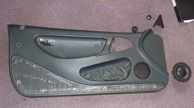

- remove steering wheel, send steering wheel, gaiters, door cards (i need new door lock surrounds still) and seats off to be refurbished

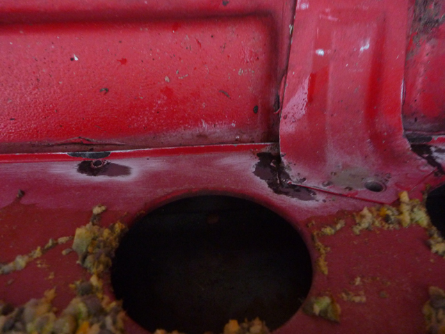

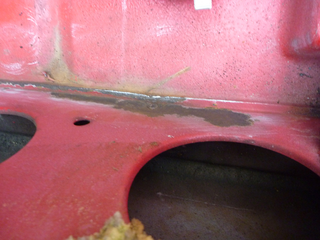

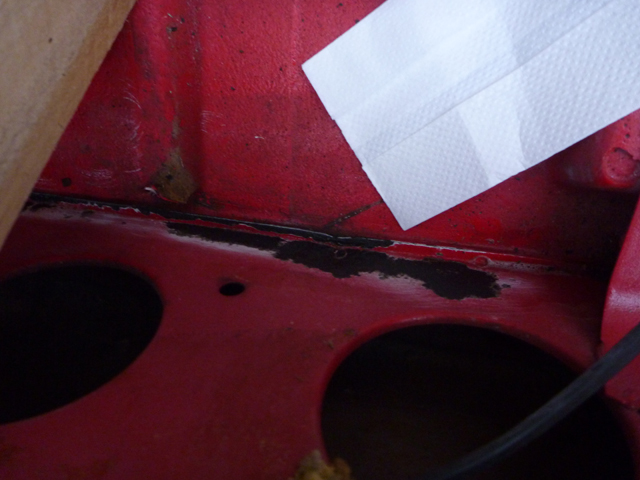

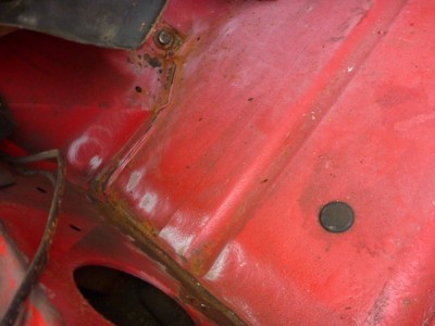

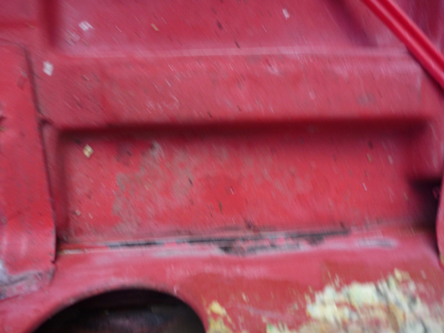

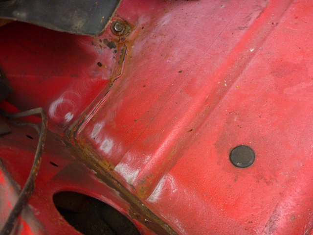

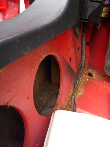

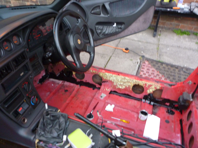

So onto the rust itself.
Initial situation was as below. All of these pictures are taken after a quick initial grinding with a Laser fibre disc mounted to a drill (about £4 each, and they will do one job each; i.e. I used 2 for this, one for each side. They remove just enough rust without breaking the metal, but the downside is they erode in use. Much better than steel, wire, or angle grinding as all possible metal integrity is retained).

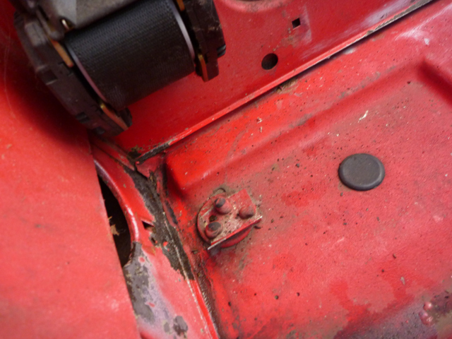

Back passenger side, OK
Closer view, looks messy but not as bad as it looks.

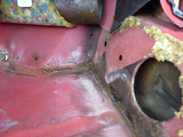

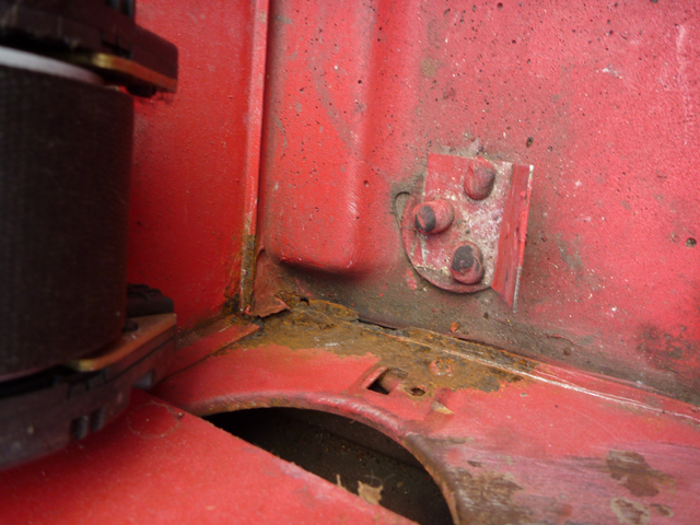

Again, front passenger side, not too bad really. I will later discover that the finish on the jacking point is Dinitrol ML.
and the front edge of the passenger side where it meets the bolt

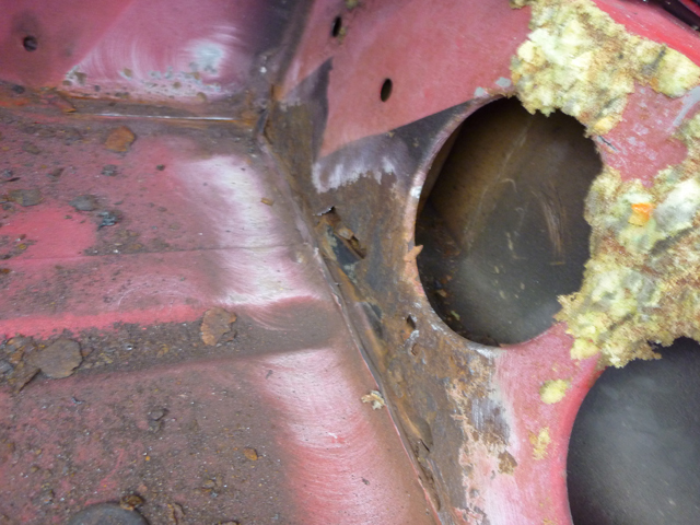

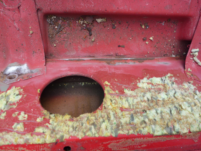

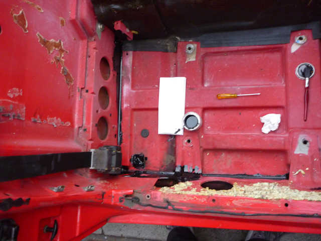

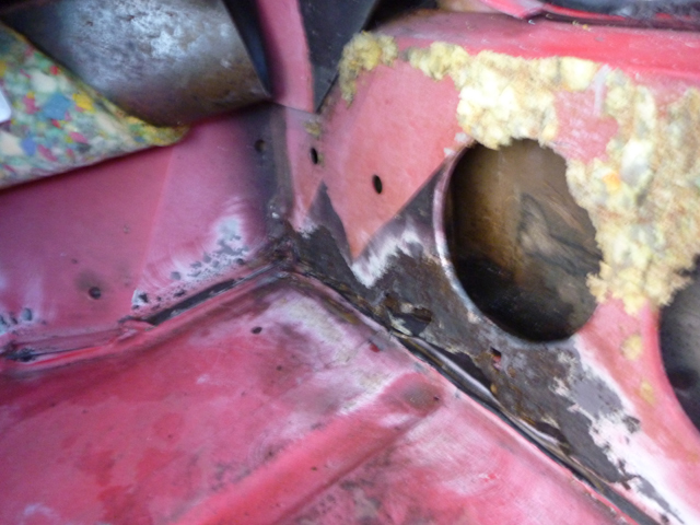

The drivers side is much worse. Window down, wet leg, anyone?

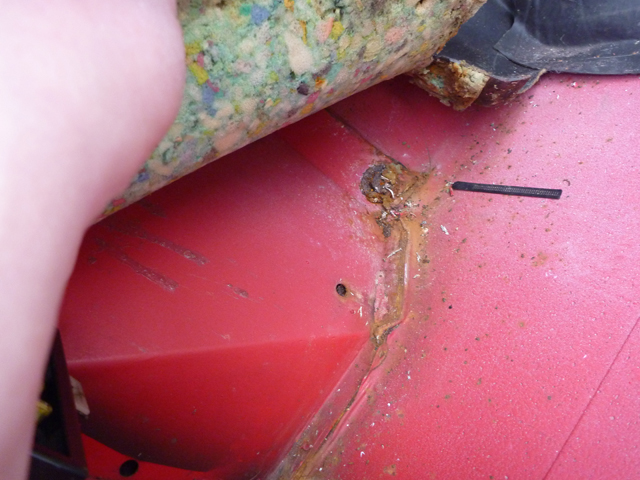

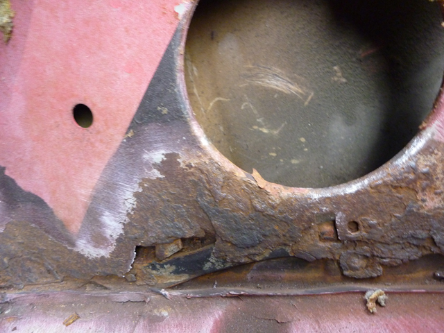

The worst part, front drivers side. You will see that the panel is rusted through in 2 places, but I do not believe these are structural.
Close up view of front drivers' side.

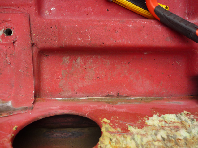

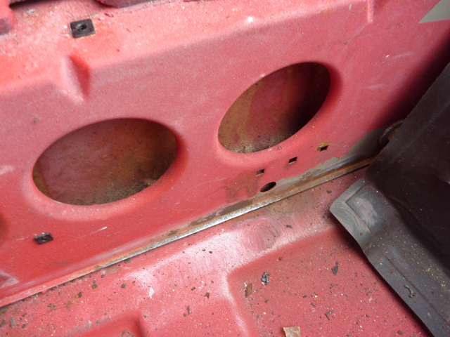

As view extends to the back of the drivers side, the seams have a little surface damage, but are intact.
Middle drivers side. You'll note the fibre disc takes away paint that has rusted underneath . Quickly getting down to bare metal now.
And the back of the drivers side sills. More on this later.
This is the centre back of the drivers side after a quick grind. Light surface rust, easily taken away in the main part by the fibre disc. Thank Jebus I am catching this now, as it was just on the cusp of car cancer before the grinding.

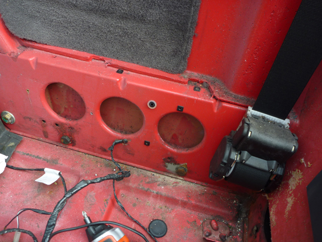

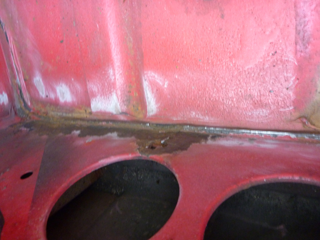

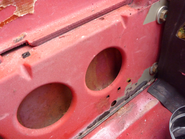

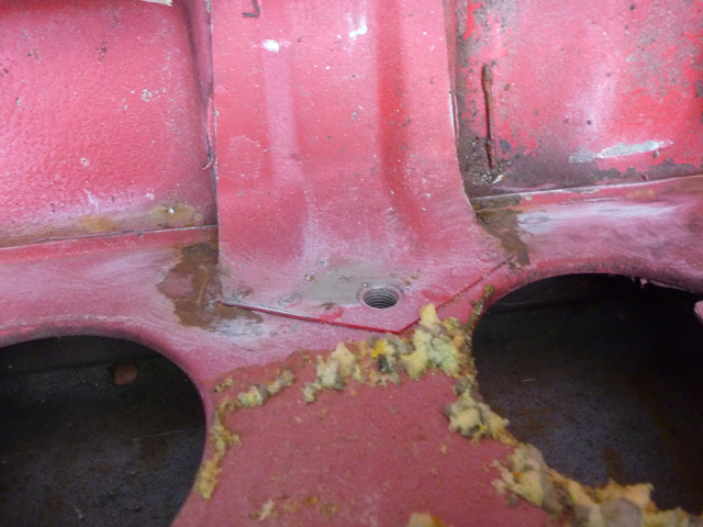

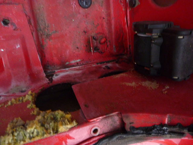

So with the photos above showing what I had to deal with after the initial clean/grind, I then started in with the wire brush and copious amounts of Clarke Rust Treatment - a 25% phosphoric acid solution with evaporants and other rust-killing stuff, which has worked wonders on other vehicles, treated with that, then POR15, then after a respray, no creep 2 years later......
First thing I noticed was as I started in with the wire brush, portions of the seam at the back drivers' side started to pull off. Again, I'm assuming for structural purposes these were left there as edges from the seams, which are still intact.
At the centre drivers' side, I quickly approached bare metal with the brush.
Although the front drivers' side is bad, you can clearly see the angled strut and jack point have no issues.
So starting to scrub this area with a small steel brush and the phos.acid, its oxidising pretty quickly.
Light is fading. Central drivers side, all oxidised and clear to paint.
Not very pleased with the back drivers' side, but its oxidising up nicely. I'm really pushing hard with the Stanley blade and if I can't break it off, its structural in my book.
Back drivers' side sill, however, is cleaned up perfectly. Bare metal or oxidised surfaces, looks clean.

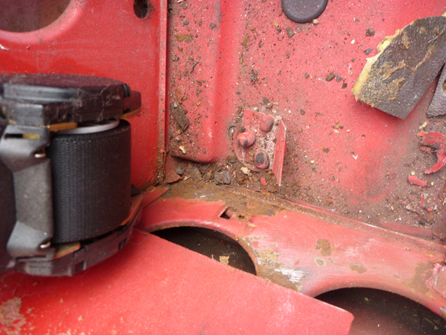

Front passenger side, looks pretty orange.
But in fact the damage ain't too bad, and its cleaning up and oxidising nicely.
You should note that during this process, I've spent about 8 solid hours scrubbing with wire brushes, replacing the fluid often, wiping away the excess with paper towels (my second favourite tool of the day), and repeating until the fluid foams up clear, and the metal has turned black. I've used brass and steel brushes, the fibre disk both direct on the drill and on a screwdriver extension inside the panels, and sandpaper to get to either bare metal, or black oxide.
Centre passenger side, starting to clear up

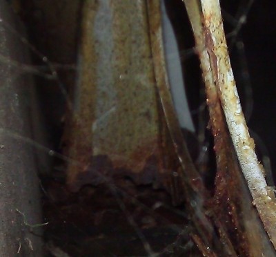

Postby epipete » Tue 09.10.2012, 22:46

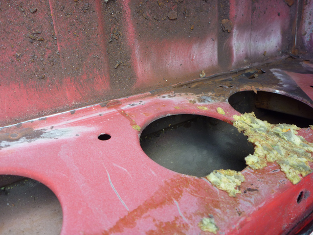

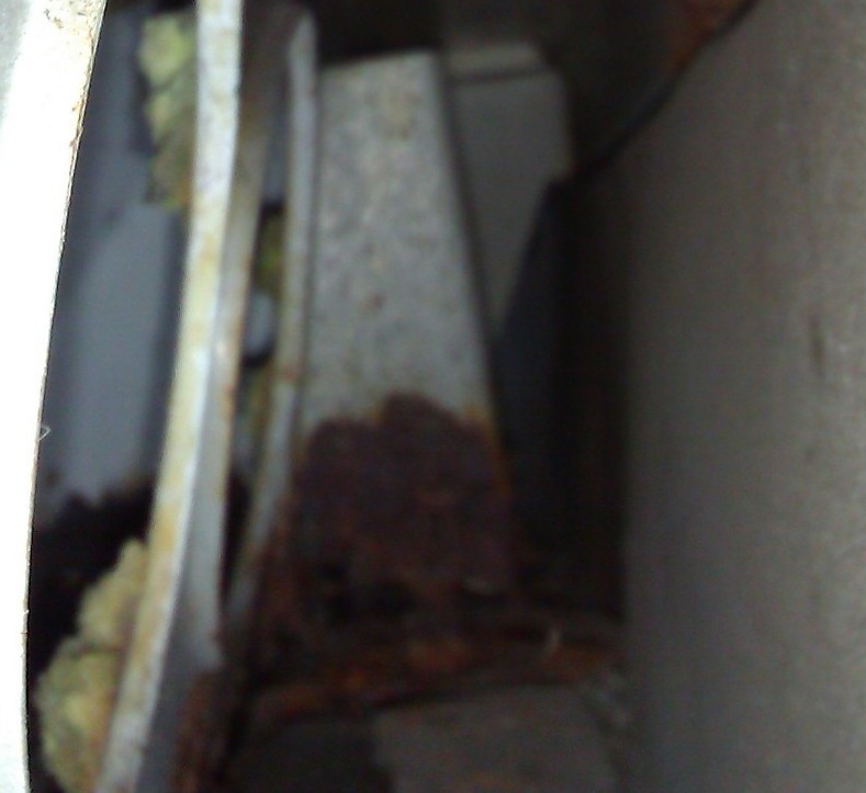

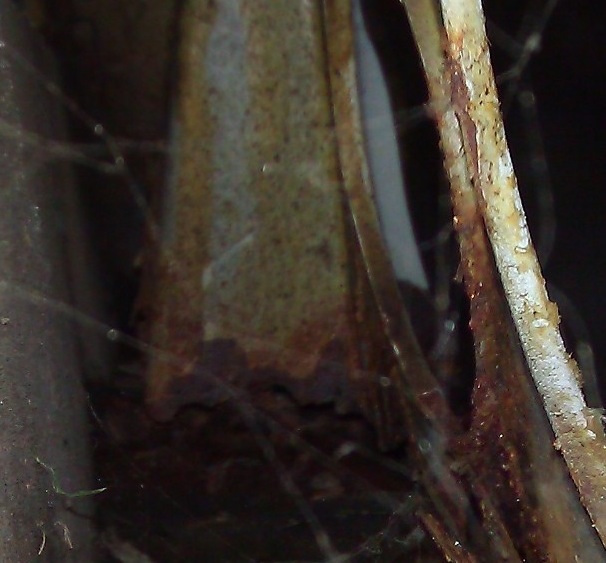

Yes, apart from the offside front you seem to got off quite well
I should check out your jacking points a little more thoroughly, a camera phone will give a good view, here's an example of mine
Off side
Nr side

Postby Jeemy » Wed 10.10.2012, 08:22
I didn't get great photos of them, but I did check them out thoroughly; they aren't as bad as the examples you show.
This represented about 3 days' work, I'm only halfway through the photos or so:
Again, centre passenger side, cleaning up neatly, a bit to go.
And back passenger side, again, cleaning up fine

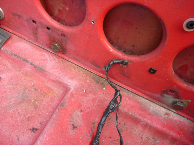

Back passenger earth point for ECU is going to be obstructed by my subs, and its dirty. I will deal with this later.
It oxidised up really well.

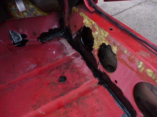

The full drivers' side coated in POR15
I started to treat the passenger side with the rust remover.
This was a much faster job, I got down to bare metal and oxide very quickly.
First coat POR15 finished
POR15 goes on, makes everything look more hopeful

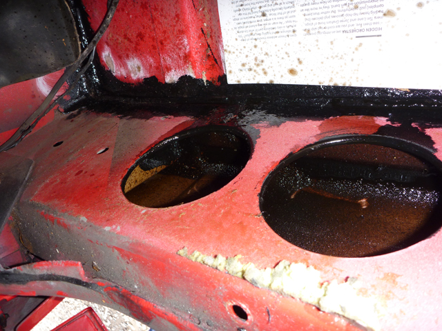

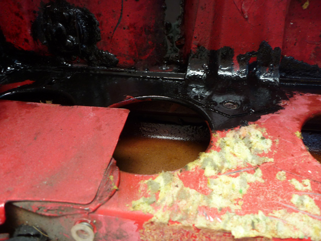

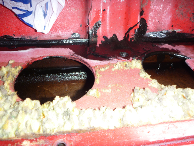

Postby Jeemy » Wed 10.10.2012, 12:27

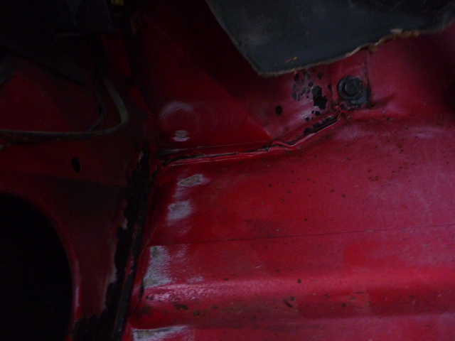

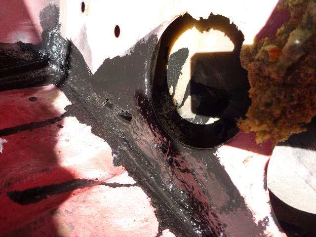

Front footwell nearside, all oxised and ready for POR15

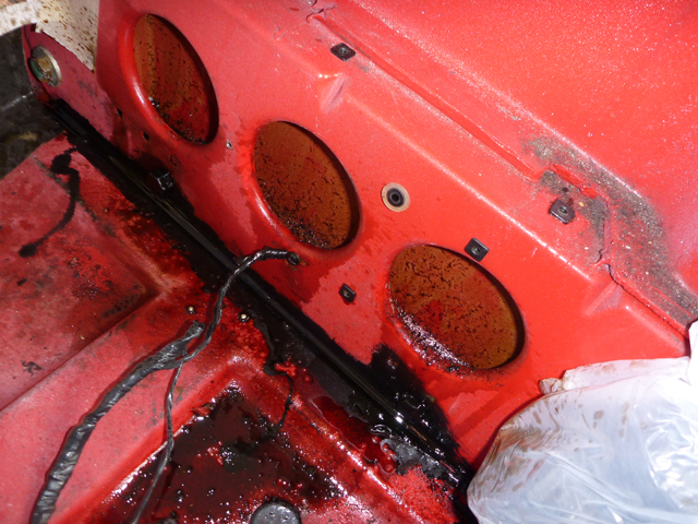

3 coats of POR15 is what I am going for, so I'll be at this till midnight. Made up a working area for the painting.
Its not the Mona Lisa, 3 more coats in the dark and then I left her overnight......
Cold light of day. Actually, quite a warm one for Scotland. Paint is nice and hard, doesn't look like I missed anything.
This is the bad part, all sealed now.

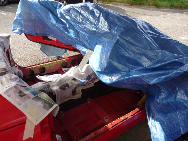

At this point I set up to fill the cavities with Dinitrol ML. My brand new air compressor turned out to have a faulty dump valve, I was pretty displeased, but there was enough pressure coming through to force the ML through the Shutchz gun and out of the cavity tube, so I proceeded to fill 'er up.
Can't be too careful!
After spraying with ML - 1
After spraying with ML - 2
After spraying with ML - 3
After spraying with ML - 4
Having never used the ML before, I wasn't sure what to expect but the general consensus from what I read was although it is incredibly thin, it does the job. Once I put it on, I could see clearly that it was the same or similar stuff that had been on previously. I sprayed to the top of the inner sills, and all round inside, and towards the corners, and it dripped out of the bottom of the vehicle so I am confident that its penetrated right through the vehicle. When I come to the underside I'll be further preventing ingress with 3125.
There wasn't any Dinitrol, or any form of protection, on the inside (inside-of-the-car facing, not inner) sills, so this is where the lying water in the carpets and under the foam, has eaten away. The POR should hold it from proceeding, and the ML should continue to protect the inners. This leaves water sitting in the carpets but I am going to work hard on the waterproofing soon.
So unfortunately my plan of getting up on ramps today and starting to clean and 3125 the underside will have to wait until I get the compressor fixed.
Going to have a rethink and perhaps start on the engine cavity and door cards waterproofing/speaker work.

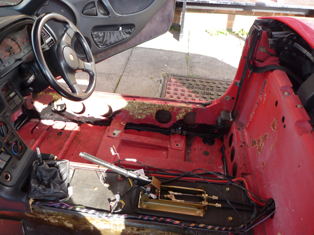

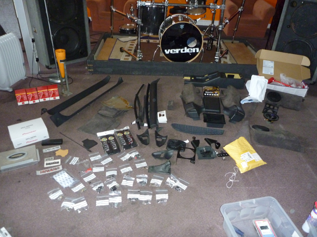

Big tidy up of my office, workshop and storage today.
Time to pull everything out of toolbags, consolidate it all together and group up parts for:
- carpet cleaning, or measuring for replace
- carpet removal and cleaning of plastic
- touching up vinyl and repairing/cleaning/removing old sealant strips
- making sure I have all the cables, fittings, parts etc
There are a lot more bolts and screws to come off yet so once I am finished removing them they will get moved into cardboard and relabelled there, and all the heads cleaned and painted so that visually, its all perfect when it goes back on.
I can't believe how much has come out so far and there is still the turbo, exhaust, dash, and another door to go - not to mention the first door is only half-dissassembled.
Roughly, from left to right, surrounded by innards and carpet.
- sub amp, head unit, old head unit for sale (new speakers in boxes, not pictured)
- sample of new leather colour, to return to upholsterer once everything is ready
- outer CV gaiters and fitting tool
- drivers sills
- new badges
- aerial, coin tray
- branded seatbelt pads (have 2 extra of these if anybody wants em)
- bags of labelled screws, console and door parts, still another box of these to find
- new black indicator crystals
- new and old door handle escutcheons
- new weatherseals, A-pillar seals (hoping not to use these)
- new black gear gaiter, old speaker mounts
- map pocket, B-pillars, centre console, battery brain
- old and new gear and handbrake levels (new still in bags)
- seat mounts in envelopes (seats not pictured)
- old speaker covers, probably never going back as new custom sub boxes going in place
- samco hoses and clips
Scary. Actually seems a lot less scary in a photo and catalogued. Probably why I do it.

I don't really want to cut the doors up, and it will cost me to have the vinyl redone, but it'll be a nicer job in the end, and I can't see any other way of fitting in the speakers. I was much keener on a 3-way system with 5.5" woofer than a 2-way, although I heavily considered DLS Gothica or Nordica, I just have always wanted Dynaudio in a car system - they are what I use in the studio.
Alternatives would be to mount in the kickpanels, or pods on the dash, neither of which seems to be more elegant, or better placement...
Any thoughts gratefully appreciated.
Speakers & Door Card

Re: Jeemy's Elan Rebuild
Postby norman lovie » Sat 13.10.2012, 15:44
lots of good work getting done there - reads like deja voo for myself a few months back
you want to get a good look / down behind the B pillar posts ( easy enough on the drivers side - but its a tank out job to get a good look on the nr side
The worst structural rust area I have found is at the back end where the centre chassis outriggers are exposed and the very rear section of the centre chassis where the rear wishbone mounts are
ref: phosphoric acid as a rust convertor - this stuff is good for the area's you can't get to easily - not to sure about the chemistry lesson sales pitch - but it does work - I have swilled it inside boxed in bits prior to waxing http://www.rust.co.uk/products/category ... converter/
norman lovie
Posts: 209
Joined: Thu 15.09.2011, 18:19
Location: Huntly Aberdeenshire
Postby Jeemy » Sat 13.10.2012, 16:40
Erk. Don't fancy tank out. I will certainly try a pour, although the ML has already dripped through whatever cavities it could from the back of the B-pillars. I had assumed that I would get to the back of the outriggers when I raised the underside.
Postby Jeemy » Sat 13.10.2012, 17:22
Haha I just read that, I have a chemistry degree and its gibberish to me!
From memory the datasheet on the Clarke product is that its about 25% phosphoric acid, also includes zinc phosphate and a bundle of other chems.
As I said previously, I used it on all the sills on my Vito before covering in POR15 (2 coats, plus 2 coats of tie-coat primer), intending to paint it myself. A year on (and I live by the sea, and windsurf from the van, so it had seen its fair share of salt) I'd got nowhere close and paid somebody to do it, and there was no rust creep at all. Whether thats the POR or the Clarke or both, I don't know, but for me winning combination right there.

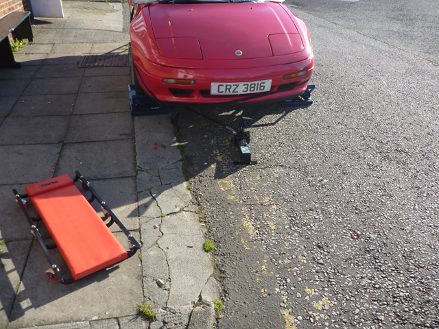

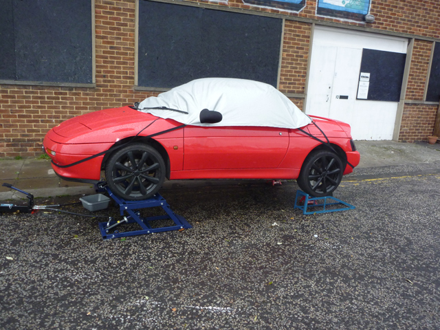

Postby Jeemy » Thu 25.10.2012, 16:28

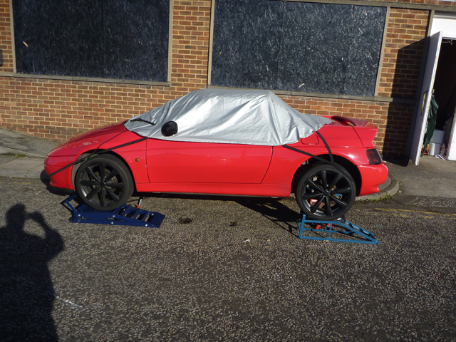

Well, after a very hairy time getting car up onto ramps, its done!
Short version - you can't drive it onto both due to the low centre sills. My original plan of raising it with the hydraulic lifts, then putting it on axle stands, didn't work; they aren't high enough. I ended up reversing it onto the static ramps, then jacking the body and the wheel to get the hydraulics under, then jacking the wheels off the static ramps and turning them round, one by one.
This took almost FOUR hours of finagling.
Finally, it was up on the ramps.
Once done, you just connect the pump,
and in a few seconds its up and pretty comfortable to get under:
One thing I hadn't realized, is that it can't just rest on the hydraulic rams. You actually have to raise it a bit higher than this, and then clip a metal lever into the ram collars.
So I am wondering if it is safe just to leave up there....the handbrake is on, its in gear, I can't see how it could roll off; and I think its equally problematic to keep raising and lowering it rather than just leave it on the ramps.
This is how it looks now its on the supports:
I have lots of photos of the underside and the cleaning progress; suffice to say cleaning it is going to be a hell of a job, and I've discovered more problems. Will post later once I'm finished work.
In the meantime, if anybody can set my mind at ease about the safety of it, please do so. Its safer than 4 axle stands for sure! Each of the hydraulic and static ramps is rated at 2.5 tons each......and you can just see the two axle stands which are there as a backup behind each static ramp.
Postby Brit-Car-Nut » Thu 25.10.2012, 16:32
Jeemy: to prevent roll-off, bolt or clamp a block thru the rear ramp to another block to act as a stop.
Or run a ratchet strap thru the spokes and lash a wheel to the ramp.
Postby dapinky » Thu 25.10.2012, 16:37
Cant see a big problem with it staying on ramps, but one minor observation.......
....why did you turn the rear ones round after reversing onto them? I'd have thought if they faced in oposite directions there would be far less chance of the car rolling off them, especially if you want/need to take the handbrake off to do any work in the wheelarch areas?
