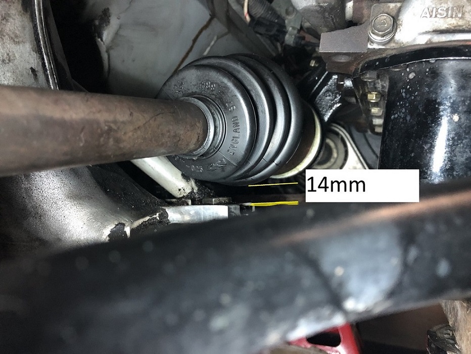

Awesome, thanks! I can see on the left hand side that the clearance isn't much either, but right side was pressed down on it.

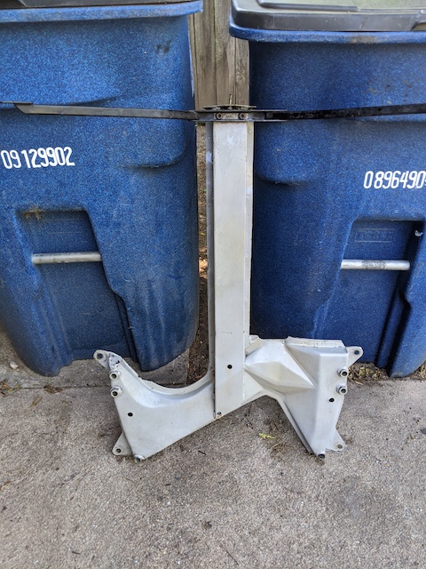

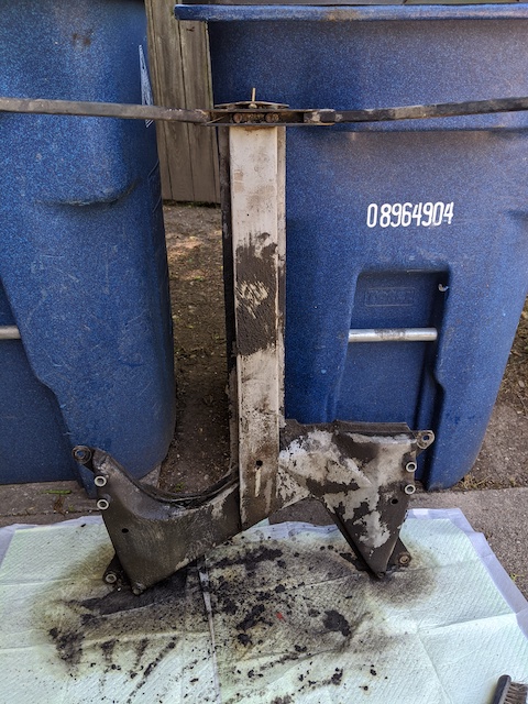

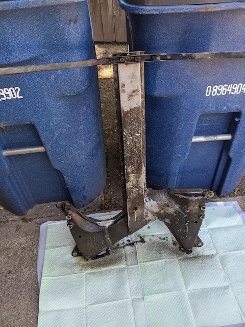

Here is the progress on the prongeron. Starting off with some citrus degreaser...
Time for the real nasty cleaners...
2hrs later and a lot of elbow grease

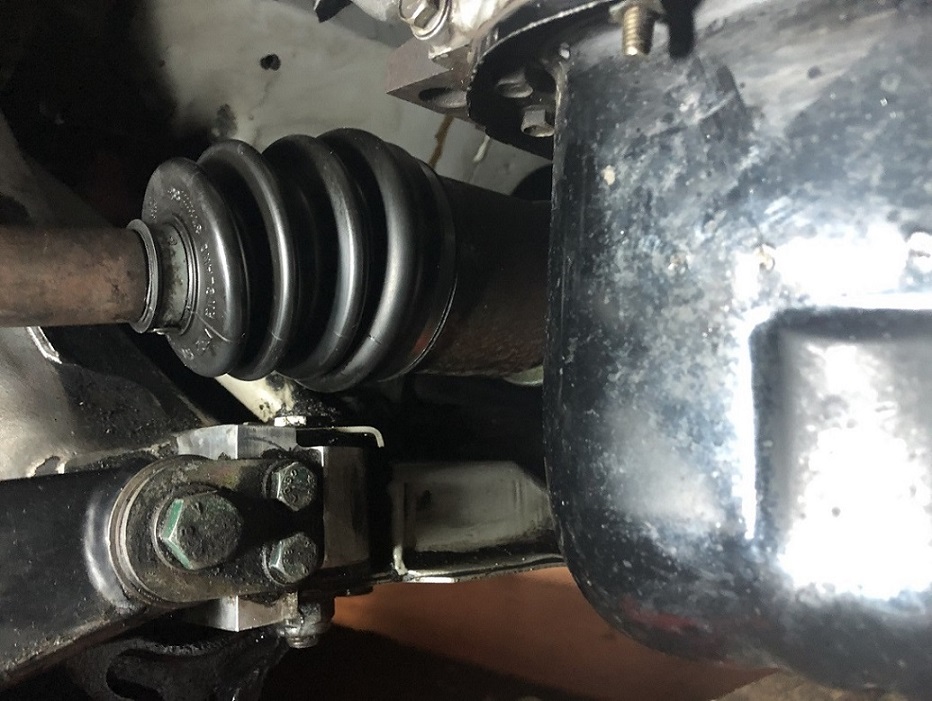

Ok, fitted my RH drive shaft and it looks to me like your inner boot was replaced with an aftermarket one that had the bellows too large for the space available (which isn't a lot to begin with) The clearance on mine, which has the OEM GKN inner boot, is 14mm from the closest bellows to the flat part of the metal frame (not the bolt) and this is at maximum extension (I.E no load on the spring, full deflection downwards)

Wow, 14mm, that is barely the depth of a wrench plus the head of the bolt to get over it! The photos are a real help to see the pivot angle and clearance, and I'm jealous of that clean under bay ;).

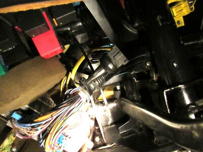

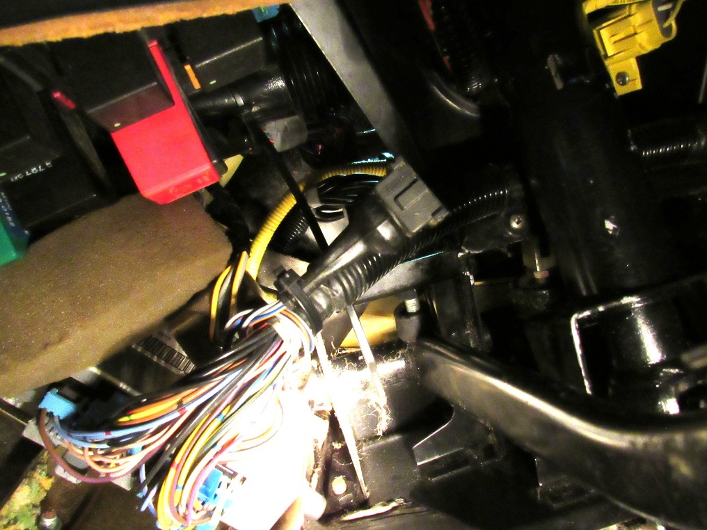

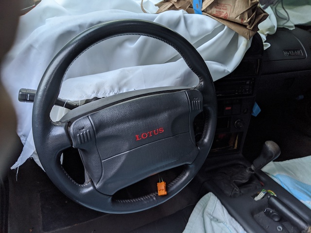

TorqueHorse wrote: While I was digging around to check out the condition of the ECM, I did find these open connectors too. I'm assuming innocuous, but would love tips if otherwise.
You need to provide a much wider picture to get an idea what you are looking at. You can decrease the resolution (a bit) to keep the size down. You can email it to me rather than post it here.
I can resize it to post if you want...
I think the connectors with the yellow bits are for the airbag connections. Does your car still have the Pontiac Firebird steering wheel with the air bag in the center?
My car has the steering column exposed with the knee bolster removed, so I should be able to find those connections if I could see them clearer.
Re: Rosie's return to glory
Postby TorqueHorse » Tue 02.06.2020, 02:33
Yeah, sorry about that photo. I've seen bowls of spaghetti that looked clearer than that. Deep inside the footwell doesn't really offer wide expansive views though :wink: , but here is more context at least. Camera is on the gas pedal looking to the left with the hood release being in the bottom left of frame.
The previous photo was taken more from the clutch pedal, looking up and left.
Yep, still have the airbagged steering, and the circuit check per the SIR lamp at ignition works OK, so I'm not worried that that isn't plugged in at least.

Postby Brit-Car-Nut » Tue 02.06.2020, 02:57
I will try to crawl under my dash tomorrow and see if I can identify the plugs. I don't recall my car having those, but it was along time ago that I was in there.
I also have to practice testing a mirror switch.
Postby Brit-Car-Nut » Wed 03.06.2020, 13:19
I finally got under the dash and I don't see any white plug like in your picture. Maybe it is part of an alarm installation?

Postby TorqueHorse » Wed 03.06.2020, 20:04
@BCN, thanks. I guess no harm, no foul at this point, so I'll move on. But If I do chase it down, I'll share it here.

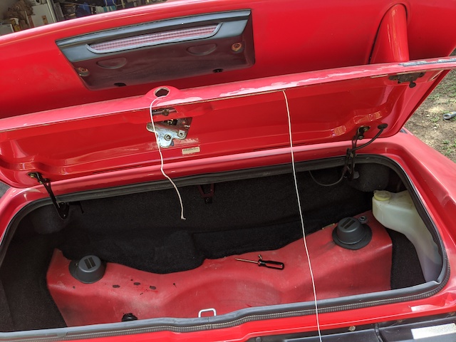

With the pile of parts mounting in the garage I was determined to start putting some things back on the car, so I decided to tackle the trunk.

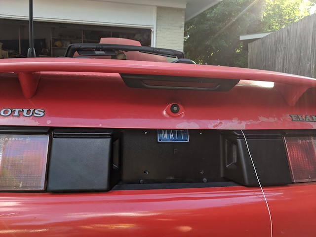

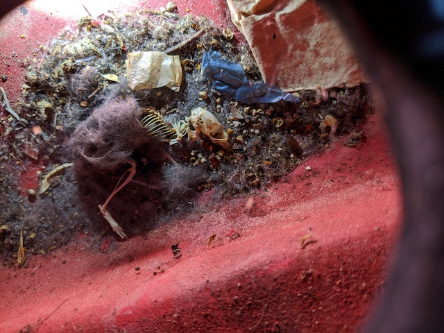

It was in a sorry, neglected state and I had even pulled the lock off the instant I had finally been able to open the trunk, months ago. I'd been nervous to put it back on and have it get stuck again, but I wanted it off the workbench, so I took a crack at it. First I just let the whole lock cylinder soak in WD40 overnight and then I could wipe a lot of gunk out of it. Then I filled it with graphite and the action seemed to work ok, on the bench at least. Then I cleaned out the trunk, scrubbing the fiberglass and I derusted and restored the spare tire mount and lugnut wrench while I was at it. It was also time to put Rosie the mouse to rest at last, may her spirit always watch over the car.
RIP Rosie the Mouse
With little Rosie taken care of (and surprised that the original spare tire was able to still hold air), I focused on the lock and how I could feel safe that it wouldn't get stuck again. I know eventually I want to put in a trunk release solenoid and button, but I have too much creep going on already so i just have a jury-rigged prototype for now. I was able to thread some string through the vent gaps and it attaches to the latch release, inside the hood.
There is a hole on the latch which looks like it is made for this and works great with a little tug on the string. Now I'm not scared of locking the keys in there or even if the lock seizes up again this is directly on the latch, so less things to go wrong. It also gives me a good idea for how I could run some airline cable with a solenoid for the electric release down the line. During this time I also had the joy of taking off the 11 screws, just to check on why one of the license plate lights wasn't working (loose bulb). While I was in there, I continued to clean and restore the trim. Very happy with the results of the Meguiars Black.
Yay, trunk cleaned, trim tidied up, and metal pieces restored/repainted.

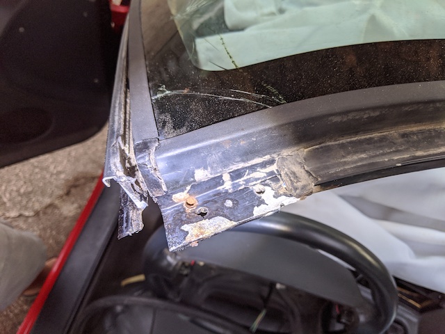

Then I thought I would be on a roll and go ahead and get the windshield glass replaced to make the front look better too. Called a glass shop and they had a piece in town, and could come by the next morning (why weren't alarm bells going off that it was too good to be true at this point?). I excitedly took apart the a-pillar seal and channel and interior trim, only to have the glass show up and be nowhere close to a fit. One of the sources has it listed that the Isuzu Impulse windshield fits as a substitute, but not this one. So that was very disappointing because I still have a cracked windshield and now there is even more crap that I've uncovered that needs to be fixed/cleaned. Some of the screws that hold the aluminum channel to the frame had completely rusted away and the biggest surprise was that the 'drain' at the edges hadn't just been clogged, but actually filled in with what looks like sikaflex. Its in both sides, so that is fun trying to dig out.
Surprisingly though, the seals came right out with no fuss or tearing, so I guess I'll have to nurse them along for a while longer, sorry Jaime ;)

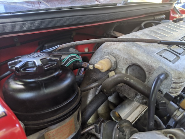

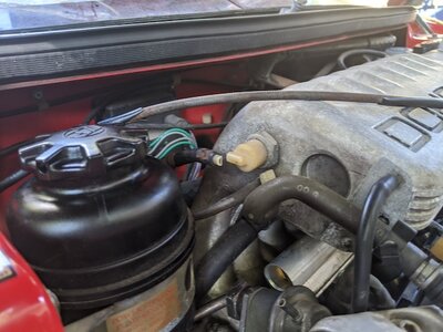

And I've sent off my fuel injectors to get cleaned, but in the middle of getting the fuel regulator off to replace, I managed to bust the infamous MAP sensor take-off. Doh.
I read a couple threads here of how to replace with brass. I'm wondering about just epoxying it too though... And any thoughts on soaking it in something to clean it out first before putting back on, or not necessary?

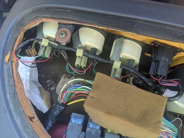

Finally, I'm trying to think of a better way to secure the gauges. Its been noted how crumbly the white housing plastic is, and once that goes there is nothing stopping the gauges from falling back into the console. I'd love tips if others came up with a way already. I'm thinking I might epoxy something to the back of the brace plate and come up with some new fitting for the metal stays on the back of the gauges so they are holding against compression and tension.
