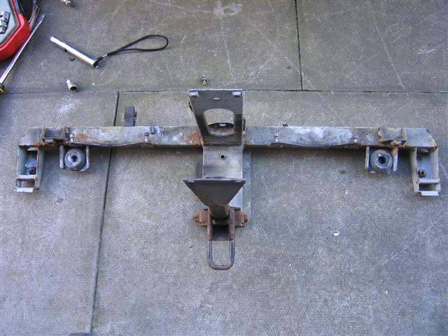

Back to my original query - :D
sussed it!
Check the rust out. This is from a 40,000 miler which has lived the majority of its life indoors.
I cant believe what holds the towing eye on (or what doesnt)
IMG_1191 (Small).JPG (63.26 KiB) Viewed 181195 times

What ever holds the towing eye on Paul, got me back all the way from Peterborough in Whitey mate !. Them radiator frames are still available , i got one for Blacky, think they were about £180 ?
Postby Darren » Sun 26.02.2006, 12:21
Dico,
I swapped mine with a second hand jobbie (don't ask) and it too was in a similar state to the one you have.
I gave it some wicked uncle with a wire brush, got my mate to sand blast it, covered it in rust killer and spray'd it with smooth hammerite (4 coats).
Needless to say, it didn't look like yours when it had finished.
As for the towing eye, I have to say that there doesn't look alot to it or the supporting frame when you see it out of the car but as Paul says, it must have been up to the job at one time :shock: .

Postby stevo » Mon 27.02.2006, 11:29
time to visit you friendly local galviniser

Postby Dico » Mon 27.02.2006, 14:56
Yeah just been, they will do the rad mount and fan cowlings for £40. Thats the minimum they charge so may even have been cheaper otherwise :?
But they dont do sand/bead blasting so need to source another company to do that Not easy when you work full time :( and babysit the rest of your available time :?

Fan cowlings, radiator support mounting and towing eye, shot blasted and are now at the galvanizers. :)
