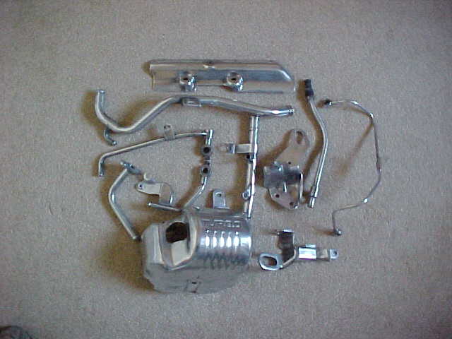

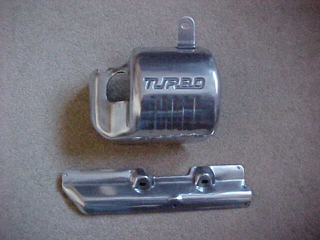

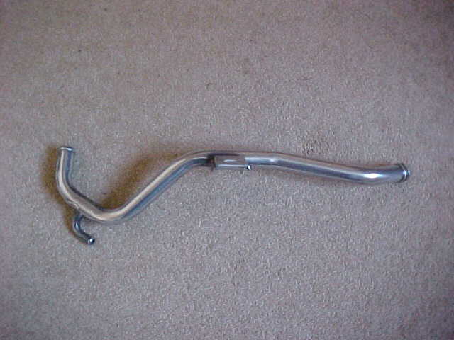

Ive had a few bits Cermakromed at Camcoat ( www.camcoat.com ), to stop the onset of corrosion. In particular the big water pipe that runs under the exhaust manifold, a new one from Lotus is approx £250 now, so the £170 that this little lot cost , was good in that respect. Anyway if anybody's interested in having any done the bloke to speak to is Barry 01925 445003. I found these people to be very helpful, i sent them the bits for a quotation, which THEY rang & gave me, they said it would take approx 2 wks, which it did, they then rang me when they were done, i paid, & they arrived 2 days later, all in all very satifactory & efficient !. This is the same/similar to the US jet hot coating.

Paul, that looks good. Experience tells me that anyone can spray ceramic. Where vendors come short is either:
1) Not prepping the part, like removing rust.
2) The metallic ceramic must be polished to acheive the "chrome look". I received one from a bloke in Orlando years back that was coated but not polished, and it was just an ugly matte gray.
At this point you can use metal polish to clean the part or to remove surface rust. These will develope light surface rust if left damp, but the ceramic coating will never rust-through and is quite thick.
JH is the only "ceramicker" which claims they use a flow-though process which coats the inside of pipes. They won't do it down to the diameter of the turbo oil line, but they did coat the inside of the long water-pipe you mentioned. If you think of a paint-gun, other vendors just state they spray 'up-pipe' as far as the spray-gun can reach. JH also did a nice job of polishing even the inside of exhaust tubing, as far up as I could see using a small light on a string. That kind of detail gives me a boner.

Postby Paul.P » Thu 13.12.2007, 21:44
Matt, these are like a dull chrome ( greyish ) effect, are you saying if polished with something like Autoglym, they will come to a bright shine ?.
Must admit, main reason i had these done was to preserve the parts, but better looks is always a bonus .

Nice job Paul. Did the £170 include all the prep work or did you do that yourself?
