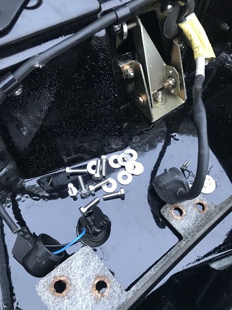

Progress is in fits and starts under lock down as I wait for bolts washers fittings etc delayed due to Covid 19.(Waited 2 weeks for M6 Long Jack Nuts)!!
I am trying my best to replace all original bolts, nuts, washers, fixtures and fittings with Stainless Steel.

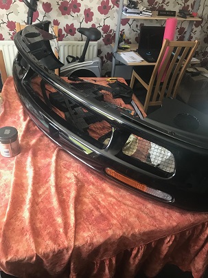

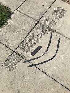

I've been making new bumper grills to the pattern of the originals using the same 19g mesh only using stainless steel mesh instead of the cheap original chicken wire, then painting them black to match the SJ Sports Cars centre grill I bought.

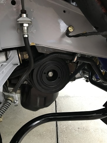

I've cleaned up the crank pulley and re-painted it polished the crank pulley nut and clear lacquered it before refitting and torquing it up.

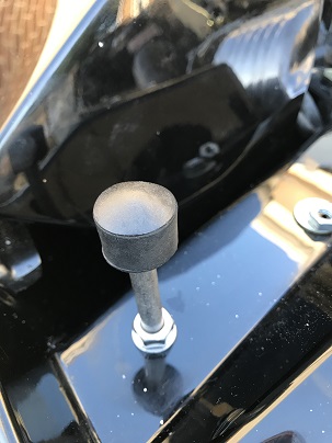

The front clam has foam fitted and is shimmed up ready for final bolting down with the stainless steel bolts on order and mew spire M6 fittings on the tub. I am copper Slipping all fittings before bolting together.
All the time I've been trying to source missing small parts no longer available. Simon P has offered me a set of A post gutters Cheers Simon :cheers: another LEC member has offered some red carpet when he gets the chance to check what he has which could be amazing if it comes off as my search for the original spec to match the new carpets Jamie fitted is proving impossible. The LEC community is brilliant. :bowdown:
I will provide photos soon. The wiring is now clipped to the underside of the clam and fed through to the engine bay :D New P clips have just arrived to start clipping it in the correct places.
Photos to follow soon :D :D :D
Grills resize 1.jpg (43.83 KiB) Viewed 25363 times

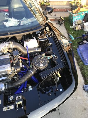

Ok progress is slow because I am constantly thinking is this how Jamie would have done this. I am posting some photos of the slow fitting and re fitting up of the front clam. I will post photos of various parts of the build including bumper grills and lower spoiler clamp plates. Photos of the front clam gradually being built up with wiring and H Lamp pod mechanism again using stainless steel bolts and washers where ever possible. As usual I have some parts requests :oops:

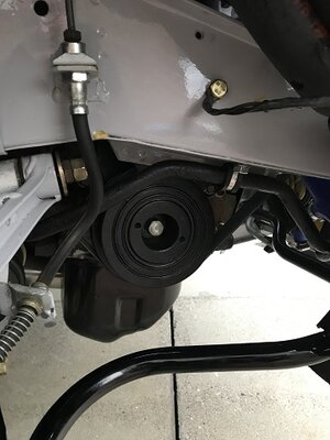

Crank pulley with polished bolt and crinkle finish lower PAS pipe

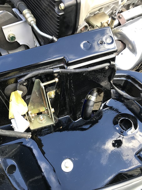

Postby Mike Y » Fri 22.05.2020, 22:43

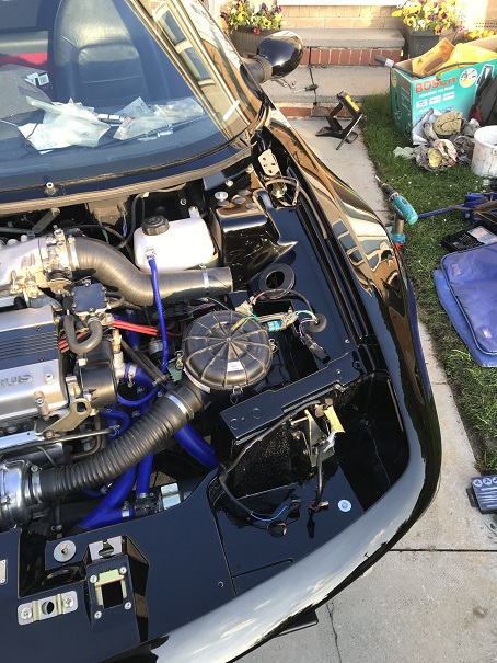

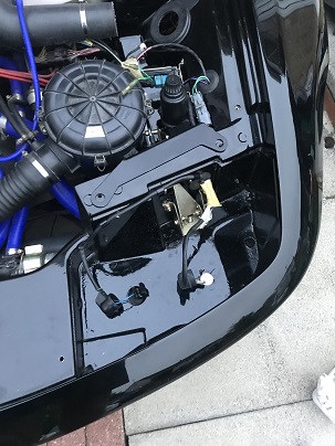

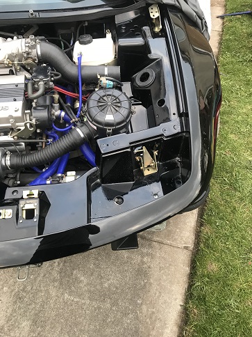

The next few pictures are of the clam fitting gradually getting new fixtures and fittings added and wiring fixed in place.
New wiring P clips and H lamp covers fitted

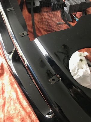

Bumper with new fittings
Clam With some Fittings

Postby Mike Y » Fri 22.05.2020, 22:59
More bumper build up photos

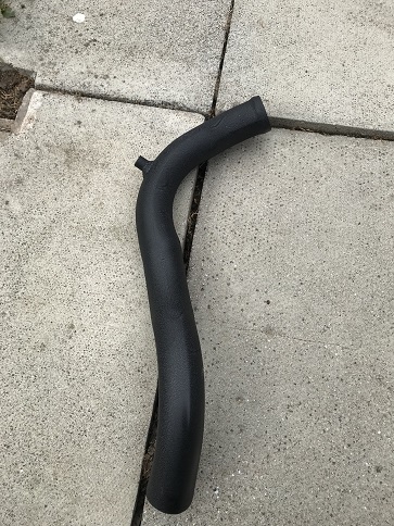

Postby Mike Y » Fri 22.05.2020, 23:04

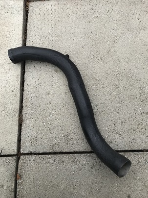

Inter cooler Pipe I've finished in crinkle black to try and break up the gloss black of the car and also add a nod to the earlier Lotus models that had crinkle black cam covers etc. Its also extremely heat and chemical resistant.

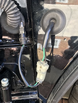

Postby Mike Y » Fri 22.05.2020, 23:08

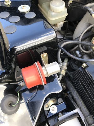

Clam with the wiring partially fitted

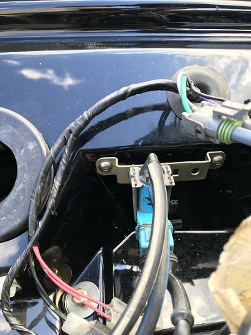

Postby Mike Y » Fri 22.05.2020, 23:19
OK now parts request time.
1) I am still looking for Door red carpets and map pocket. I can make these from floor carpets etc if anyone has any in their parts store.

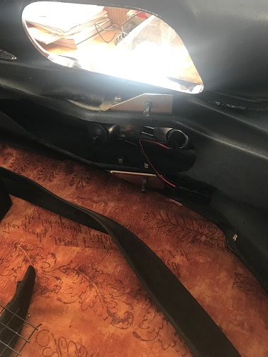

2) A excellent pair of "A" panel indicators
3) Piece of wiring loom with the A panel bulb holder and both sides male and female plug in connector housed behind the A panel as per photo.
Cheers Guys

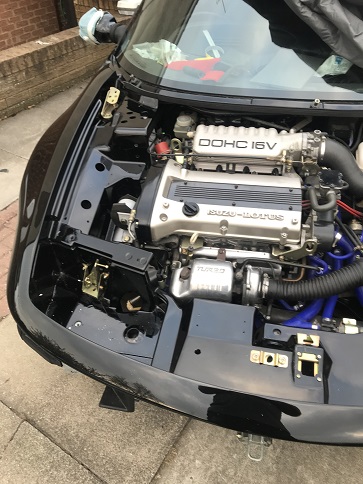

Having shimmed the clam shell up and left it overnight I pulled JUFs out the garage the following morning and was not happy with the fitting so started from scratch again. I was struggling to get the N/S Clam gap correct to the door. I then realised a seam of Sikaflex on the body tub scuttle panel had been overfilled preventing the clam moving back against the scuttle panel properly. A day later and I was finally happy with the gaps.
final panel gap

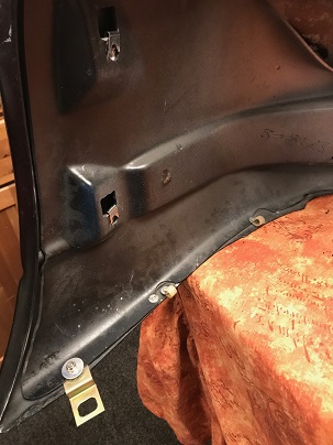

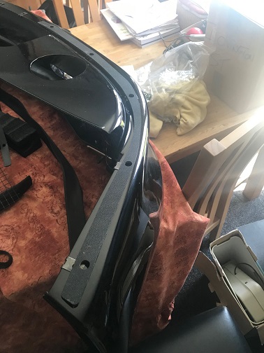

This is an earlier clam than JUFs later production spec so this clam was not factory fitted with front bonnet support posts. I measured the points to drill using many photos. Once the wholes where drilled I Sikaflexed sighted M8 nut plates on the underside of the clam. The posts with rubber buffers are as you might guess Stainless Steel but, unlike the originals which are fully threaded the whole length I am using bolts that are only partly threaded enough to allow the required height adjustment while looking smooth and much tidier than the originals.
