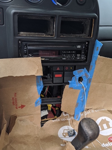

When I got the car, you could notice there were sticky stains on the fascia and upon closer inspection, lots of the interior trim pieces were loose. There was some sort of goopy mastic that was used to hold/bond many of the anchor points onto the fascia trim and other bits and bobs, but after 20 years of sitting in the sun of over 100 degree summers, has melted and made a general mess of the interior. It's sticky and tacky, but not strong enough to hold those anchors points any more, so just generally annoying. In my quest to restore Rosie, I've been trying to clean it up and fix the trim anchor points so things stay together too and I made some progress, and discoveries when working on the center console.
You can see how goopy it was, just dribs and drabs everywhere.
I tried lots of things to clean it, but so far baby wipes have worked the best.
In order to clean the fascia and the vents, I took parts out to clean them. In the FED version we have a blank for what I imagine is the space for the rear fog lights control, and it looks like there is some wiring in place. What was really confusing me though is the wiring behind one of the blanks in the 'double blank' slot... :?
I guess there was also some holdover from the Ford Cortina partnership? :smt017
With the majority of the mastic removed, and the vents cleaned out, I was able to prep for epoxying some of the anchor points back to hold the console fascia in place.
And the result is that now the fascia is actually held back in place, flush with the dash, and I've at least gotten rid of the visible glue (still need to spruce it back up, but it is a start). And the fun bit is that while I love and am blown away by Elanlover's fascia remodel and GPS/infotainment integration upgrade, I had a slightly lower budget for comfort improvements right now. So my interim solution is that for $10 on Amazon I found a phone holder that normally clips on a vent. I was able to friction fit the vent clip 'base' into the gap for one of the switch blanks and with all my surplus HDPE lying around (yay tank fuel tank repair) I was able to easily make a custom blank cover to hide it. Now I have a phone mount that sits far enough back that my hand doesn't hit it during gear change, and I can always revert back to stock if something better comes along.

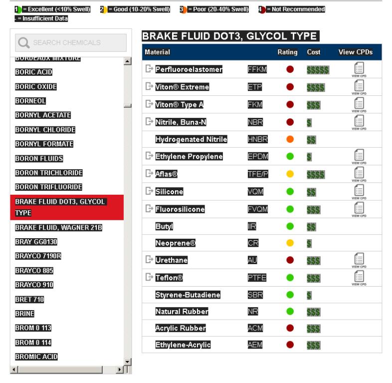

Postby Brit-Car-Nut » Tue 11.08.2020, 22:09
Maybe this chart will help?
Click for larger view

Looks like Viton's out

Re: Rosie's return to glory
Postby esprit888 » Tue 11.08.2020, 22:19
Yup,
Did that already, with mixed results as a lot of the info is old and materials have changed along with fluids. This one is really good:
https://www.sealanddesign.com/page/fluid-compatibility
but....... it states VITON is NOT compatible, while other sites say: VITON is incompatible with petroleum (oil and gasoline), but it is compatible with alcohols (ethanol, methanol, and nitromethane), water, coolants (both ethylene and propylene glycol), and glycol-based brake fluid ....and as DOT 3 is glycol based, its a contradiction between the two.

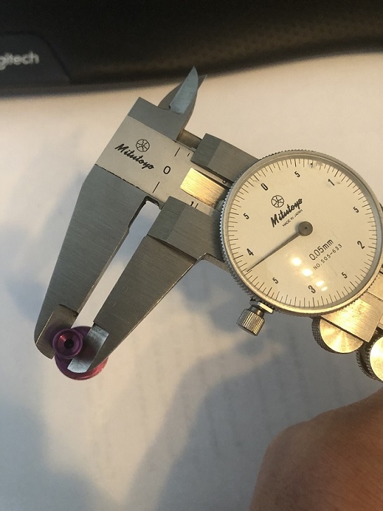

Its very (very) close and comes in at 3.683 (landing is 3.825) and it has a slightly thinner CS (1.778) the total OD is 7.239 and as best I can read on a 30 year old O ring the OD of the smaller ring is 7.74, it may be worth a try and then stick it on a rolling road to test its efficacy but it would appear at first glance to be (literally) a hair too small on the OD. It should not be necessary to split the front section of the valve so the seal should not need replacing. Now this has obvioulsy been tried before and there are several threads, this one in particular ( https://forum.lotuselancentral.com/view ... =41&t=8489 ) So i will just say again that any changes or repairs to the brake proportioning valve can result in serious injury and are done at your own risk!. That being said the valve itself is not being altered or modified in any way (it cant be, its inside the sleave and inaccessible, it is only the sealing O rings that stop fluid from leaking into the spring chamber that are being replaced.

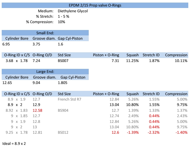

Postby RonR » Wed 12.08.2020, 23:09
Another lock-down pastime for me was trying to calculate the prop valve O-ring sizes.
I used the O-ring calculator Here
Here's what I came up with for what it's worth:
