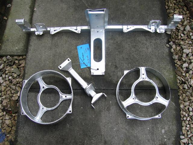

Postby Dico » Sun 19.03.2006, 21:52
Back from the galvanizers.

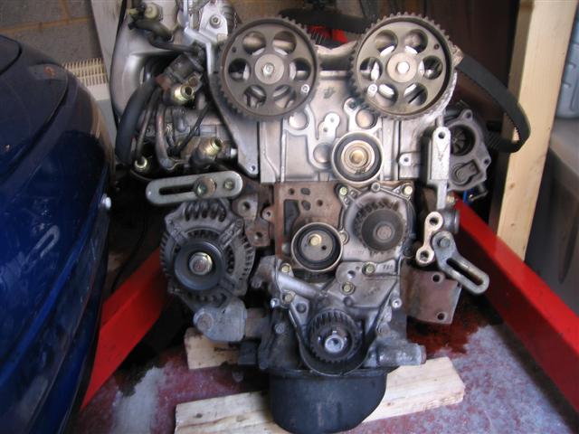

Managed to undo the idler/tensioner (splined) bolts today. The idler bolt was unbelievably tight!
New idler and tensioner ordered - £$£$£$£$ !!! :shock:
Note the engine oil, which leaked out of the flywheel bolt holes after they had been removed.
After 7 years of use (20,000 miles) the cambelt was still in very good condition. Being changed though.
Picture 045 (Small).jpg (56.17 KiB) Viewed 172645 times

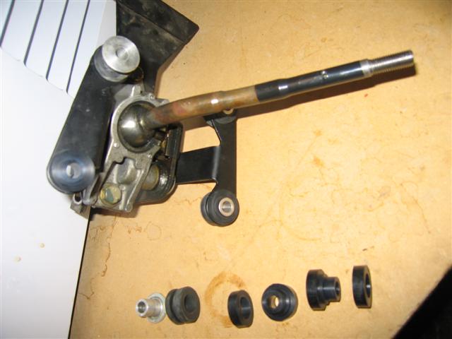

How on earth do you install the Alan Betts nylon bushes into the gear leaver mount? (the ones that replace the rubber bushes) I would post a pic but the digital camera is in mrs Dico's glovebox :?
I dont see how that even if you did manage to remove the original rubber ones, (which appear to be in one piece) how you would fit the nylon ones in their place?
I'm obviously missing something here.... Help!
edit-
erm... sussed it! pretty obvious really :oops:
The metal insert in the original rubber bush can be removed enabling you to 'squish' the rubber bush out.
The new one isnt one piece as i assumed, but splits into two, making the job straightforward.
Alls clear after a sausage roll and a cup of tea :)
A picture would make all this a lot more clearer for anyone who has'nt yet done it.
One will follow shortly.
The reason for changing these is that the nylon bushes apparently give a more positive feel......... i'll let you know :)

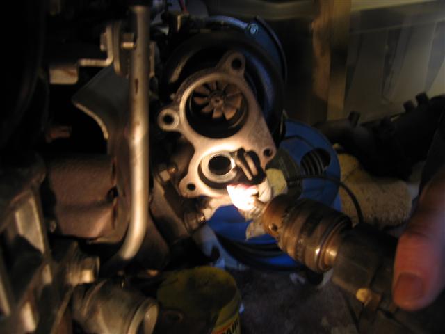

Postby Dico » Sun 02.04.2006, 16:52
The turbo wastegate has been ported (drilled) from 16mm to 20mm to prevent boost creep, which 'may' happen after fitting a larger bore exhaust or increasing boost.
The only real way to do this is to remove the turbo from the engine.
(my engine was removed)

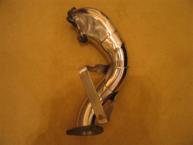

Postby Dico » Sun 02.04.2006, 16:55
Stevos aftermarket downpipe -
Stiffy prior to being ceramic coated

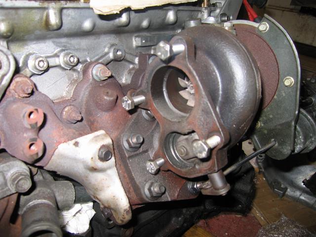

Postby Dico » Sun 02.04.2006, 16:59
The original studs have been replaced with stainless bolts.
Note that the bottom left one is shorter than the other 3, as this is the only one that does not protrude through the turbo casing.

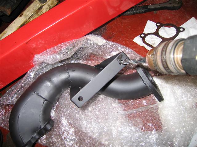

Postby Dico » Sun 02.04.2006, 17:03
After initial fitment i found out that the stiffies bracket which secures it to the engine block had too small a diameter hole. Removal was the only way i could drill the holes larger :?
