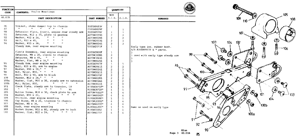

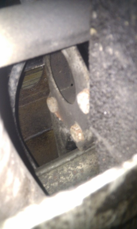

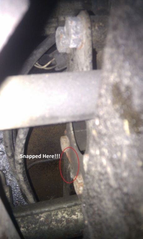

Crap it looks like I've had the Rear Engine Mount Steady Arm snap on me.
I can only find one replcement here www.elise-shop.com/a100a0917f-p-345301.html, want do people think about the option of welding the current one back together??

The old part number was A100A0571F. It is replaced by A100A0917F. It is available from Lotus for £200.62.
Not cheap, I know, but at least it is still available. Call Robert Chapman at Stratton Motors if nobody wants to help.

Not the sort of part we hear about failing very often :?
Seeing how 'solid' it looks, i'm not sure that a welded repair would fill me with confidence - it may have weakened elsewhere and fail again. (of course, I could well be wrong, and if someone else has actually studied the stress dynamics and says it'll be fine, then i bow to them).
I think that there is probably an underlying cause, and this is the symptom - has there been a period of 'rough running' and vibration? Are the other mounts/shock/struts attached properly? etc etc
Anyway - just been routing through the boxes, and i don't have one of these, which is annoying, 'coz i thought i had.
As i say though - it's not a common failure point, so there must be some out there :poke: :poke:

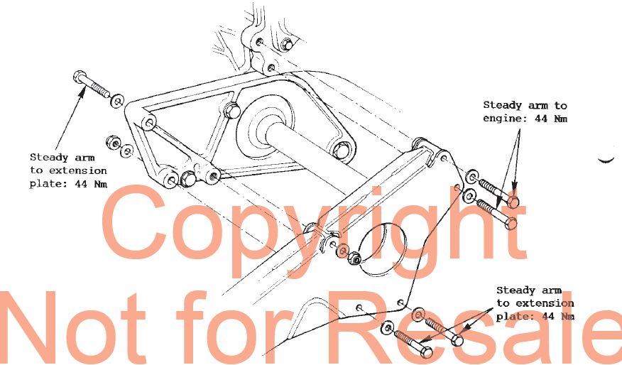

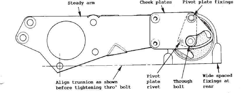

If this is the engine mount that attaches the gear box to the chassis, you may find the trunnions have gone and are still available but you need to determine which type of engine mount you have.
There are 3: Early, late and Fed.
Let me know if this is the engine mount you are talking about and I can help. :wink:
If it is this mount then the later type has a crash mechanism where by 2 shear rivets fail and allow the mount to rotate, I had one from Dave T's old car and the rivets didn't fail but the trunnion plates did. I re built it a few weeks ago and now fitted it on my Kit car project.
If you car has had a front end collision at some point it it likely this is the case but should have been rebuilt at the time.

Phil, he means the mount that comes out of the center of the chassis like a claw and attaches to the engine plate.
Page 4001B, item # 95 (on the right)

The later type is shown here with the trunnion Check plates (102). These are designed to rotate in a collision sheering off the rivets, mine were bent and the rivets held which is probably due to the impact being to the side rather than a direct frontal collision. I bought these from Lotus recently although the button head screws (103) were not available. Early cars don't have this type, check the vin to see which yours is (late S1 and S2 will be later type).
If this is the same as Blackie then hopefully it is this simple but you may want to check the 4 bolts (104) under the chassis to see if they are all level and there is no distortion to the chassis floor. I think this car had a collision so it's likely you need to rebuild this and asses the damage. I got the 4 bolts from Lotus too.
The bad news is, its hard to get to with the car pretty much built around it.

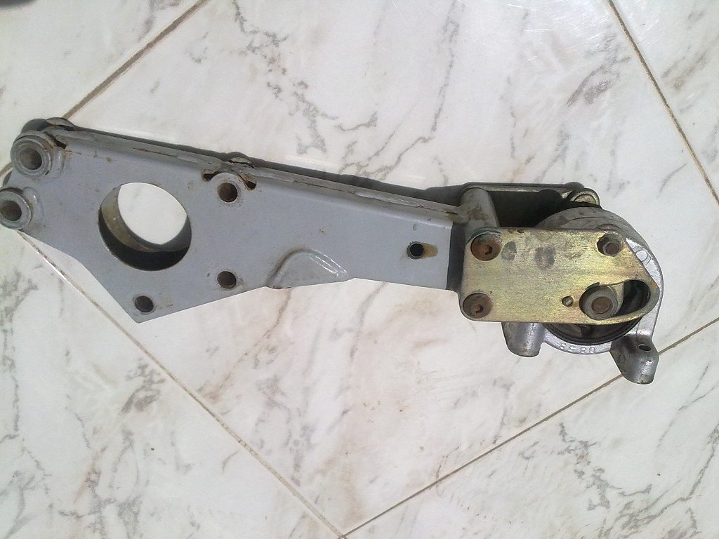

Sorry i'm a bit late viewing this thread but I have a good condition 2nd hand one that you may be interested in
if it will fit.
I guess it's the later type that was described with check plates. Removed from a 1992 car

wayne wrote:Sorry i'm a bit late viewing this thread but I have a good condition 2nd hand one that you may be interested in
if it will fit.
Yes that's the later one Wayne.
