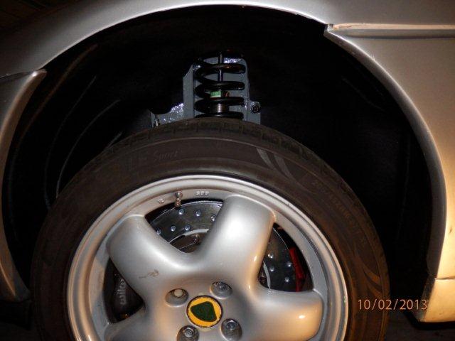

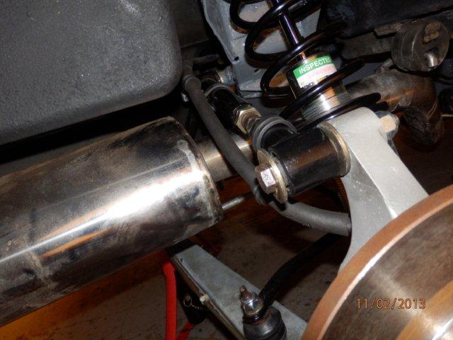

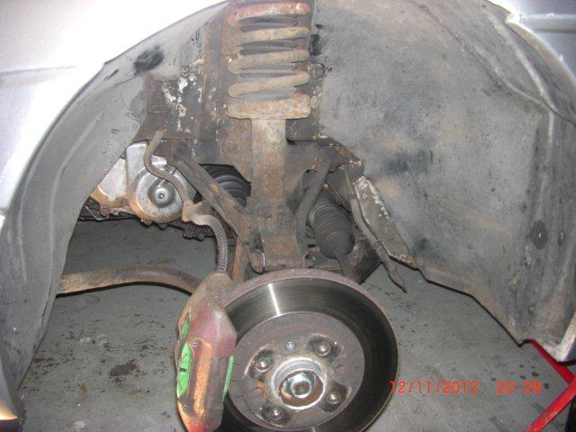

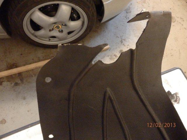

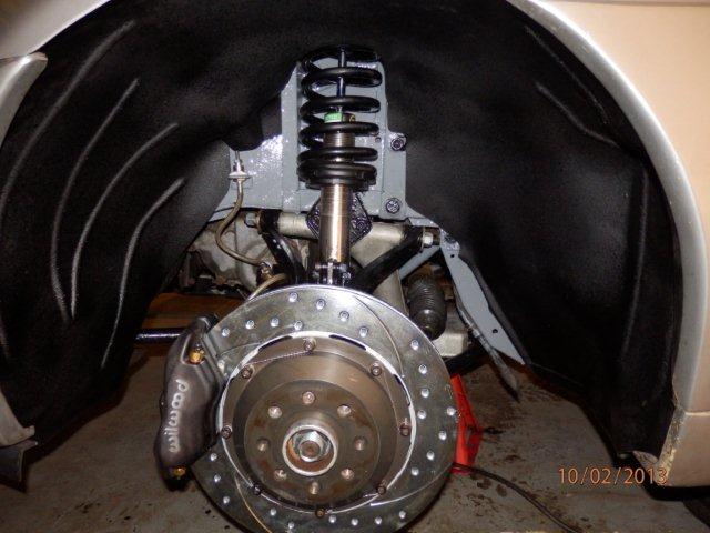

Today was a going backwards day. I had installed the shocks with the adjusters facing outwards, making changing the settings very difficult. Brakes off, upper wishbones etc, shocks repositioned and all back together.
LH brakes fitted, system bled, still a bit spongy but have ran out of fluid so that's on the list for tomorrow. Bled the power steering, it feels much better than it used to, no leaks & new fluid works wonders.
XIL started first time and I took her to the end of the road and back (one of the good things about living in the middle of nowhere). Brakes ok but spongy, a water leak and a clunk when braking. Everything needs re torquing and the Samco hoses were fitted but the car has not been used, so hopefully a quick fix.
This it what makes it all worthwhile.
Before
After.
BFG's liner kit is great, really looks the part.

No, mine are just cleaned and sprayed with this:

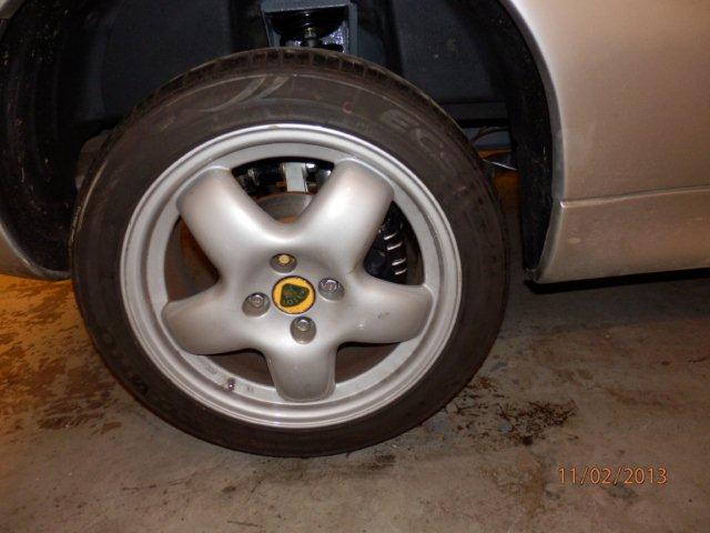

Postby cliff » Fri 15.02.2013, 19:52

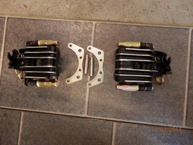

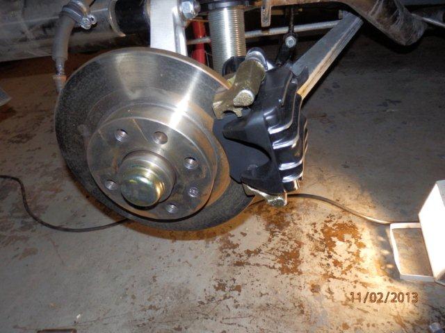

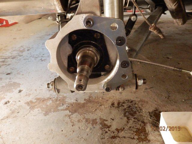

Fitted these.
New bracket.
Calipers.
Slight re-routing of the handbrake cable.
All done.
Brakes bled with no problem, even the Wilwoods were ok despite what I have read on here. The pedal travel seems about the same as before, I do have the 6811 calipers though. I have only done a few miles so far but I am pretty happy.
Last little job before going back to work.

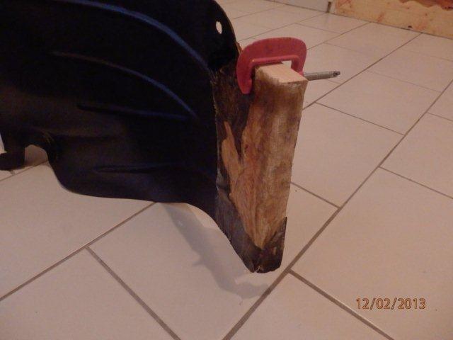

I will never be the world's best with glass fibre but it has to be better than a hole.
That will dry while I am away and a bit of Tetra-Schutz should hide a few sins. :)
That, I hope is it for a while. Tracking & MoT booked for the end of February then should be all good for the summer and at least 1 trackday.

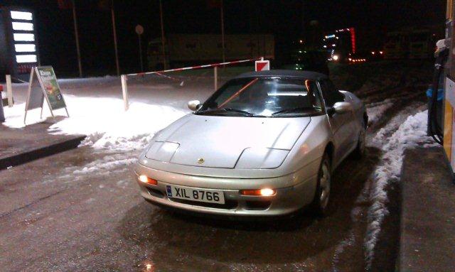

Just over 900 miles this week, Frankfurt, Cologne, Calais, Scunthorpe, Cardiff.
Stopped for fuel in a very snowy Aachen
MoT (yearly inspection)failed, a couple of small things, windscreen washers due to a split pipe near the left side bonnet (hood) hinge and a brake pipe seep. Both quickly cured and a pass cert. :banana:
After the modifications, all new brakes, Everest & O2 sensor modification, Piper downpipe & exhaust, a couple of things are noticeable.

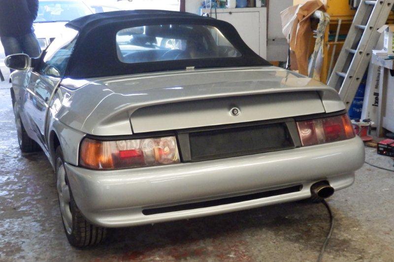

Postby cliff » Fri 15.11.2013, 18:39
A quick update.

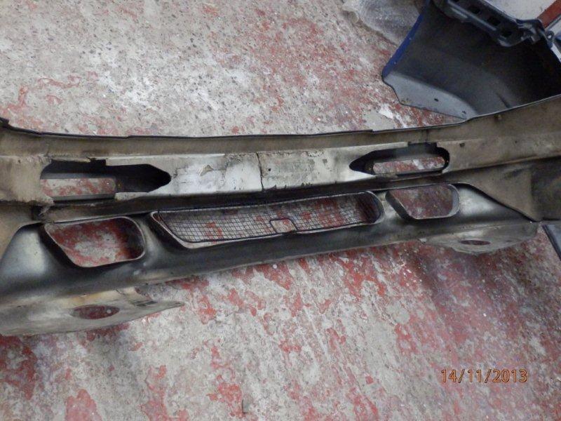

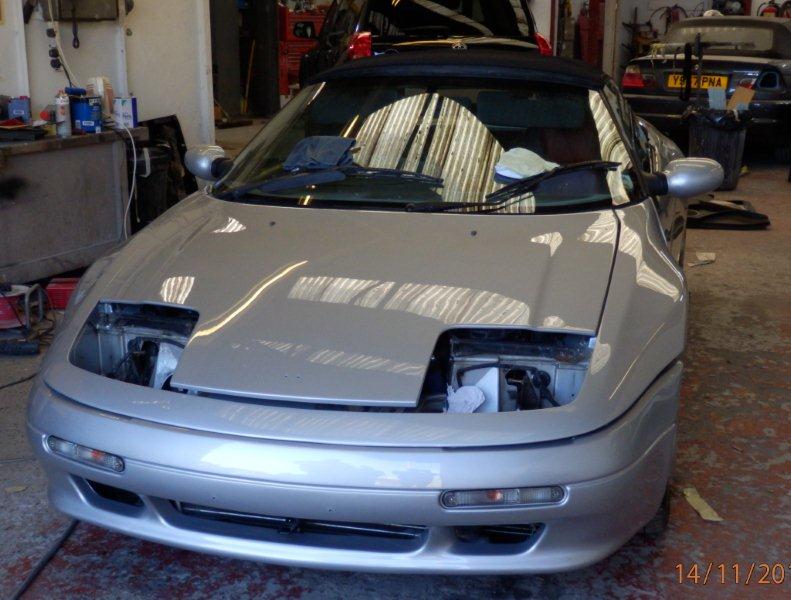

The front bumper was in poor condition, I don't know what had happened to the mounting points but it had been bonded onto the clam! Thanks for the new one Andy.
Rear looking nice & shiny, the old lights let it down a bit though. I have some pods I bought from Chris last year, they have been sprayed to match the car. Elise lights coming soon.
Light pods to fit, grills to be fitted, indicators put the right way round, bumper on and we are almost there.

Quick update, car has been collected by Andy at QMech from what ultimately became respray and storage. Thanks to Chris at Auto Body Spray in Cardiff for letting me leave it there for those extra months.
Qmech are doing full suspension geometry, service & MoT. A few little things to do, not surprising as the car has been sat for a while, worst of all is a seeping oil cooler. Quick call to Coolex, luckily they had one in stock and it will be delivered tomorrow, thanks to Steve and everyone else at Coolex.

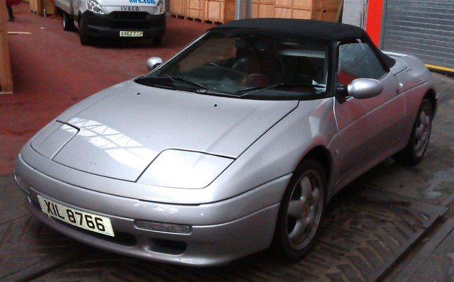

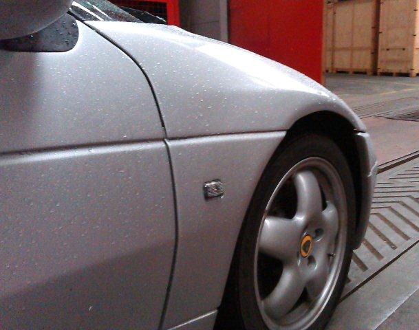

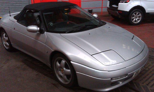

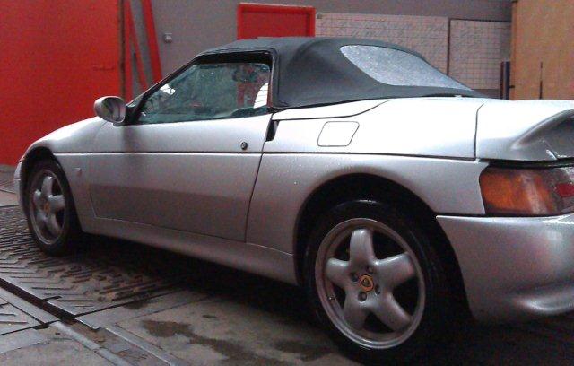

It was a clear bright day when I left to pick up XIL, but as I crossed the Welsh border, the heavens opened. My thoughts of having a play with my newly set up car evaporated, unlike the rain!
QMech have done a full suspension geometry, corner weights, service and also did the MoT for me as well as replacing the oil cooler. They also replaced the drive shaft and jack shaft after finding it sheared behind the circlip retaining groove. Even in the wet the car feels fantastic, looking forward to some dry weather so I can really play. Brilliant guys, many thanks for your great work and your obvious enthusiasm for the Lotus marque.
Full of great ideas about some inspiring pictures with the beautiful Welsh scenery in the background, the rain put a stop to that, so here are a few in the covered storage where she will be living for a few weeks.
Pics taken on my phone, so not the best and the car is wet, some panel gaps need to be tweaked as well. I really like the clean look of the clear indicator lenses, suits the silver perfectly.
The pods to fit Elise lights are sprayed up ready to fit, I have a set of the S1 lights but have already decided I am going to fit the S2 LED ones. Because I like the clear fronts, I am seriously thinking about some clear LEDs for the rear, not sure if it will be too much. Comments gratefully received.
The front badge was not worth refitting so another one will be ordered and fitted. The rear badges haven't been fitted yet and I am leaning towards leaving them off.

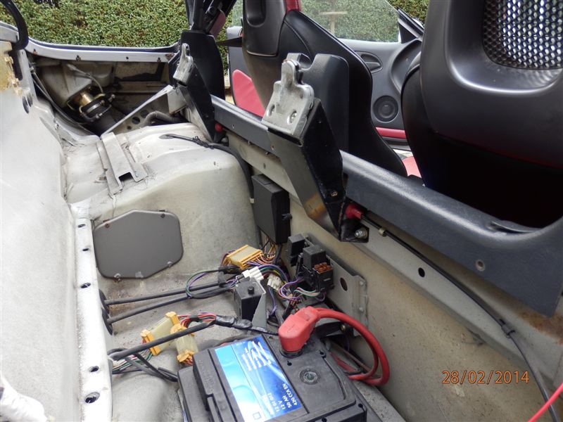

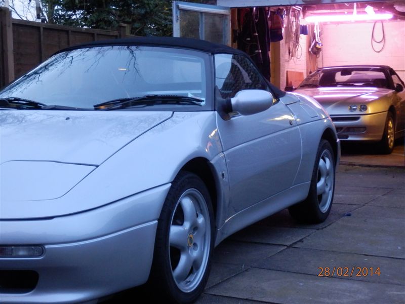

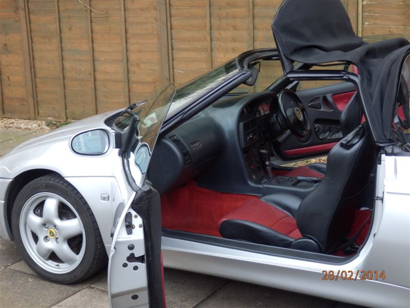

Postby cliff » Sat 01.03.2014, 12:48
Toad alarm fitted by Secure a Car in Stafford. Button 3 on this system can be used for remote boot unlocking so I asked them to leave that wire available for when I fit the boot release solenoid & relay.
Great weather so time for a good clean and some silicon grease on the seals.
Looking better, my other project in the background.

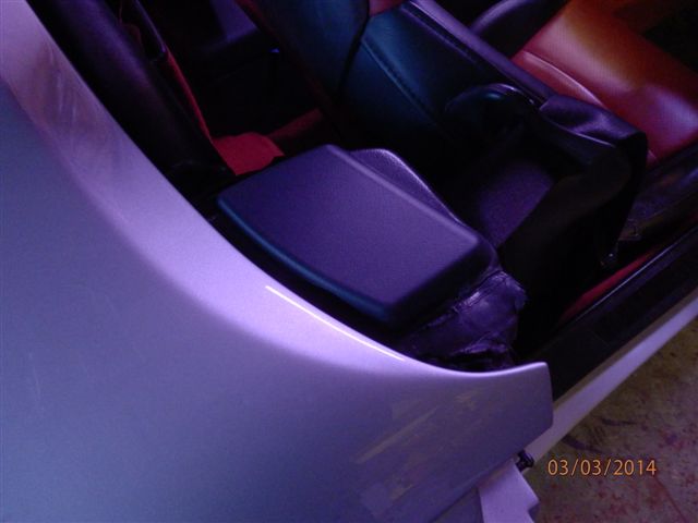

After stripping out the hood stowage area to repair the release cable it could be a good time to change the fuel filter.
I am itching to fit these, thought I would see how they look.

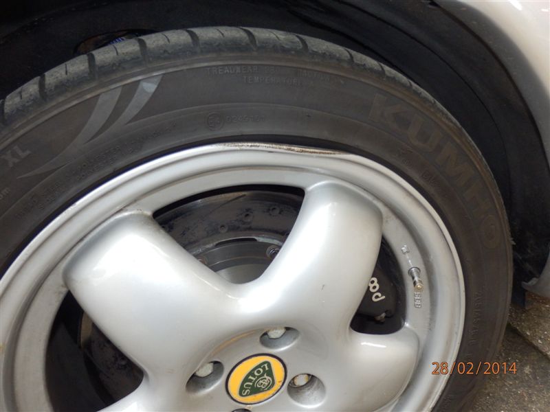

Aftermath of hitting a pothole yesterday - not impressed.
Luckily the wheels have not been refurbished yet and this should be repairable.

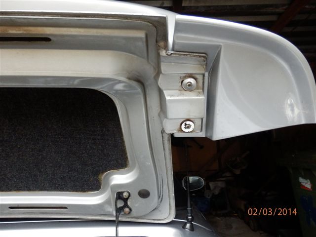

Boot rattle, spray shop forgot about the boot lid stop. These are available from SJ's.

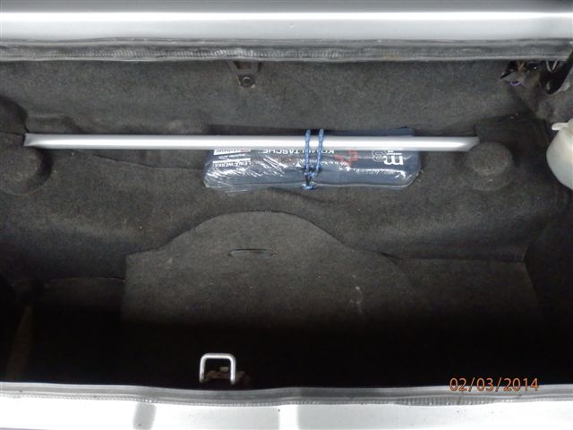

Dave M's strut brace fitted, now have a great place to stow the warning triangle & FAK.

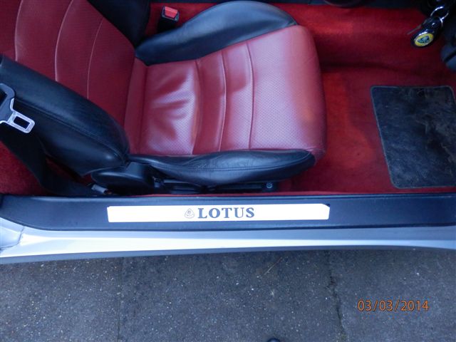

Wayne's B post caps & sill plates fitted.
On my other car the sill plates get scratched by footwear so have set them back a little to try and avoid this, they really look good. Once again, many thanks to all involved in organizing the group buys.

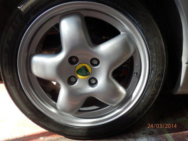

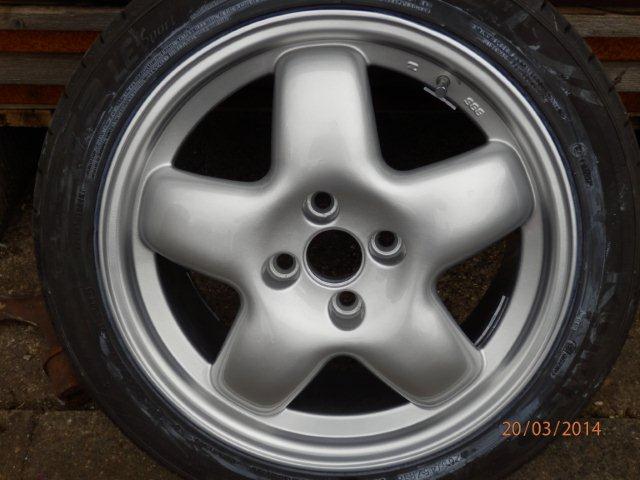

1 wheel repaired and 2 refurbished by the Wheel Specialist in Scunthorpe, the other 2 go in this week. I have had 5 sets of wheels refurbed here, they do a really good job.
My colour matching skills did not work out so well, they are now a lighter more metallic silver but I really like them.
After reading this thread:
viewtopic.php?f=8&t=22923

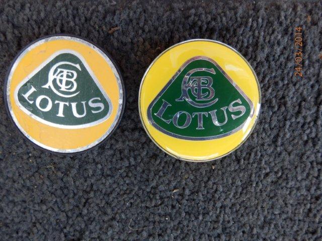

I ordered some Gel Logos, rubbed down the surface of the old ones, stuck on the new ones and ended up with this.
Fitted.
Very happy with these, many thanks to KevB

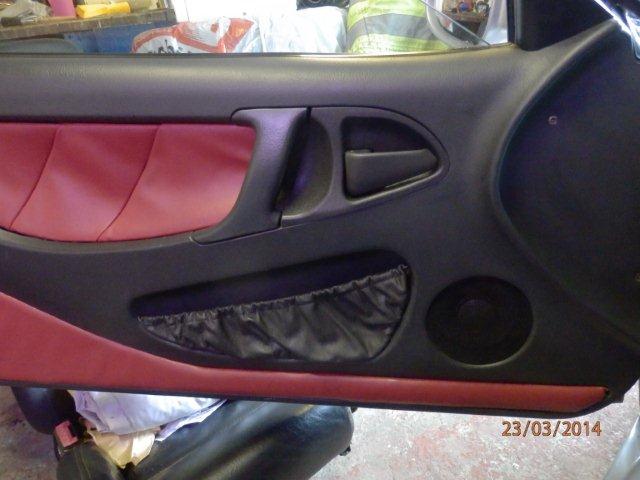

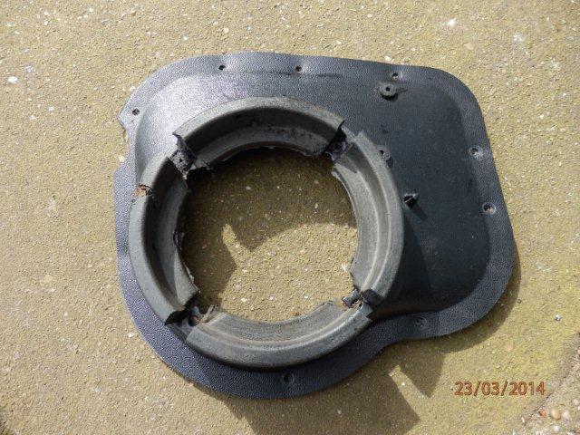

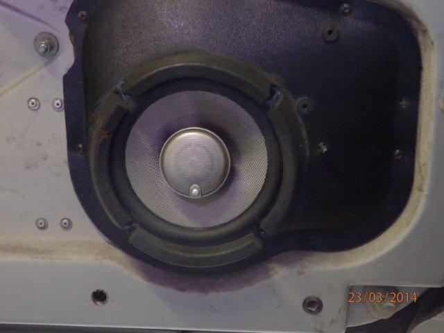

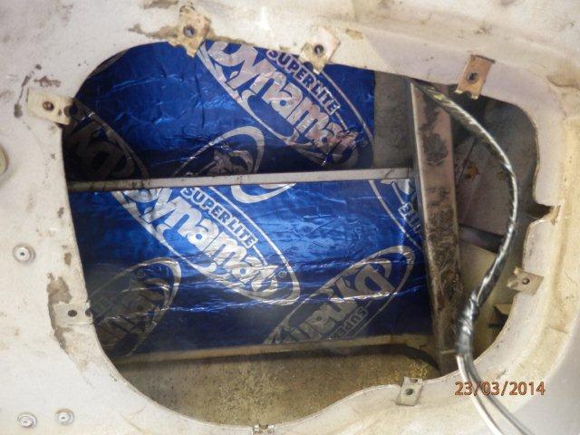

Some time ago LGM recommended fitted 5" speakers in the doors. A really easy mod and it does improve the sound a lot, thanks Marie.
A bit of trimming and 4 holes.
Fitted some Infinity Kappa's, all done
As I had it lying around, I also put some Dynamat behind the speakers. Not sure if it will make much difference but for the sake of a few minutes, worth a try.
A good time to fit Wayne's escutcheons, sets the door off nicely.

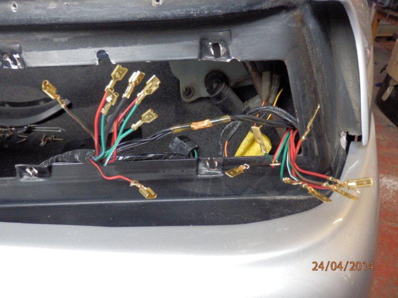

Postby cliff » Sat 26.04.2014, 17:57

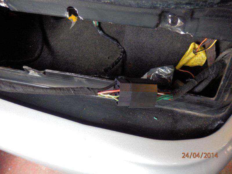

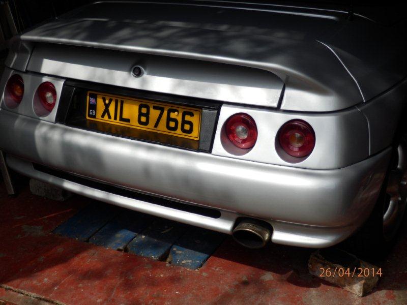

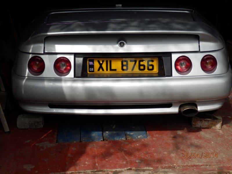

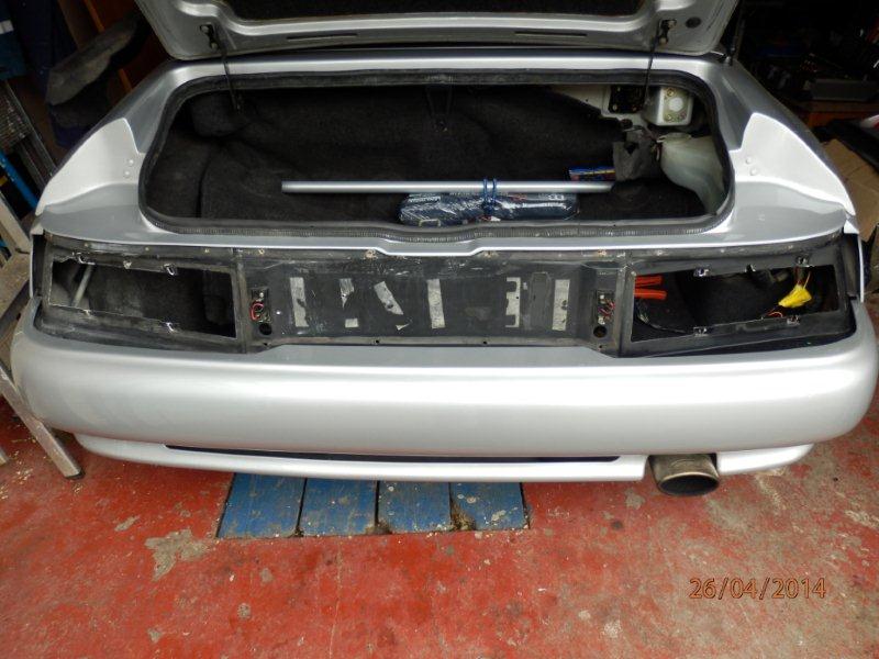

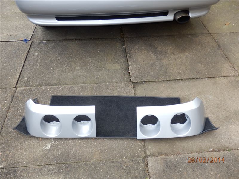

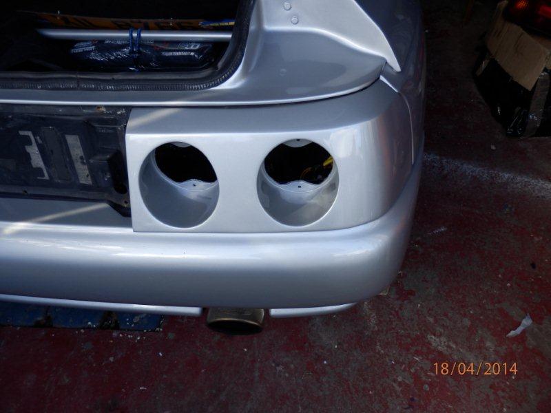

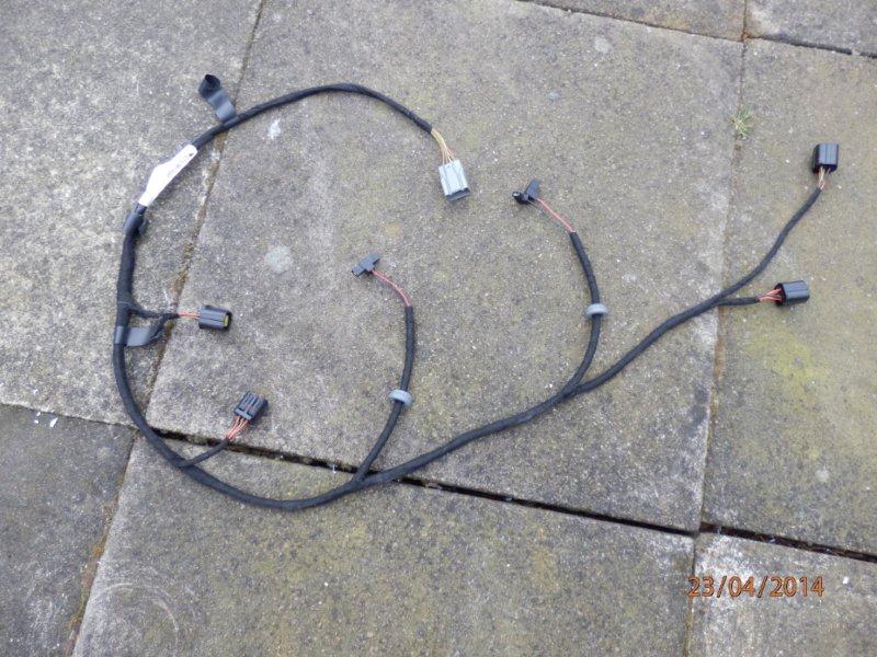

Elise wiring loom, C117M0004F, about €54 but worth it as it comes with the plugs and fits the Elan. I only had to replace the main & number plate light connectors.
Lights removed.
I wanted to make this reversible, so split the wiring loom near the washer bottle. The Elan loom uses more earth wires than the Elise one, so I chose one and left the others in place.
Added plugs to the old & new looms, a bit of fabric looming tape tidies everything up.
Trial fit.
All done.
Still have to adjust the boot & spoiler gaps
Pods were made by Chris P, brilliant job, many thanks.
I think this makes the rear end look much cleaner, I have been looking for some LED's but at the moment I am very happy with these lights. I also had a new number plate made with a black border which really suits the black housing.
