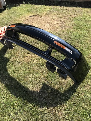

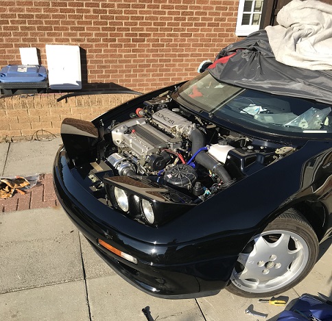

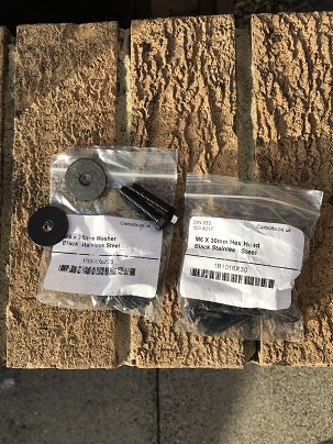

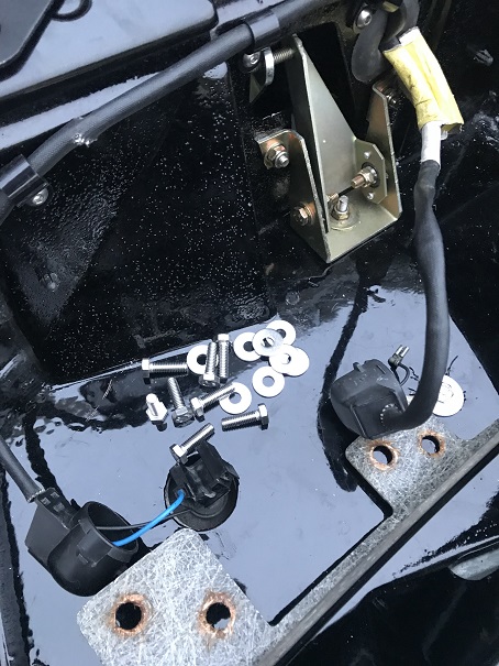

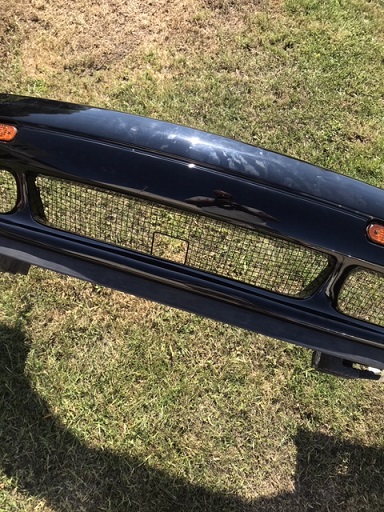

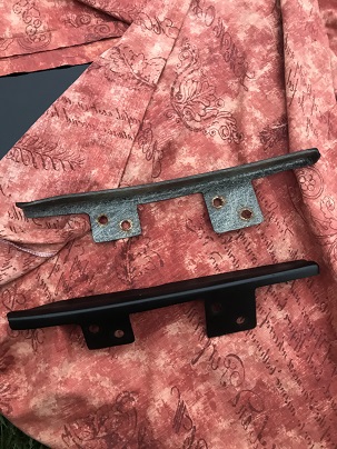

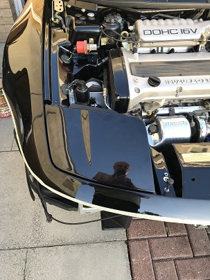

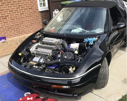

I trial fitted the front bumper before Sikaflexing the grills into it ready for its final fitting. While the Sikaflex was curing I fitted both clam headlamp infill panels with stainless steel M6 bolts coated with copper slip to prevent the new aluminium M6 Jacknut inserts reacting and seizing the bolts in place should they need to be removed at any time. I have done the same with all fittings where possible. I then fitted the headlamp pods and set up the panel gaps. I bought some black stainless steel M6 bolts and Washers to finish the fitting of the headlamp pod hinge brackets properly. (Images are in reverse order) :banghead:
Headlamp pod fitted
Infill panels ready for fitting
Bumper with new grills fitted
Bumper Trial Fit

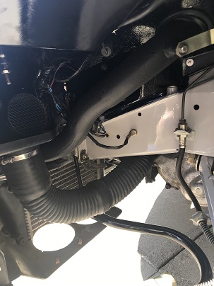

Surprisingly fitting the metal intake pipe from the intercooler through the clam to the engine intake proved quite tricky to make sure it would not rub on the intercooler pod or the aperture it goes through the clam into the engine bay much swearing, pushing, pulling then loosening and restarting the whole process to get it just right.

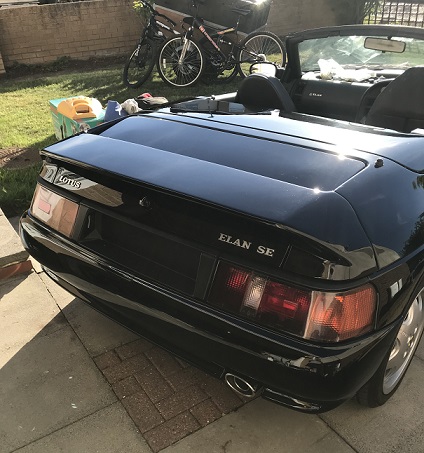

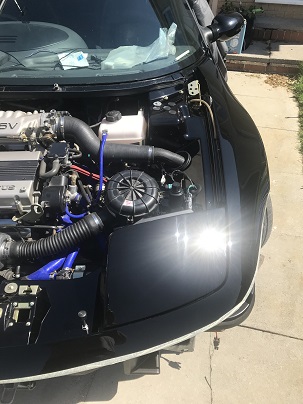

I am pleased with the finished result having fitted and adjusted the headlamp pods.

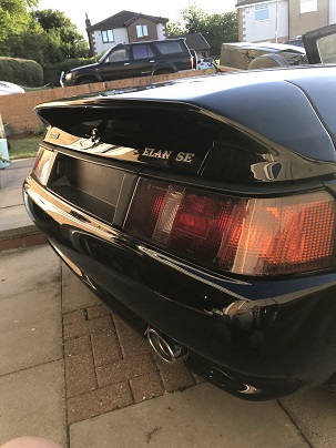

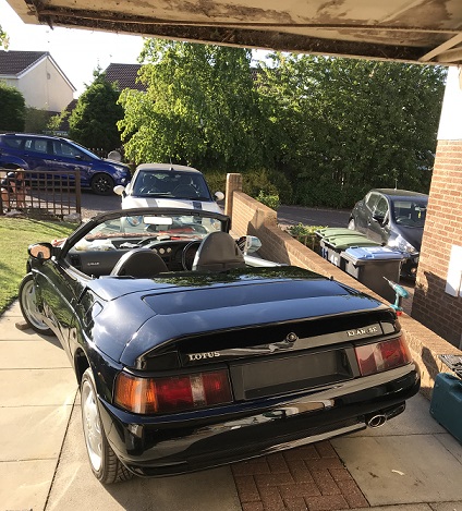

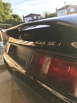

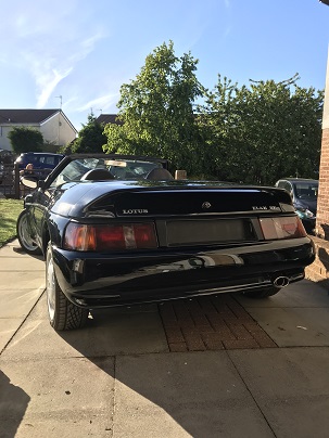

I am awaiting a few parts to complete the front so I moved to the rear of the car and fitted the badges. It’s really starting to look like a new car

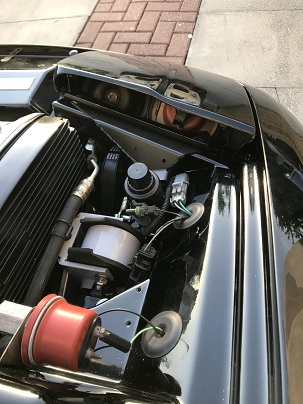

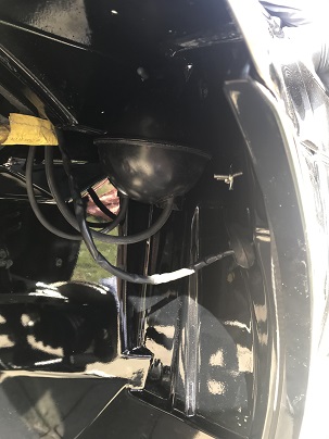

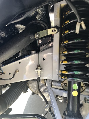

Here is a quiz to test Elan anatomy skills. Which area is this a photo of?
Mike Y
Posts: 754
Joined: Fri 16.05.2003, 17:32
Re: Black S.E. Re-Shell & Chassis Continued...
Postby GeoffSmith » Mon 08.06.2020, 21:44
Vacuum reservoir - rear of nearside wing.
Postby Mike Y » Mon 08.06.2020, 22:37
:clap: A bottle of Scotlands finest on the way to you :cheers: ooops sorry I drank that after struggling to get the panel gaps right on the clam :lol: :lol:

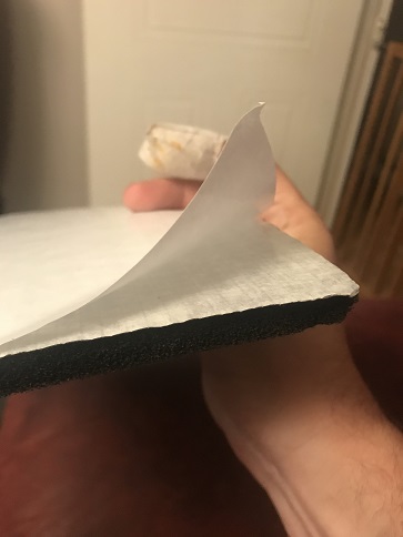

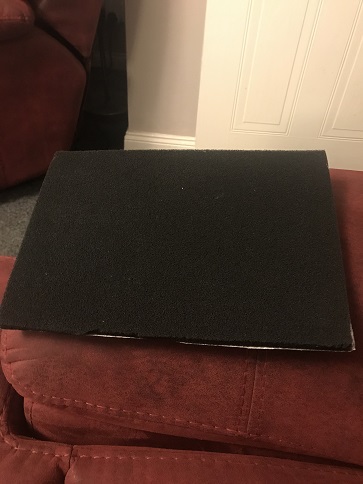

Well haven't touched JUFs for a while however I have just received a parts delivery from SJ and also I have have sourced some original spec under bonnet sound deadening.
The company dont normally produce it the way it is on the Elan but will do specials for Elan owners. It is 12 mm thick O class foam with foil backing and importantly they will put the self adhesive on the foil for Elan owners and have produced a specific product code for Elans you do have to cut it to shape yourself but their min order quality means you have loads spare to practice on possibly enough to do 2 bonnets. I have listed their details below.
The company is called:-
A.G.S Acoustic Materials Ltd in Leicestershire Call Richard he was extremely helpful. tel 01664 411770
The product code is N12/SA/FF/AG-LAM. :D
