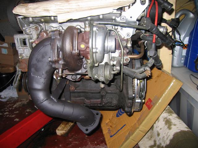

The stiffy fitted and waiting for action!
Fitted
IMG_1235 (Small).JPG (64.05 KiB) Viewed 182854 times

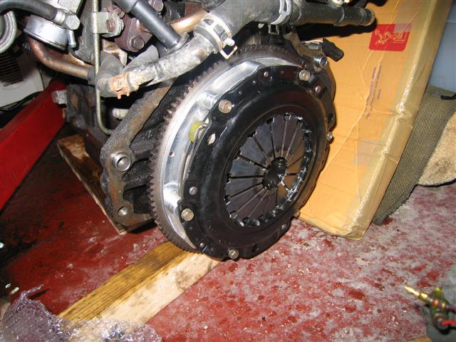

Postby Dico » Sun 02.04.2006, 17:07
Assco lightened flywheel and uprated clutch/pressure plate-
IMG_1233 (Small).JPG (71.64 KiB) Viewed 182853 times
Postby Doug » Sun 02.04.2006, 17:12
thanks for the pix, Dico--looks good!

Postby Guest » Sun 02.04.2006, 23:40
Are you sure it is a good idea to use Stainless hardware for a turbo? I don't think I would personally; I only use Grade 10 hardened. Or are these some special variety?

Postby Doug » Mon 03.04.2006, 06:37
be sure to incorporate some small length of flexi-pipe after the downpipe area to keep the engine and stiffy movement from causing failure of welds on the stiffy or other parts of the exhaust!!
Postby Dico » Mon 03.04.2006, 06:44
Anyone else agree with the 'mystery man' ?
I know some other chap did it on here, just figured it would be ok. Even the original studs (granted they were 14 years old) snapped when i removed them. (well most of them)
Yeah, cheers Doug. I was hoping i could wait until the Elan fund rises a little as its curently at minus :shock: Bit risky to wait though? Lets see if Peco man comes up with an iresistable offer? Shant hold my breath :D
Postby Paul.P » Mon 03.04.2006, 08:20
Paul, might be worth looking into ( stainless steel bolts ), i know they normally don't have the strength that ordinary steel does, but they do make extra strong s/s bolts now, but they come at a premium. Unless youv'e got the strong ones, i would be very cautious about them, don't want them to snap when engines back in, that would be a real pain !
Postby Dico » Mon 03.04.2006, 12:36
Project Dico, two steps back :? :(
I'll start looking for high tensile studs.

Postby Paul.P » Mon 03.04.2006, 12:40
To be honest with you mate, i wouldn't worry about s/s bolts on your turbo, can't really see them anyway. I would just get some new studs from lotus agent. Now, you can wait 2 wks from SJ's or ring you know who ?
Postby Dico » Mon 03.04.2006, 12:50
Paul.P wrote:To be honest with you mate, i wouldn't worry about s/s bolts on your turbo, can't really see them anyway. I would just get some new studs from lotus agent. Now, you can wait 2 wks from SJ's or ring you know who ?
The only reason i fitted them were-
1) they dont rust, making for easier removal ? :? )
2) they were all i had in the garage :D
Wasnt really bothered about the cosmetic side of things. Monty seems to think lotus dont have them listed? I havent looked myself. Might nip to kwikfit if i can find a salvageable sample stud.
Thanks for the comments chaps.

Postby nitroman » Tue 04.04.2006, 07:07
ARP SS studs & bolts have a tensile strength of 180,000psi, about 15% stronger than grade 8 steel. They do cost a premium over common A2 stainless fasteners though.
I will use them in any position which can be seen while doing my "ground-up" exhaust & turbo upgrade/rebuild. Not only are they pretty but hand-polishing is the cheapest part of their purchase! They'll both look great and come off like butter in 5-years with no maintenance inbetween.

Postby Ashaman » Sun 09.04.2006, 03:20
Sorry Dico, it was me. I guess "Guest" posting is enabled now? Anyway, I keep posting without realizing I am no longer logged in...
Yeah, I checked into it a few back when I was installing my turbo for the same reasons you mentioned. I found that they were relatively weak and was advised not to use them. Expansion rates are very close to cast iron, but the strength isn't up to the task.
Also, when they do twist off, you will have a miserable time trying to drill them back out. They tend to gall up; it isn't pleasant.
But as Nitroman pointed out, I have heard of specialty fasteners that are supposed to be very strong, that is why I was asking if these were something special or just hardware-store variety. I have never used them, but imagine they would be great for this app? :smt102
