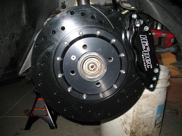

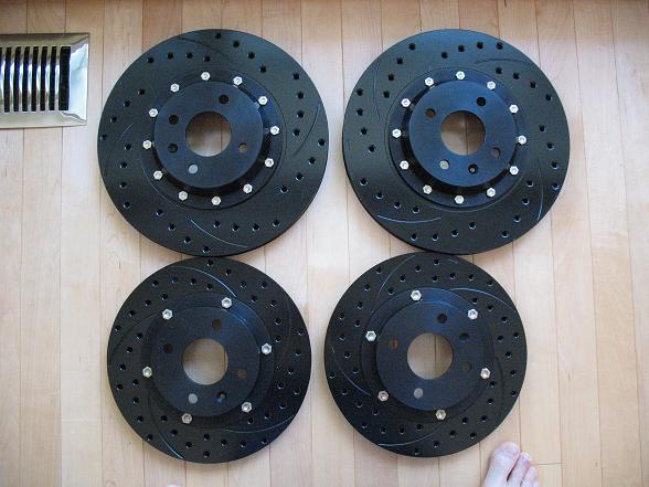

Much like the thread I started tracking a series of projects for my "Interior Makeover" plans I thought I'd do the same for my "Exterior Makeover" progress. I plan on (hopefully) a few changes to some of the bodywork, brakes, etc. I won't include any engine work in this thread - hard to see that unless the hood/bonnet is open. But, anything visible from the outside of the car will be included. I've already done a few things, and I won't repost them here, but you can see the details surrounding the LGM rollbar, LED tail and turn lights and 17" wheels by following those links. What I am going start this thread with is the new brake kit Bob has provided for me.
It includes custom hats and mounting brackets, HiSpec front and rear calipers and Wilwood rotors. Its similar to the kits Bob has designed for general use but I asked him to do something for me that would support a slightly larger rotor to fill in the 17" wheels I've installed. With all the parts and fasteners inhouse I bolted up the hats and rotors this moring as the pic below will show.
I decided to go with a recently new addition to the Wilwood line of rotors - black coated rotors. Same antirust protection as the zinc oxide washed ones but, with the black anodized hats I requested I thought they'd look pretty cool. Especially after I bed them in and the swept part of the rotor goes silver while the rest stays black. I take some shots of them after I get all the parts installed and run them in. I'm hopeful to get a fair bit of this work done this weekend but likely not all.

I see a great (or medial) phalange or simply, a hallux. The hallux & thumb are our only phalanges with just two bones, instead of three bones as found in all their lateral breatheren. You Brits and your odd twists of phrase!
BTW I love those black rotors; would have saved me a lot of masking/painting if they'd been available sooner!

Postby CJ101KT » Mon 09.11.2009, 18:01
They look lush. The discs I had with my 16" kit Brian didn't have the disc hat as its known? Are the discs and hats available to purchase from Wilwood as an oppose to discs that don't have them and therefore look a bit more ugly?

Re: Exterior Makeover
Postby bobbrown » Mon 09.11.2009, 18:06
I made up the hat/bells for this conversion and if any one wants any to fit any disc to an Elan I am happy to make them up for a fee, just send me an email

Postby Elanlover » Wed 11.11.2009, 02:07
Making some progress now. Just need to check the hoses aren't rubbing, bleed (and bleed again most likely, put the wheels back on and then on to the rears. :D

Postby Elanlover » Sat 14.11.2009, 17:04
Ok, front brakes "mostly" bled :roll: . Wheels on and they clear the wheel spokes nicely as well as the stems (well done Bob). Looks like a stealth brake system with the black rotors, hats and calipers. :-D Should look interesting after I bed the pads and the black is swept away except in the grooves and near the hub.

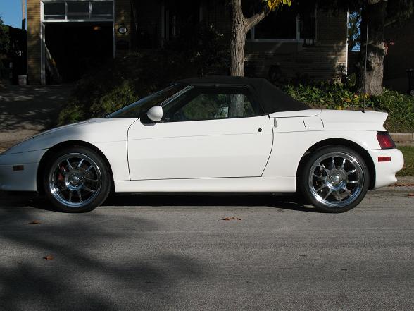

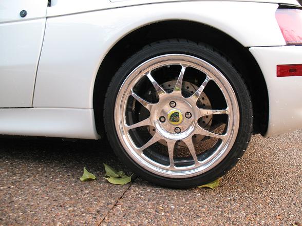

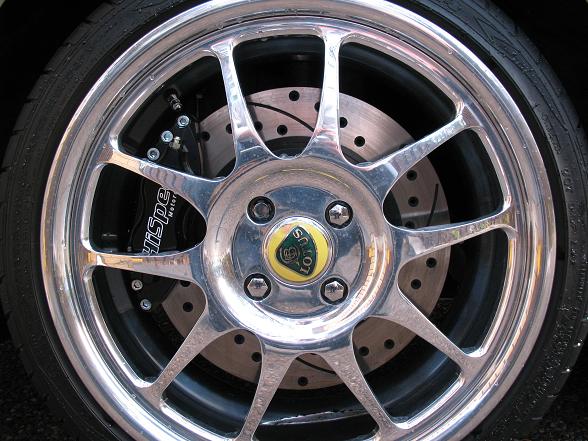

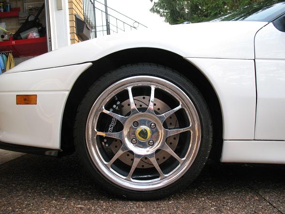

Ok, brakes are on and pads bedded. Still having fits with bleeding the brakes :roll: but we'll get there. Here's soem pics with the wheels on the the black electroplating scrubbed off where the pads make contact.
Postby bobbrown » Mon 23.11.2009, 00:40
looking good, did you leave the bleed nipple dust caps off on purpose?
The fronts fill the wheels well and the rears do not look bad either.

Postby Elanlover » Mon 23.11.2009, 03:54
bobbrown wrote:looking good, did you leave the bleed nipple dust caps off on purpose?
Bob
Yes, the wheels are coming off again for some more bleeding............... :roll:

Postby Monty » Mon 23.11.2009, 11:40
Blair,
Brakes and wheels are looking superb :smt023 and with the redisgned dash got to be one of the best looking elans going :-D

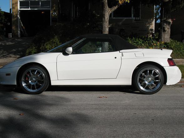

Postby Elanlover » Sat 05.12.2009, 19:07
Ok, here's one little project I'm hoping to complete over the winter. Its a remodelling of the rear of the car to include the installation of Kia rear light clusters, a new, LGM custom valence to fit between them and the redesign of the rear bumper includign a centered exhaust outlet. As I go through designing what the rear will look like I'd like to post some mockups and would appreciate feedback.
The first of these design ideas is the rear bumper viewed from the side. I will eliminate the stock rear, side reflector/marker and find something else to replace it with to ensure the car meets all the required DOT regulations. Its gone from these pics (except the stock pic) but what's chnaged is the profile of the rear bumper from the side. I'd be interested in people's opinions and suggestions.
Postby lotos » Sat 05.12.2009, 20:04
I don't mind any but the bottom one which looks a bit too American (read: LARD ASS)
Postby Nige » Sat 05.12.2009, 22:08
I prefer the original (less the reflector), of the options the first one looks best to me.
Postby DaveB » Sat 05.12.2009, 22:13
Yep...
...number one or two gets my vote... no bigger!
Postby Denny » Sun 06.12.2009, 14:33
Number 1 for me.
