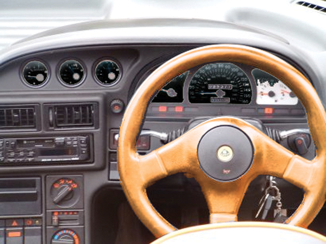

First, the original seller photos. I bought it exceedingly reasonably from ebay although it cost me £160 for flights, about £40 for associated transport and £70 in petrol to get it back to Edinburgh. I need to remember this is part of the value.
First, the initial photos I received from the seller:
Screen shot 2012-06-28 at 17.28.43.png (120.82 KiB) Viewed 33676 times
Screen shot 2012-06-28 at 17.29.03.png (115.9 KiB) Viewed 33676 times
Screen shot 2012-06-28 at 17.28.50.png (109.95 KiB) Viewed 33676 times

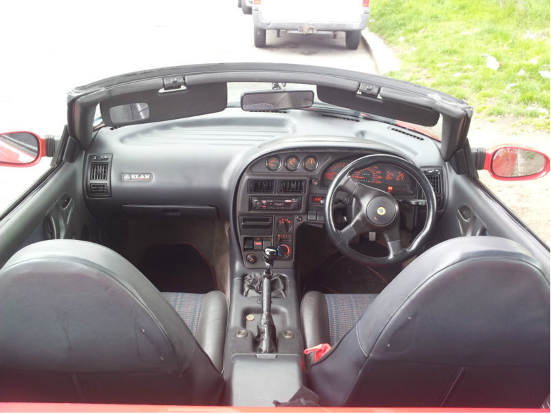

At this stage I took some other photos of the interior just to have a record. The carpets are OK but you can see some slight rust spots behind the passenger seat. I removed the speaker cover which was totally loose.
Photo of interior showing good clean paint under the speaker too, but some rust spots behind the seat.
Another photo of interior. You can see the inner portion of the dash fascia is protruding and not fitted very well, but the leather/vinyl trim is very good for the age.
Detail of the area behind the passenger seat. Whats the silver box beside the speaker?

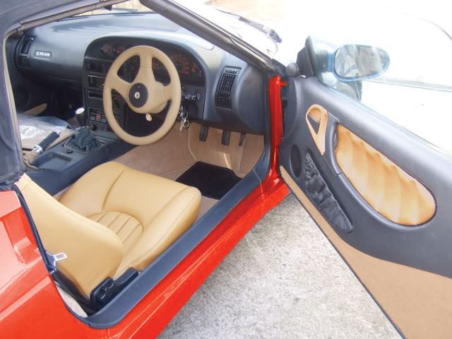

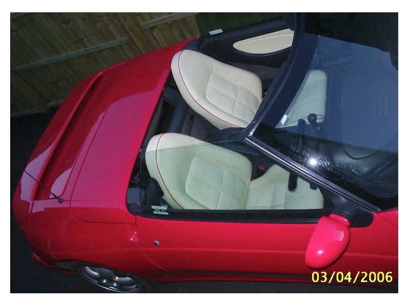

Wouldn't worry about cream seats with a red car, that's the choice of 95% of Ferrari buyers in the 80s and 90s. Think it will look really good

Its cream seats with a black dash that worries me. I was going to go cream seats and tan dash but if its worth doing, its worth doing in leather and thats expensive.

nyssa7 wrote:Wouldn't worry about cream seats with a red car, that's the choice of 95% of Ferrari buyers in the 80s and 90s.
So what?
Just because Ferrari have done it, you don't have to like it. I don't.
I still believe that cream leather looks nice when it is fresh but scruffy once it starts to wear when black dirt fills the creases.
Out of the 2 choices you've made, I would definitely go for red & black leather, but I don't like the SE's stripe style. Something more like what Martin Bailey & Dapinky have: black around the outside with a red centre section. Looks a little bright at first but great once you get used to it.

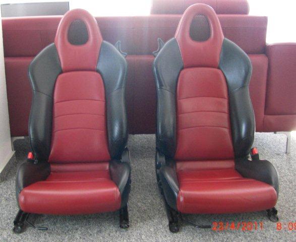

I went for the Honda seats in Red/Black and am very happy with them. Might be a little too much red, but at the end of the day, you have to go for what suits you.

I like the red and black Honda seats they look very supportive

Honda seats are very comfy, the only problem with them, red and black are the most expensive

They do look comfy, and I had a bid on the ones that just went on ebay for over £500. Thats really too much I think.

you need to be aware that some seats are too wide not just the part you park your bum on but also at the shoulders and there can be other issues when fitting aftermarket seats.
Not sure if these would fit Linkbut as they were out of a classic Mini they might but I'm not saying they will you'll need to check the dimensions.

The main problem with aftermarket seats is to ensure that they are narrow enough to fit in the elan - many of them are too wide (at either the base or the shoulder) to fit.

Honda seats are really good but they are a little too wide to fit inside the B pillar which means you loose several inches of adjustment.

I really like the shape of the original seats. The Honda seats are also beautiful, but I don't want all-black or too much of a red and black interior. Seems like this is going to be the way for me.

I wanted a cream interior as its luxurious and interesting. But done wrong, it can look wan and washed out.
When I found this picture of Lotus seats like mine with red piping, I knew it was going to be wrong. This is
exactly what I pictured, but it doesn’t look right. With my wife’s keen eye to help, I set to work it out properly.
Example of the cream leather with red piping I'd originally envisaged.

It suits grey (which some of the dash will have faded to), black (like the dash is meant to be), but does it go with red? It must do, its a Ferrari.....time to find an Elan interior pic to play with.
While looking I found all the usual red & black ones, confirming too much red and black is a bit Eddie Murphy for me.
So I ended up hacking together some pics, one is Zaria's, one I don't know, and got to my final colour scheme.
Caramel colour seats, escutcheons, card inserts, steering wheel, and champagne or slightly darker carpet. Keep the black centre console, and black gaiters; perhaps recover and pad the console. Black metal monkey dials with aqua lighting.
The seat is the closest to the colour I want. I'll get leather samples sent to check it out properly.
Wheel is too wooden looking, it will be the same caramel/tan colour
