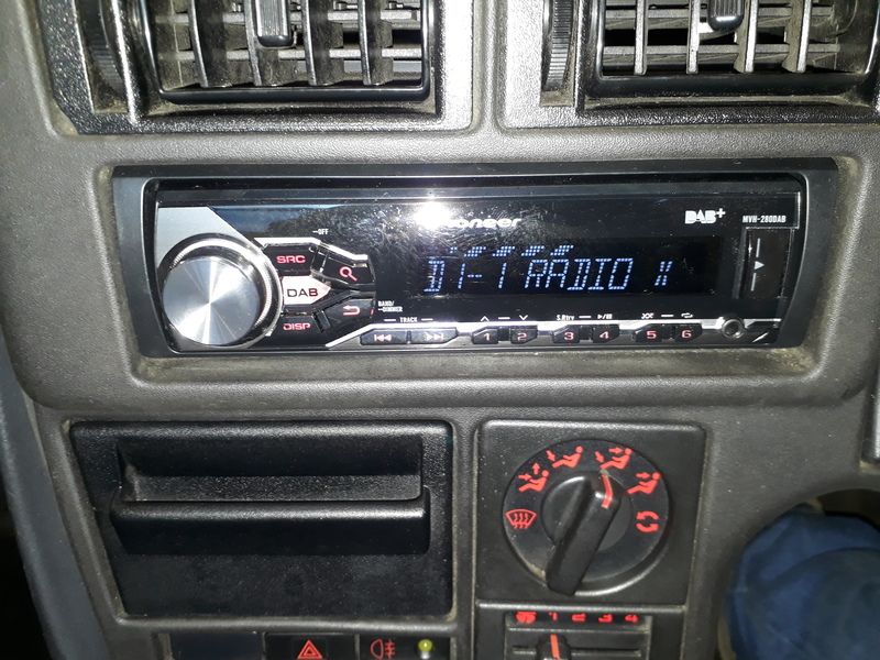

Postby par » Wed 24.05.2017, 22:58
Nothing major to add as I intend to keep the car on the road as much as possible during the drier months.
I have tried to keep to the spirit of Lotus and add some lightness by ditching the grossly heavy CD player stereo and replaced it with a far lighter USB/Ipod Stereo complete with DAB, I think I can feel the difference from a standing start :wink: I also took the opportunity to take a feed from the clock so the stereo now only comes on with the ignition rather than being permanently live.
Unfortunately I had to add some additional weight back on by fitting a DAB aerial, not as neat as it could have been as I hadnt noticed I had cut my hand on the stereo cage and managed to trap some of my DNA between the film and the windscreen :roll:
Digital reception has been very good to date.
