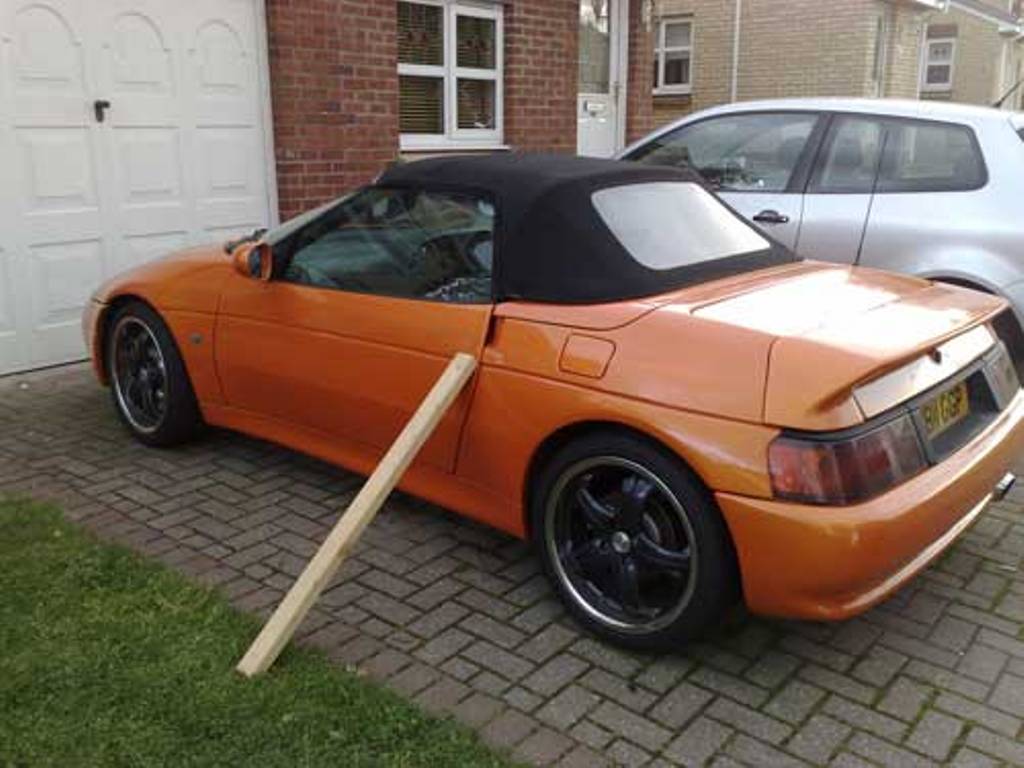

You might like to know that in its afterlife "Missy" affectionately became known as "Tango" to some and "Carrot" to others
I must say that the car looked absolutely stunning in Tango orange when Stevo had sprayed it. A bit of orange peel after all these years is quite appropriate :lol:
