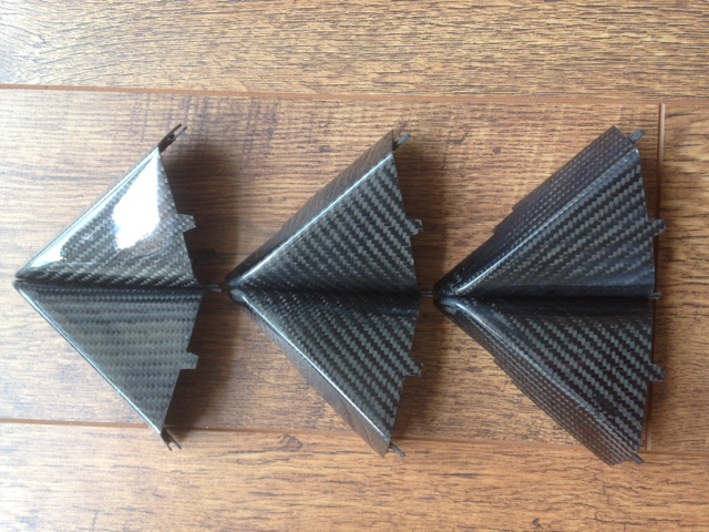

So another little update and this is just because they look better that the originals (not weight saving) I have made up some cheater panels that cover the door mirror wiring. they seem to sit quite well in place even without the usual double sided velcro fixing

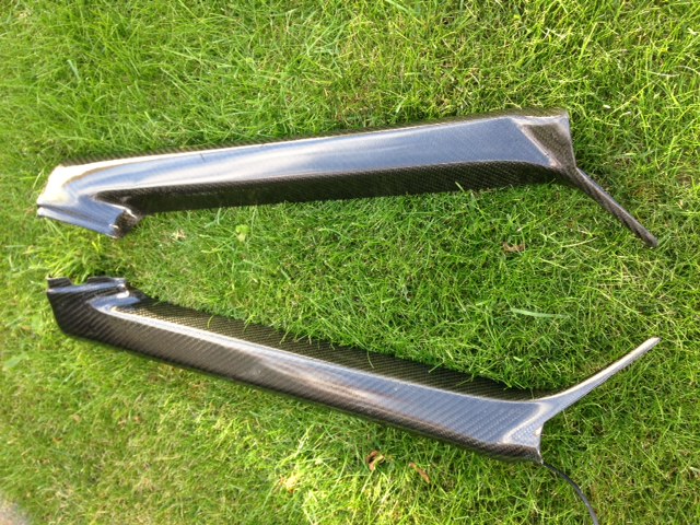

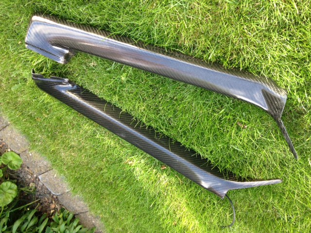

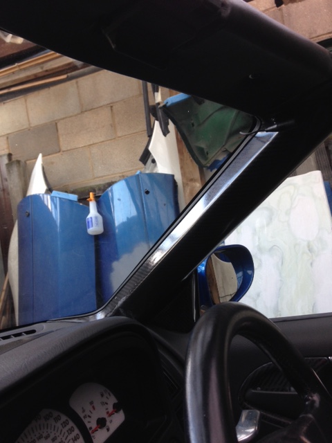

So I have been busy making A pillar covers - I saw them on a Mclaren P1 and thought they looked good. So copied the originals but rather than having the horrible self tappers holding them on at the header rail, I added some extra material so that they tuck under the header trim - seems to work. I also fund some rubber trim that goes round the edge and gives them the professional look.
It is hard to take a picture of them in situ because of the lighting.
If there is any interest, then I can make to order.

Postby chrisP » Tue 13.06.2017, 11:34
Hi Steve, I can make you a pair if you would like. price is £180 for the pair, let me know if you are interested and I will get some better pictures of them installed at the weekend.
Hi Steven, sorry I have been concentrating on getting the Elan back on the road - I just went back through the thread and saw your message. I can certainly make you a pair of of the A panels for the outside - it will take me a few weeks to do for you. they would be £200 for the pair and I can take some better photos at the weekend as well.
Both parts are resin infusion made with a several layer of carbon each side of a core to increase the stiffness - they are then lacquered for UV protection.
Best Regards
Chris

Hi Don.Hasi.
I don't have any of the panels made at the moment but I can make a pair the first weekend of July, They are £55 if you are interested. You would need to transfer the rubber seal from the old cheater to the new one.
